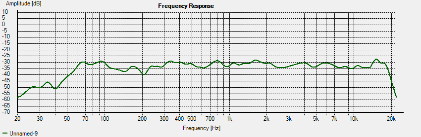

Anyway, here's the response that I ended up with an afternoon's work. I only listened to it in mono, so can't say anything definitive, but it didn't sound half bad. Smoothing is 1/6th octave, and it's measured in my living room, so take it with a pinch of salt. I can't measure outdoors like saurama, too much ambient noise here.
That area from 680 to 2.3 kHz needs to be flattened first by about 3 db.
Then listen to it and see if the result is more pleasing (..and do so from different angles).
(..I'm discounting the freq. response below 300 Hz.)
..btw, the measured results of the speaker(s) that saurama produced were pretty close to B&C's - which is nice!

3dB sounds like a lot, but you might be right. Still, I'll first give it a thorough listening like this, but in stereo. And that'll be tomorrow, since I've made a deal with my neighbor that no music after 9pm. We share a common wall, and the bass goes through it like nothing.

Alfred, your plot is too low resolution in the vertical, very hard to judge any speaker from such a plot.
So, get to a 1 or 2 dB grid.
Then a good way to proceed as a first step is to lower the horizontal resolution (as much smoothing as your program gives you, 1/1 for Arta is good for this purpose). This measurement will give you a good sense of the relative energy going to the different drivers and will allow you to get the alignment roughly right.
Then go to less and less smoothening and solve problems as you encounter them, step by step, increasing the resolution until you are at wits end.

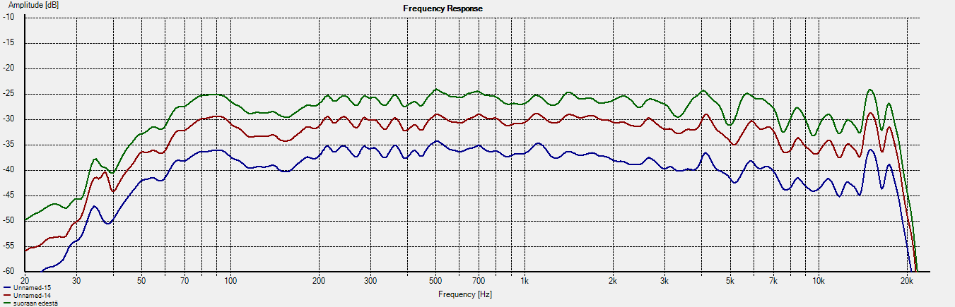

Oops. Just noticed something today. Since I got a new laptop a few months ago, my previous measurements lacked the microphone calibration file... So that previous plot can be disregarded.
But some new ones I have, and this time with the calibration file. The green plot is what I ended up last thursday. It still sounded a little "grainy" in the treble, and something I felt was missing.
The red plot is probably the best I could come up with today, but I felt it sounded a little too bright on some records. Then again with Infected Mushroom's BP Empire it was even maybe a tad too polite.
The blue one is basically the same crossover as the red, but with a couple dB more padding for the HF driver. It doesn't sound as bad as it looks. Not yet sure, and listening for today is over, since it's over 9pm.
The Red looks good, but you need to drop the level between 900 Hz and 2.8 kHz down to the level at 900 Hz. The upper freq. response beyond that should be pretty much the way it is (..even if the peak at 4.2 kHz is a bit troubling). Frankly though, I'd be looking to drop the range on a broader scale down to 450 Hz as well (..the upper midrange, at least as represented in the freq. plot, is still to "prominent").
