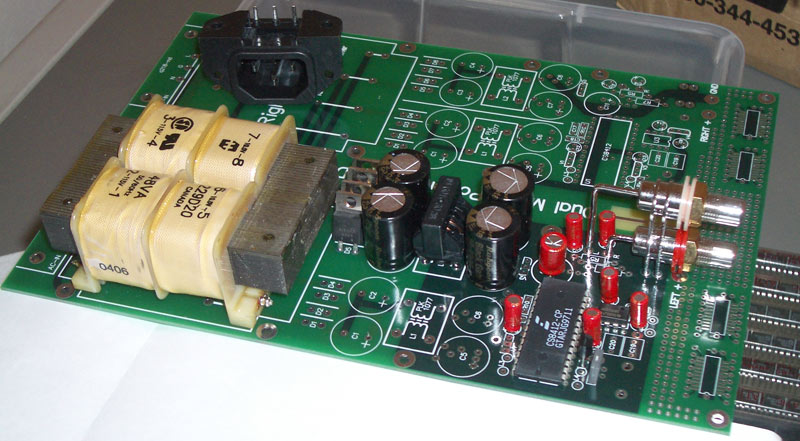

first pair of prototype boards arrived today :)

Not sure that I agree.
It just looks as if BrianGT has two boards next to each other - otherwise they look quite alike.
BrianGT - Why have you got two boards together like that ? is it to do with costs ?
Peter - how come you manage to post full size pictures ?

Mike,
They were put on a single pcb to save costs. The pcb will be cut apart to create 2 seperate boards. These are prototype boards with 2 different grounding topologies. I will make another 2 boards after Peter and I see how these work.
As for the picture posting, if you load the picture on a website outside the forum, you can post a direct IMG link, which will cause it to appear on the site. It looks like Peter is using some polish site for hosting that image.
/brian

Brian, nice pcb. But I would mainly be interested in the part where the PSU is located... and leave the rest for 3D p-to-p. Perhaps two separate boards, to leave the p-to-p option open. The two could be stacked in order to save space.

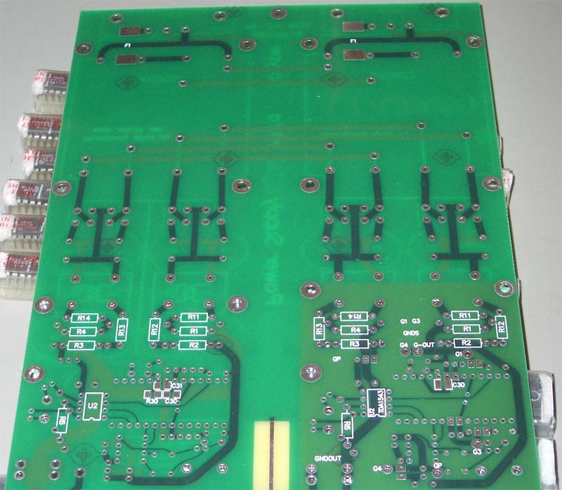

Cut apart???
"They were put on a single pcb to save costs. The pcb will be cut apart to create 2 seperate boards. These are prototype boards with 2 different grounding topologies. I will make another 2 boards after Peter and I see how these work."
Looking at top view of pcb, me thinks that this is indeed a "double mono pcb" with right channel on one side, and left channel on another. The (partially obscured) printing on the pcb would indicate just that...
Bottom view however does show different ground routes.

The whole dual mono text and a few random traces are just an attempt at making the design look like one board, so that when I get the prototype pcbs made, I don't get charged an extra tooling fee for having 2 designs on one pcb (actually 4 designs if you count the prototyping adapters on the front of the pcb.
The board is mailed up to Peter for testing. I will make my own pcb once he provides me feedback on the design.

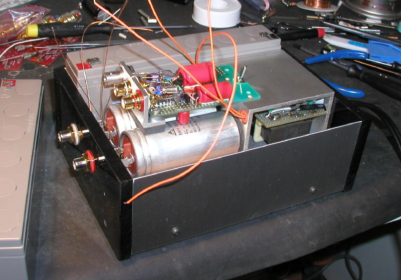

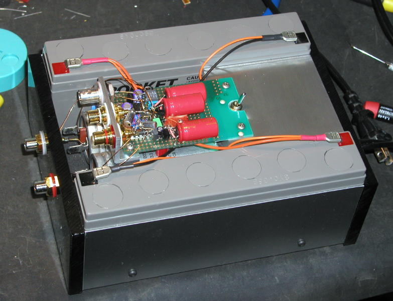

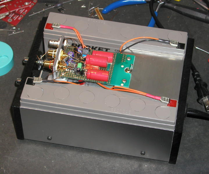

Here's my latest implementation of 3D TDA1543 DAC. The following changes has been done with regards to a previous version:
I'm using now 2 smaller 12V YUASA cells. They are somewhat cleaner sounding than Panasonics, with better vocal presence. There isn't ANY ceramic bypasses anymore, and not any small bypasses before regulators.
I'm using 47/50 BG N after each battery and on the DAC chip. I found that this cap sounds much better than 100/16 BG N I was using previously (also for battery bypass this seems like a best choice).
I tried briefly Scientific Conversion input transformer, and although fine sounding, it possesed slight coloration I couldn't get used to. Presently, I'm using Neutrik BNC, 75 Caddock after (best choice resistor type, IMO) and 2 Vishay/ERO coupling caps. Those caps are very neutral and transparent in this application (my thanks to Klaus for raving so much about them ;)).
Still, the same input driver, but with 15/20 OsCon for bypass. There is also ferrite bead before regulator here and one more OsCon. This was the only area in a circuit that I actually preferred OsCons.
The receiver has BG 10/50 N type for bypasses and anoter ferrite bead before digital section regulator. The ferrite bead does not sound good on analog side.
PLL filter consists of 0.47 BG NX and 400R Caddock and additionally 3n3 Wima cap. I also tried 4.7 BG N and 100R resistor but this created too much emphasis on the midrange and I regard the other choice as overall better tonal balance.
I'm still using RIkens for I/V but will try Caddocks TF020 soon. I had BG N 4.7 caps for coupling initially, and they worked great, but after switching to Siemens MKV 3u3, there is no coming back. They just provide another level of refinement with better resolution and bass definition.
That's about all for that version. I've been working on that DAC for almost a year, and I don't think anything can be improved much. I'm positively sure that PASSIVE I/V IS better to active and reclocking is not needed. Batteries bring another level of performance and ARE better than AC power (more clarity)
This DAC is also better at the moment as the parallel TDA1541S2 DAC that I tweaked recently. But I believe if similar approach is taken to pushing the envelope of TDA1541 DAC, much more improvement is still expected and maybe even a superior performance;)
So I decided to make a permanenet DAC enclosure, implementing open chassis (design) as well as battery power, with a built in charger and vibration free structure.
The charger (one per battery), is based on two LM317 regulators, 12VA transformer and it's placed in 3 x 2 tubing at the back of a chassis.
The base is made of 3/4 maple board, two thin aluminum angles make the sides, and two more acrylic panels create front and a back.

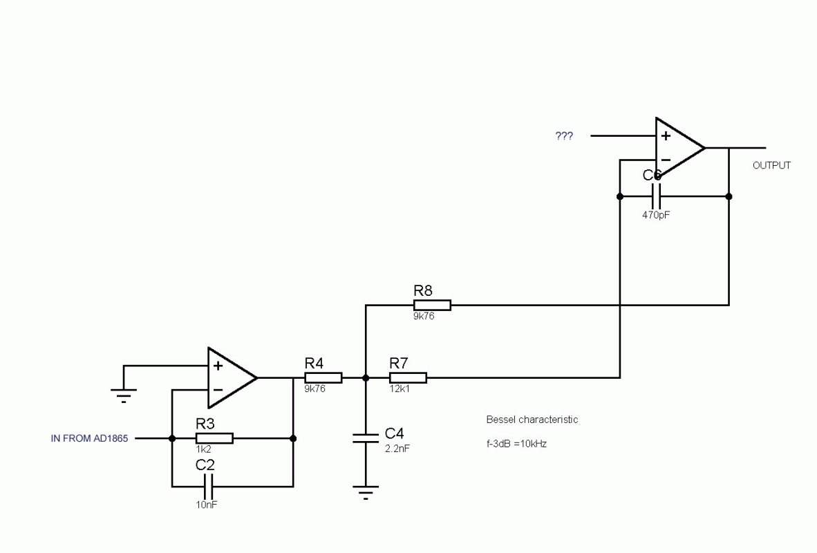

Hi, It is funny to see how Peter and I have gone in totally different directions starting with the same DAC (TDA1543). I am using active IV-conversion with OPA627BP, discrete outputbuffer, opamp regulated analog powersupply and a huge 100Watt(!) transformer.
Peter what are those Siemens MKVs for?
Did you post the schematic anywhere or is it "personal"? I'd like to switch my TDA1543 DAC to active I/V...
Re: Re: The ultimate TDA1543 DAC layout??
Hi UrSv,
Only the discrete outputbuffer is "personal" though I think the correct English term is proprietary. The buffer is similar though to Sonnya's one here:
http://www.diyaudio.com/forums/showthread.php?s=&threadid=1794&highlight=sonnya+cascode
In the past I posted a regulated supply with a triple Darlington for the TDA1543, the opamp regulated analog supply, and the IV and outputbuffer/ low-pass filter general schematic. Also I posted the DIR with the AD8561 in front, Wildmonkeysects’ loop-filter.
In the picture ??= ground.
The non-inverting input of the first opamp is connected to Vref of the DAC with 3k3 to ground . R3 = 3k65 and C2= 3n3 with IN from the TDA1543. First opamp OPA627BP, second opamp the discrete. Not shown 0.47µF Audionote PIO copper foil output caps.
