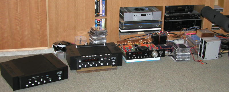

In order to have some reference, I got hold of ML31.5 Reference transport and ML35 DAC. The transport is from 1996, the DAC is dated 1992. It's using CS8412 receiver, PMD100 HDCD filter and Ultra-Analog dual DACs with discreet output stage.
I was pretty much impressed by the transport, as it seems to be another level above my CD-Pro implementation. The bass notes are better defined, rock solid, with more control and overall it provides more musicality.
I was not impressed by the DAC initially, but later I used better support (dedicated platform) and warming up helped definitely. I got better results using Tosling than RCA connection (and I expect balanced line to be even better).
I spent whole afternoon yesterday comparing ML DAC and my battery operated NOS implementation od TDA1543.
I was using ML380S for switching and both DACs were connected to the preamp using Kimber Silver Streak cable. For amp connection, I used an interconnect sent to me by Steve Eddy, and it appears to be very good (and I prefer it now to Silver Streak).
My DAC is using passive output, with Riken resistors.
The was basically no difference in volume level between two DACS.
I was pretty much surprised with the outcome. The bass on TDA DAC was actually better, deeper with more punch. Overall tonality was very close. ML DAC seemed to have a bit etched highs, with more analytical signature, but overall it was very listenable, but I preferred it only on some selected material.
The non oversampling TDA wasn't at all any inferior to ML dac. It had it's own character, which could be characterised by more smoothness and more analog sound. It also seemed to be a bit more natural. It was actually better on more complex recordings (I preferred ML dac on some simple, female vocal recordings, where not too many instruments were involved).
I could sense that the small DAC could be improved by using better coupling caps (I had BG N 4.7u) as clarity wasn't the best (comparing to ML DAC) and could be definitely improved.
All in all, I had pretty hard time picking the better DAC, but eventually decided on nos TDA1543. It sounded less digital and was more forgiving to less properly recorded material.
Of course both DACs could be still improved: ML could be tweaked and better passive parts installed (sa well as FIFO buffer as seen on later designs), TDA1543 is still not finalized, as I'm still experimenting here.
However since it was my first time listening to actually good oversampling DAC, I now believe that oversampling can bring great results when properly implemented.
I was also nicely surprsed that those two DACs were not that far apart sonically

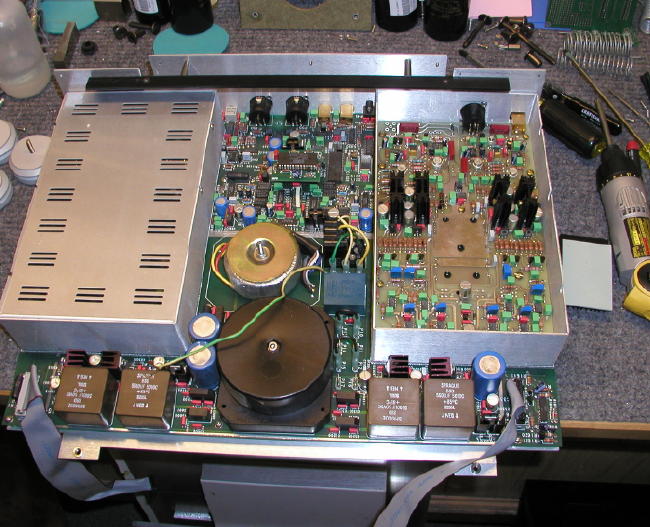

Here's the inside pic of ML dac.

you picked a pretty high-caliber OS DAC to compare with your project! With ML DAC, I was impressed by pinpoint, spatial presentation, and clarity of mids.
"I was pretty much surprised with the outcome. The bass on TDA DAC was actually better, deeper with more punch."
I also noticed precisely this superiority of 3D NOS TDA 1543 to other DACS (Theta, Parasound, CEC) besides ML.
"I could sense that the small DAC could be improved by using better coupling caps (I had BG N 4.7u) as clarity wasn't the best (comparing to ML DAC) and could be definitely improved."
Lots of factors could contribute to a lack of clarity, but : What coupling caps are more desirable for the NOS 1543 DAC in your opinion?
"Of course both DACs could be still improved: ML could be tweaked and better passive parts installed (sa well as FIFO buffer as seen on later designs)"
Agreed, overall, the passive parts in most ML equipment are not that impressive.
