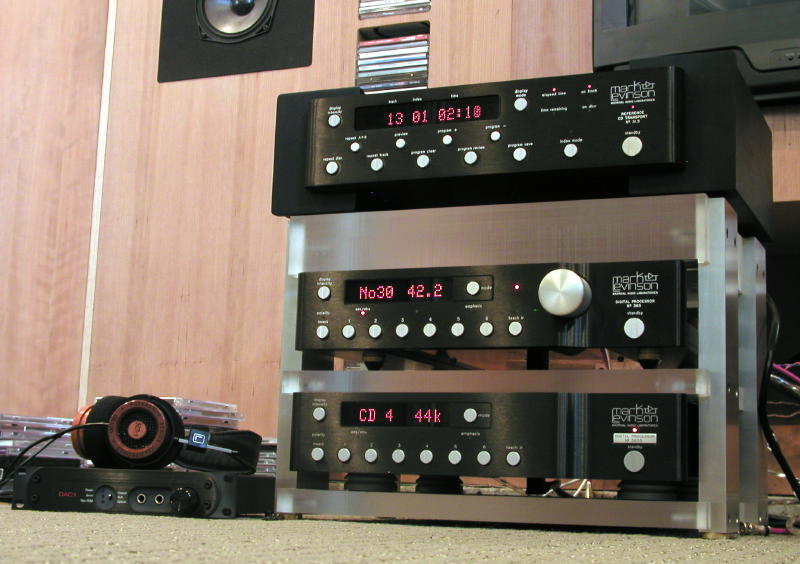

metalman said:Balanced input was another story, where it kept the clarity but added more body to the presentation. The one advantage of the GCSS, independant of input configuration, is that the sound of the amp seems less dependant on the power supply configuration, probably primarily due to the cancellation effect of the balanced topology. To the GCSS the difference between capacitance only, regulated, capacitance snubbered, and regulated snubbered was a lot less noticeable, whereas with the basic GC I could hear distinctive differences. I keep hoping that Peter Daniel or Carlosfm might take a wander into GCSS land so I could find out their opinions, but no luck so far (hint, hint).
I'm presently using a bridged version of LM4780 with (only) a balanced input. After trying that, I don't think I will go back to single ended LM3875 (unless I try it in bridged version).
As you noted, a bridged version seems to give more body to the presentation without loosing any clarity. Also spaciousness and dynamics increase.
Just today, I replaced ML380S preamp with S&B102 line stage in a completely balanced configuration and I really like what I hear now. There is a certain coherence and ease of presentation I didn't experience in a long while. I will be soon trying a new silver version.
But this was only possible with a new DAC I got yesterday (that has low impedance balance outputs).
I tried similar configuration with TDA1543 passive stage and S&B102 used as single ended to balanced converter didn't work well at all. Using it in fully balanced setup is another story.
As to the SuSy, this would require another active stage in front of the amp, and I'm not sure if the trade off is worth that. But considering the simplicity of such circuit, I might try it one day
IMO, the future of GCloning is in fully balanced topologies.
Care to share which DAC it is and how it compares to your TDA1543?Originally posted by Peter Daniel
Yes! We seem to have the same opinions exactly on the sound of the bridged topology.Originally posted by Peter Daniel
Peter Daniel said:I tried similar configuration with TDA1543 passive stage and S&B102 used as single ended to balanced converter didn't work well at all. Using it in fully balanced setup is another story.
Passive stage... sure.
The source is the most important component on any system.
It makes everything after it sound good or bad, it rules.
Single-ended or balanced, the difference is not night and day, if well done.
You can't compare amps when you also change the source component.
