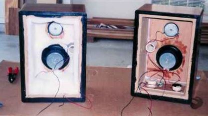

If you're building a normal BR or ported box, then lining the walls with foam is the accepted practice and quite adequate. But I design and build TLs, sometimes long and tapered with a terminus where the line's 1/4-wavelength frequency is the sole tuning mechanism, or sometimes shorter with constant area lines whose natural 1/4-wavelength resonant frequency isn't low enough and needs a mass-loading port to complete the tuning.

hi, I can confirm that stuffing the cabinet will increase the sound quality tremendously.
why I say so ? because I'm just tunning 1 pair of cheap Chinese surround speaker with no brand and absolutely no drive info to excess. however the tuning work so well until I'm quite sick to find out that a lot of song in my music library sound so bad until I wanted to stop tuning it further.
my set it up as the b&w subwoofer, I use those black insulation pad in the wall and polyfill just to fill up the space.

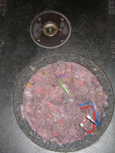

Was it Dickason's Cookbook that went into the thermodynamic effects of fiberglass insulation in a speaker cabinet? Seems like polyfill wasn't the preferred material, something about the glass fibers converting motion to heat better.
Been too long, I just barely recall the highlights. And that might have been for cabinet lining, not fill, but it seems like if one fiber was better, it'd be better in both instances.
Fiberglass and polyester fibers work the same way and have the same type of effect, differing only in the the densities required, less with the fiberglass (about 70% of that from polyester). Again, I'm talking only about TLs.
