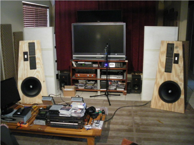

Nice speakers!

As the part of this conversation about rooms shows, no project of mine is every really done and I'm always looking for improvements. Can you help me by pointing out where in the attached measurements the 90 degree phase shift from the dipole roll off is? For the first three data's ungated, unsmoothed, and there's no equalization or arbitration (as normal for HOLMImpulse solid lines are SPL for reference, dashed are phase). The fourth is the 18SWS1100 data with 1/16 octave smoothing to make the figure a bit clearer.
I didn't know dipoles can sound thaaat bad . I never found the need to make any "difficult compromise ... between spaciousness and having discernible image location" with any of my dipoles. In fact I can nicely place five singers, a string quartet or whatever you find appropriate, between my current loudspeakers and point to every single source separately. If I get anything glued to one driver, it is usually the fault of the sound engineer by panning the respective sound to that channel exclusively .I feel that so many diyers get mesmerized by the things that even modest dipoles do well, that they kind of forget other aspects of sound that are maybe diminished by dipoles in TOO live of a room. There is a difficult compromise to make between spaciousness and having discernible image location other than just hard left and right. I've heard many dipole systems that are just a diffuse wash of sound anywhere across the middle.
And I've got a really live end of the room where the dipoles are.
It's not the speakers fault per say, just TOO MANY reflections bouncing around. I guess it might be nice for large orchestral works, but anything studio produced or close mic'd always sounds wrong.

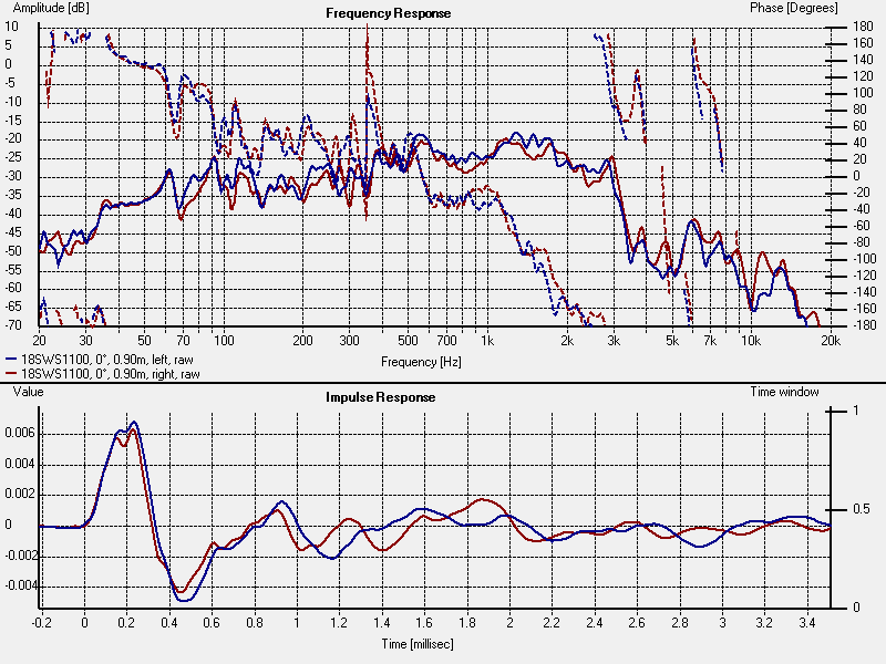

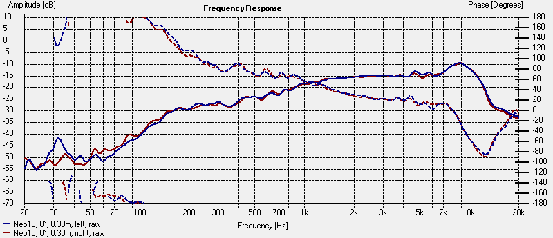

I think the mid shows it best between say 100 and 7K. As the SPL drops, going down in frequency from 7K, the phase increases. The faster the SPL drops, the faster the phase increases. That looks like minimum phase behavior and you'd want a minimum phase filter to fix the SPL and the phase at the same time.Can you help me by pointing out where in the attached measurements the 90 degree phase shift from the dipole roll off is?
Your SPL curve doesn't look like a classical 1st order electrical filter so, of course, the phase curve doesn't either.

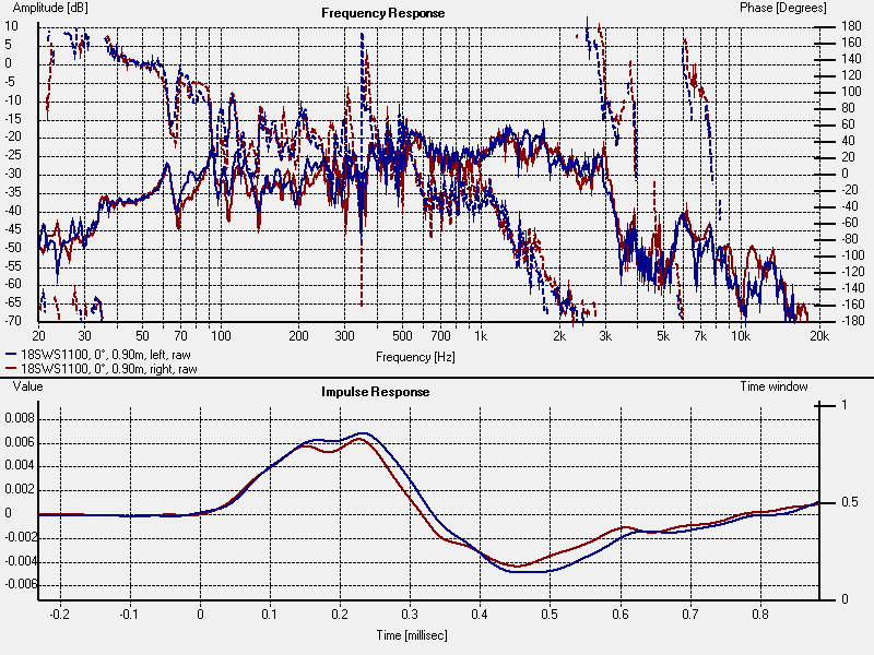

Some rough measurements of my 18" on OB
I have to admit.
StigErik, you are right about the LF distortion.
twest820, good choice of the 35Hz lower limit.

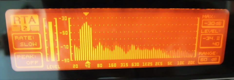

I did some rough measurements by a function generator and RTA of my DEQ2496. Nothing is calibrated. Just give myself and all of you a rough idea.
I gave the woofers a good workout, all 4 of them were doing this:
YouTube - Eminence SigmaPro18 doing 20Hz.AVI
It's doing 20Hz sine wave fed by function generator, I've never seen them doing such excursion except the (in)famous dinosaur's footsteps. There's very few audible "sound" when doing this, even with such amplitude. When playing normal materials, it'd be deafening loud.
Ok, the fun (sad) parts:
@20Hz and the level as the short video above:
I put the cursor at 80Hz to show its harmonics which are all over. It fills the whole 20~80Hz! I was shocked.

So, what I thought 20-some to me is actually coming with a LOT of (unwelcome) extras How stupid. And I finally realize, why I always need to EQ down 60~80Hz range of my system somewhat, or it'd sound too heavy-footed. They are the harmonics of the 20-some.
Later I tried cutting down those below 25Hz by a steep notch centered at 20 to -75dB max. And re-listened to those materials which have bottom end information. It's cleaner. And I brought back 60~80Hz for 2dB, it's even better.
A good lesson learnt. It's somewhat painful and shameful to know I was wrong, but good to know it's not going on.
