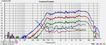

Something I've been interested in lately is DAC antialiasing filters. Per Fourier, the steeper the frequency domain rolloff and the narrower the bandwidth the longer the impulse response. So it's interesting to use slower rolloff filters---Wolfson's time domain paper is one of the better introductions to the topic---which in turn means some amount of ultrasonic content reaches the amplifiers and tweeters. How much depends on the choice of DAC and filter, but one's likely interested in the 50 to 100kHz range. As I'm not aware of tweeter distortion data in the ultrasonic range (Zaph's graphs, for example, all stop at 10kHz) I thought it'd be worthwhiel to update the Neo3 data in post 1 of this thread with a higher sampling rate.
Take the attachment with some salt. The mic cal used stops at 25kHz, the mic has begun to roll off at that point, and it's likely the breakup at 35kHz is the mic and not the Neo3--it doesn't appear in BG's published data. If I've got my calibration right the peaks of the curves at 9.1kHz should be 90, 80, and 70dB SPL. Those issues aside, the implication's there's not enough going on in the ultrasonic range for IMD downmod to cause audible problems when the driver sees a flat PSD. Since music PSDs are typically 1/f and single speed (44.1 or 48) slow rolloff stopbands start around 35kHz with 100dB or more of attenuation any problems lurking under the measurement limit here are likely to see 50dB or more of attenuation. So, unlike some tweeters which have high Q breakups just outside the audio band, ultrasonic handling on the Neo3 looks fine.
Should anyone be inclined to loan me an Earthworks QTC50 I'll be happy to remeasure. ;)
I have always found many of the modern V out dac chips to sound best with no analog ultrasonic filter following them. I also run them direct out through a high quality blocking cap with no buffer. And, have also reduced the value of the output coils in my Tripath amps to a minimum. Ultrasonic noise above 200kHz is apparently no problem and the gains in reduced parts count in the signal path far outweigh any losses.
It's been a while since I looked at the Tripath parts but, from what I recall, their loop gain probably drops below unity before 100kHz. So I would not expect the low order, out of audio band lowpasses typically used with DACs to be audible---commonly used cutoffs in the 50 to 200kHz range likely have more bandwidth than the amplifier and hence do little or no signal shaping compared to the amp. A corollary is the power amplifier likely lacks the loop bandwidth to respond to images. Is this an ABX or blind A/B result? Do you have a system schematic, layout, or measurements you can link?
Some of those threads are over 100 pages long, but I looked through the first few pages of each and didn't see schematics or measurements (other than the repost of AKM's out of band noise figure) or discussion of lowpass filtering in DAC output buffers. So I figure it's sighted AB of an AKM4396 + SP2050 versus [something] + SP2050 with a population size of one. That's, umm, let us say, not a statistically significant result. Makes it kinda hard to base design reasoning on. ;)
