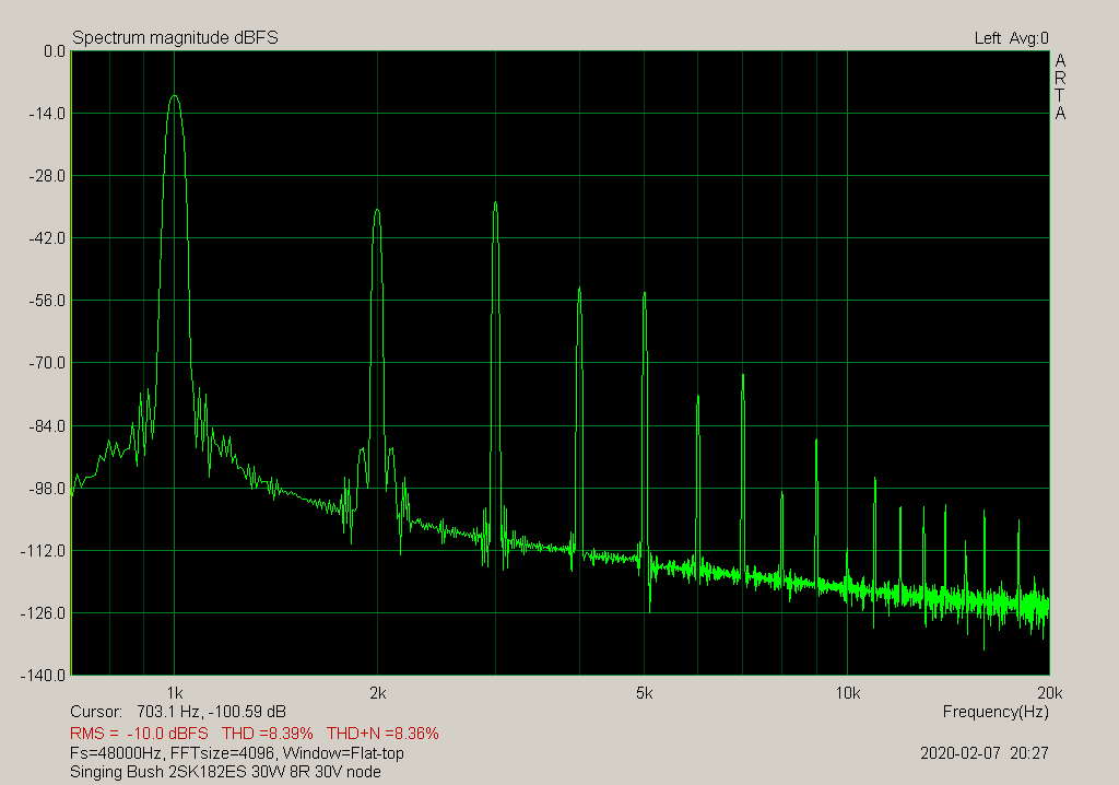

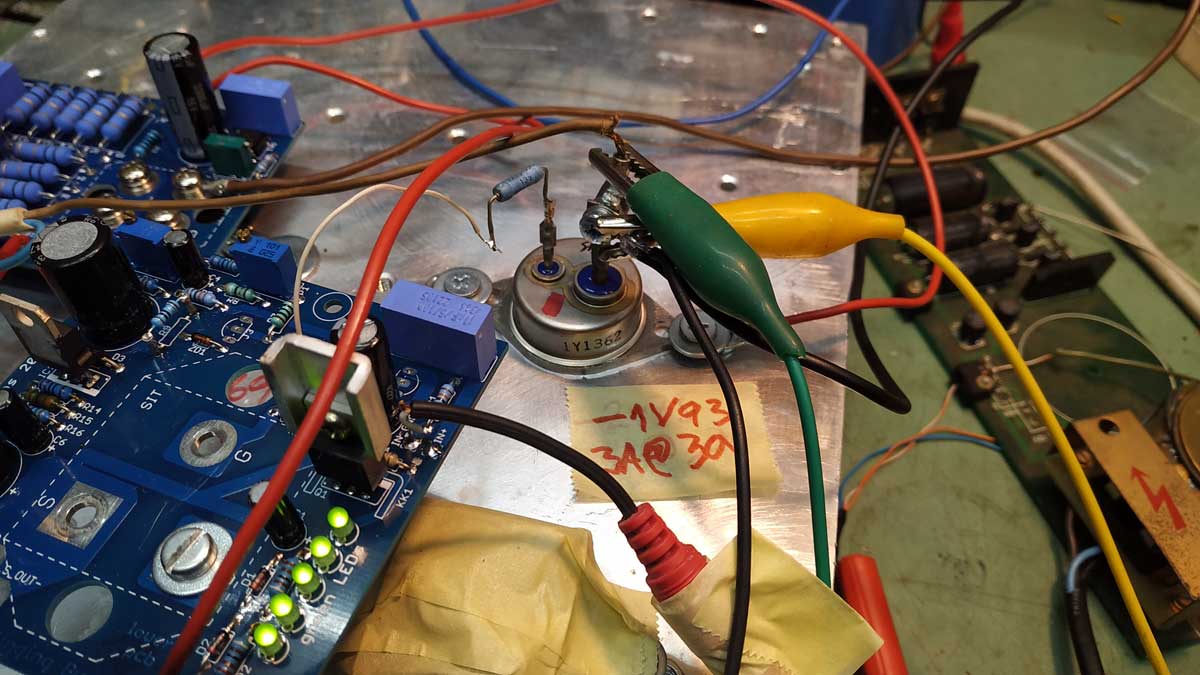

OK ........ I've been wowking on the waiwwoad ......
YouTube
still THF51S at heatsink , tried 2A4 Iq , measurements at 1W comparable with 3A Iq, both for 30v and for 35V set at output node;
tried 2A Iq , same thing ........

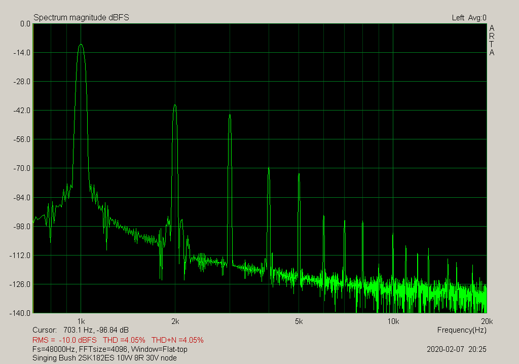

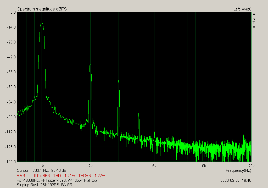

Removed THF51S , took random 2SK182ES and did some playing ......
at 2A and 2A4 for Iq , opposite behavior comparing to THF - smaller THD at lower voltage at node
dialed back to 3A Iq and made set of measurements for 30V and 35V at output node ..........
Official Court Jester
Joined 2003

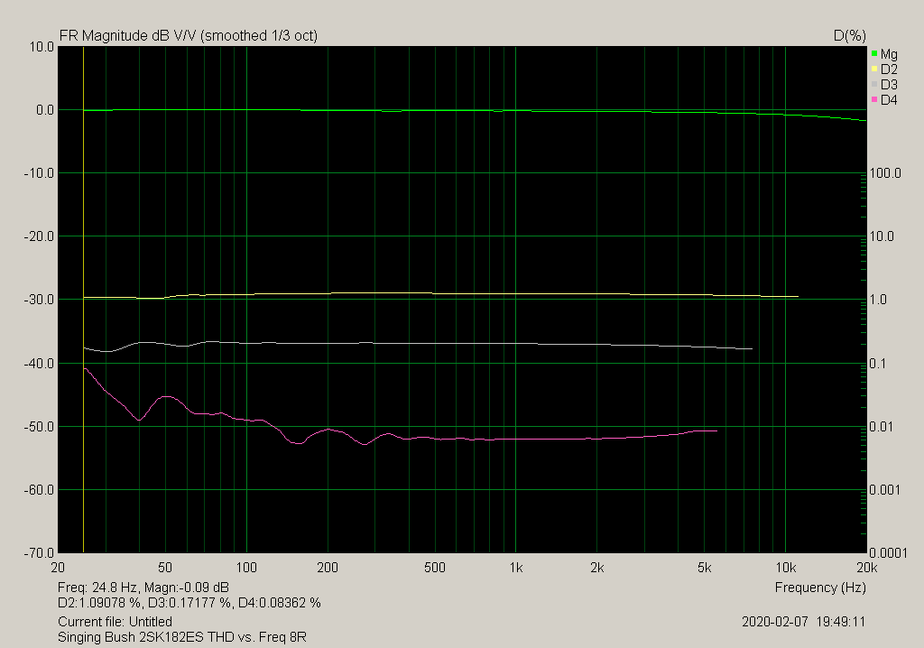

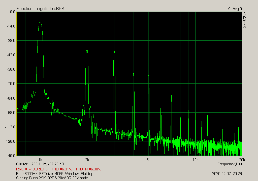

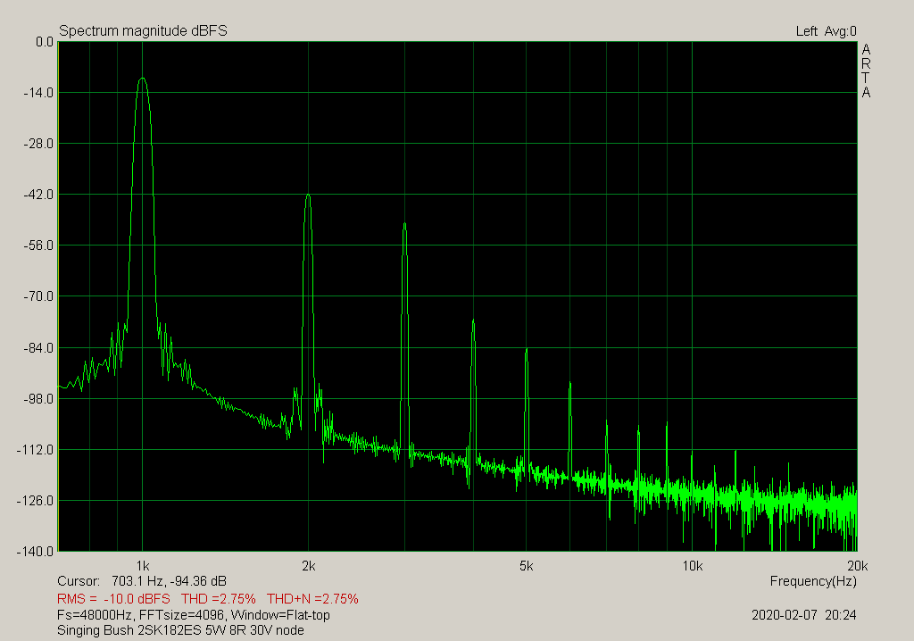

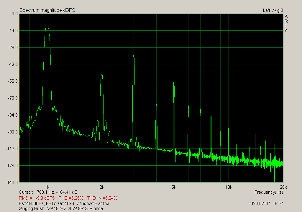

Singing Bush 2SK182ES , 8R load , 30V output node

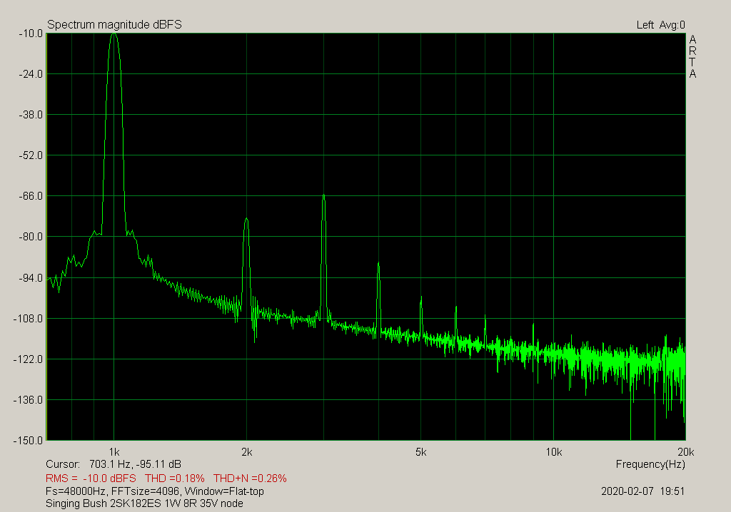

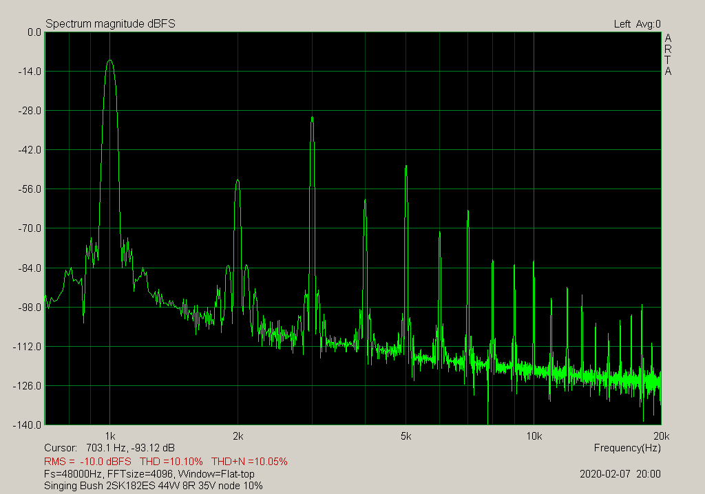

Joined 2003

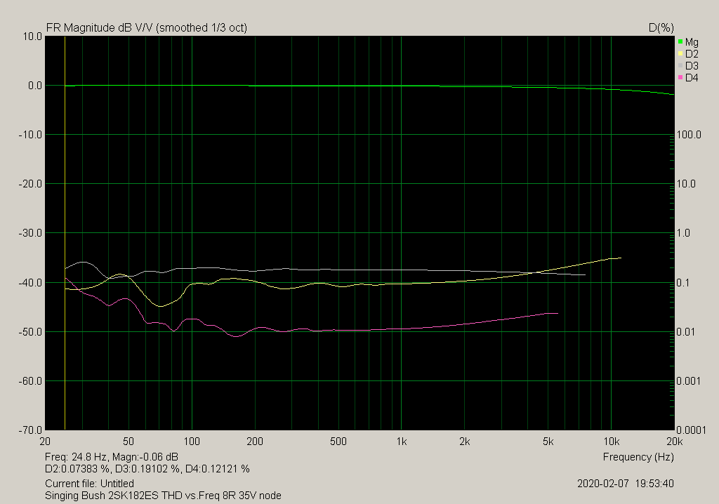

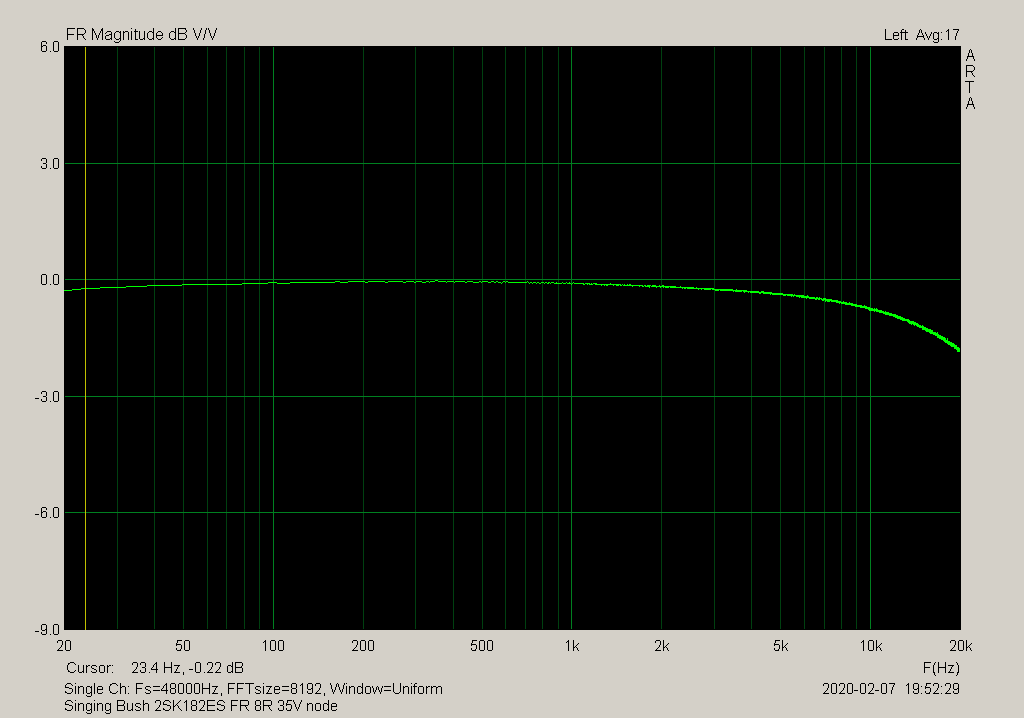

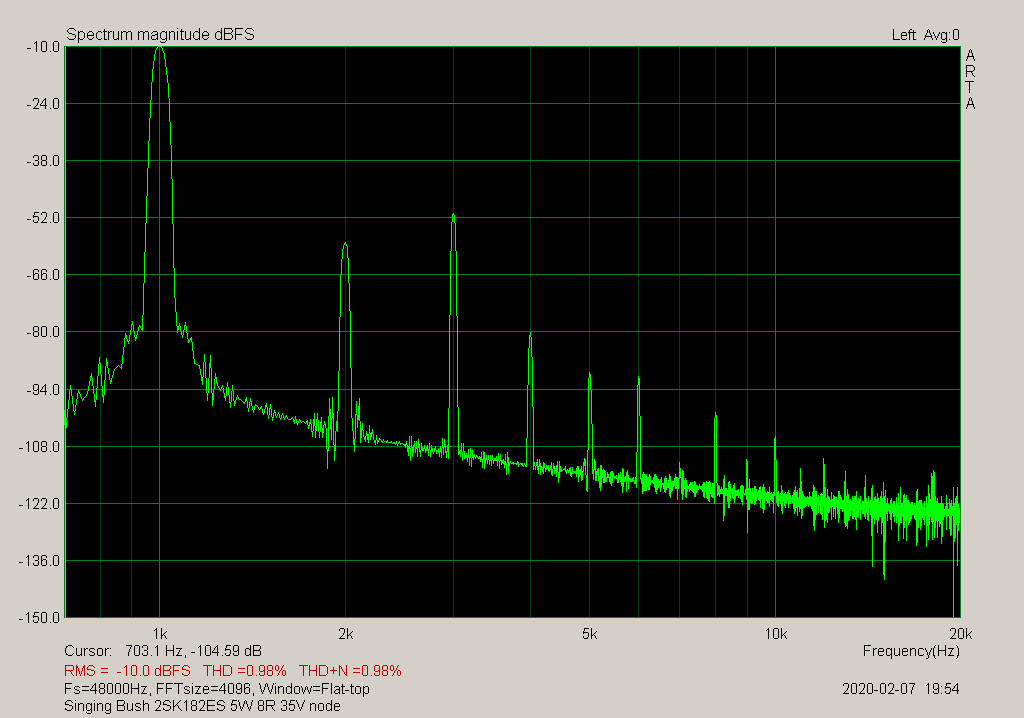

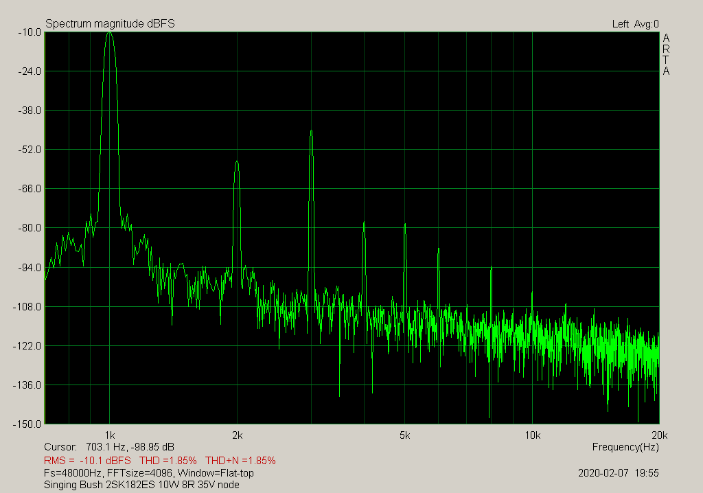

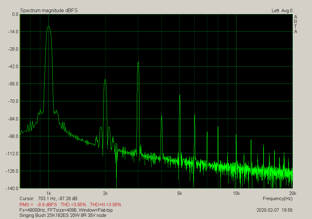

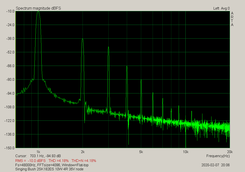

Singing Bush 2SK182ES , 8R load , 35V output node
see 3rd !!!

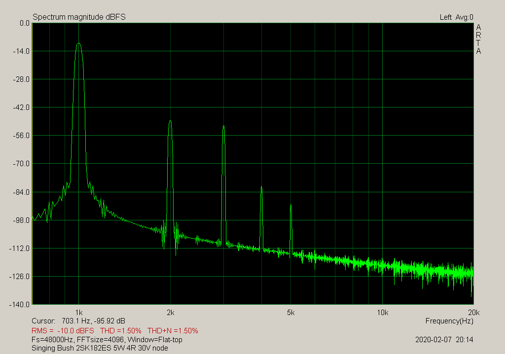

Joined 2003

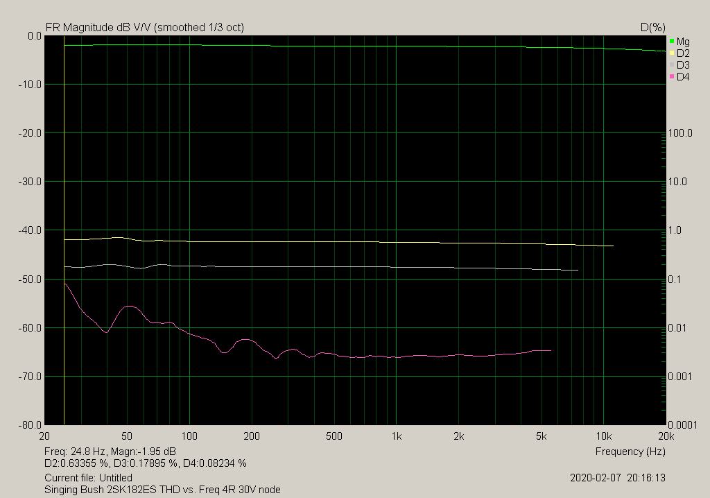

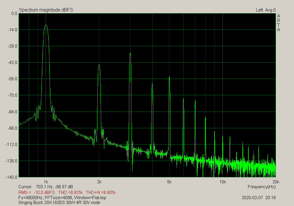

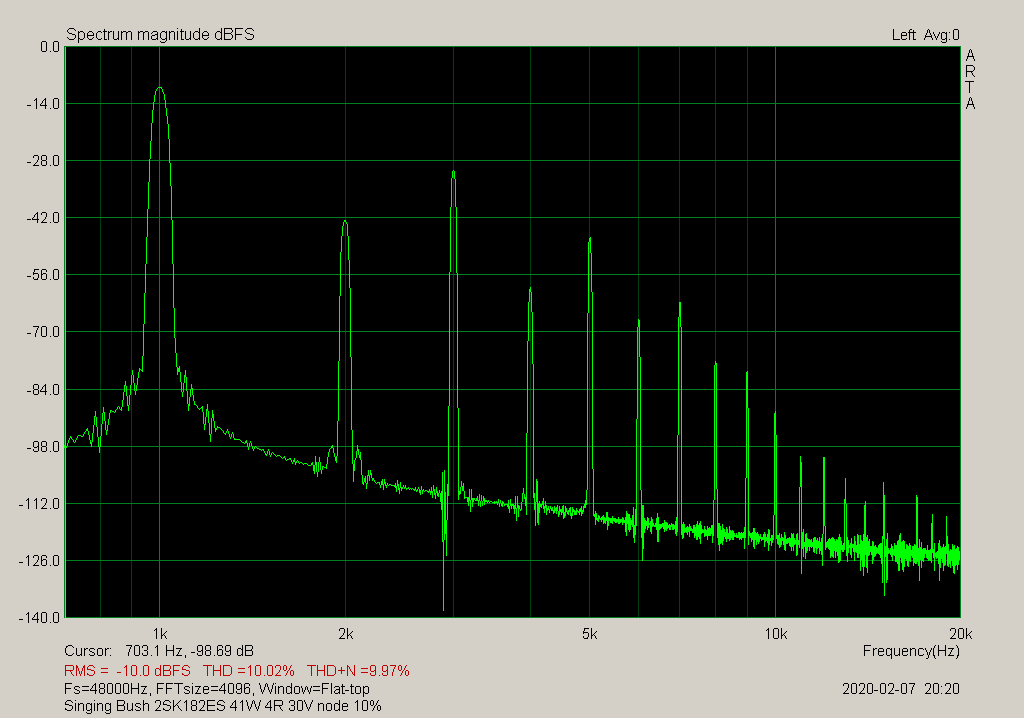

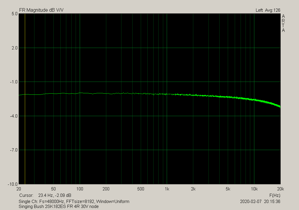

Singing Bush 2SK182ES , 4R load , 30V output node

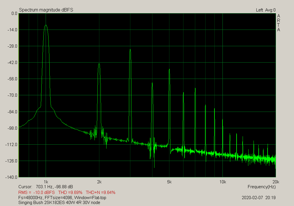

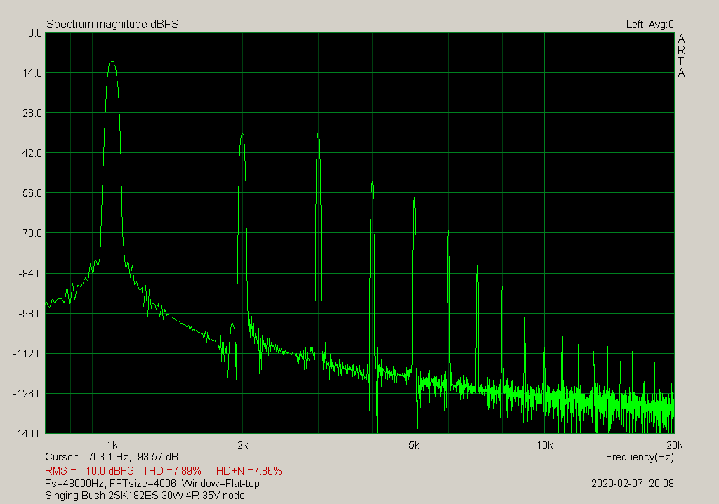

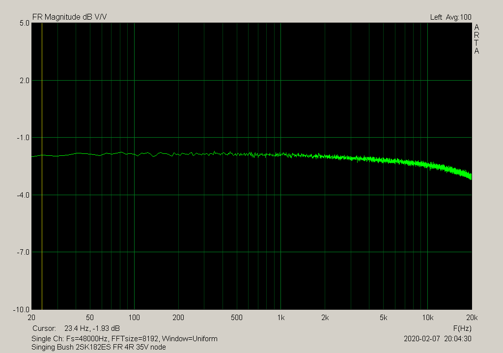

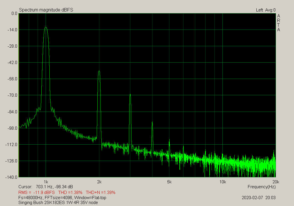

Joined 2003

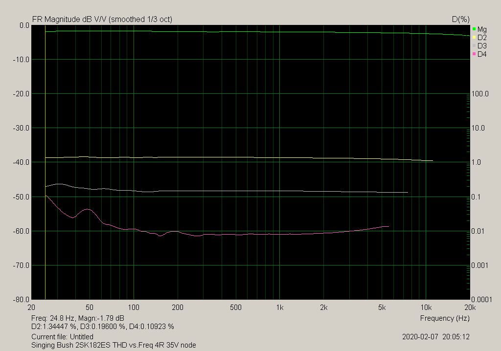

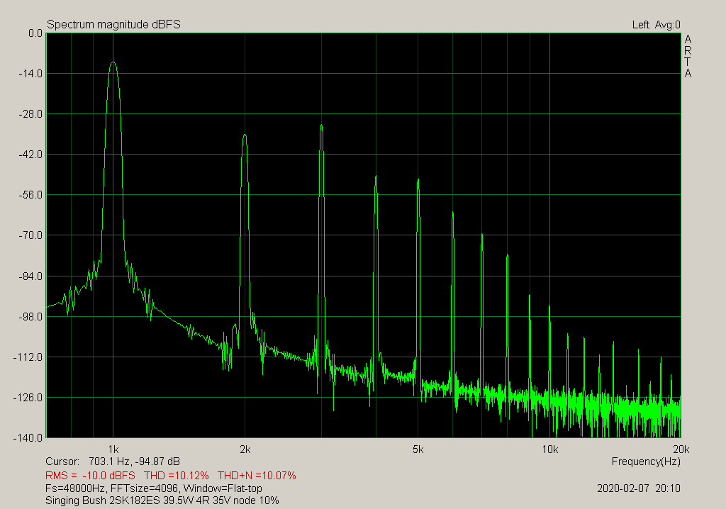

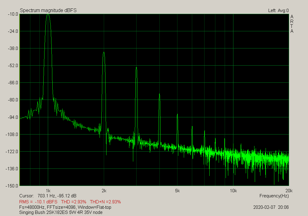

Singing Bush 2SK182ES , 4R load , 35V output node

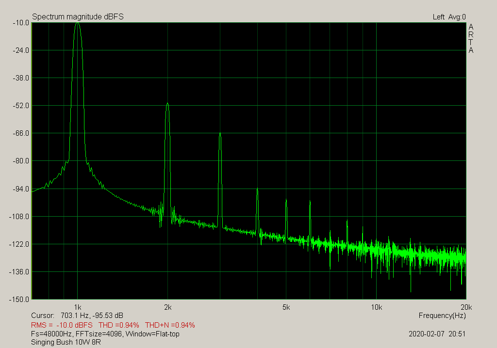

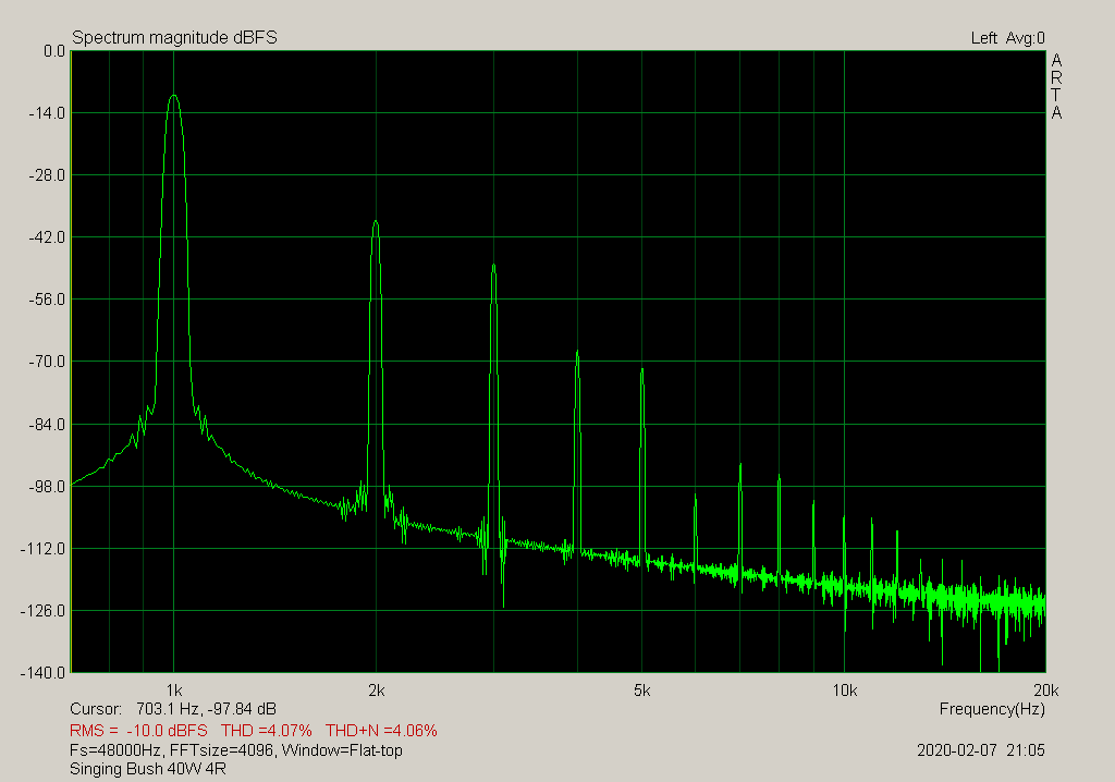

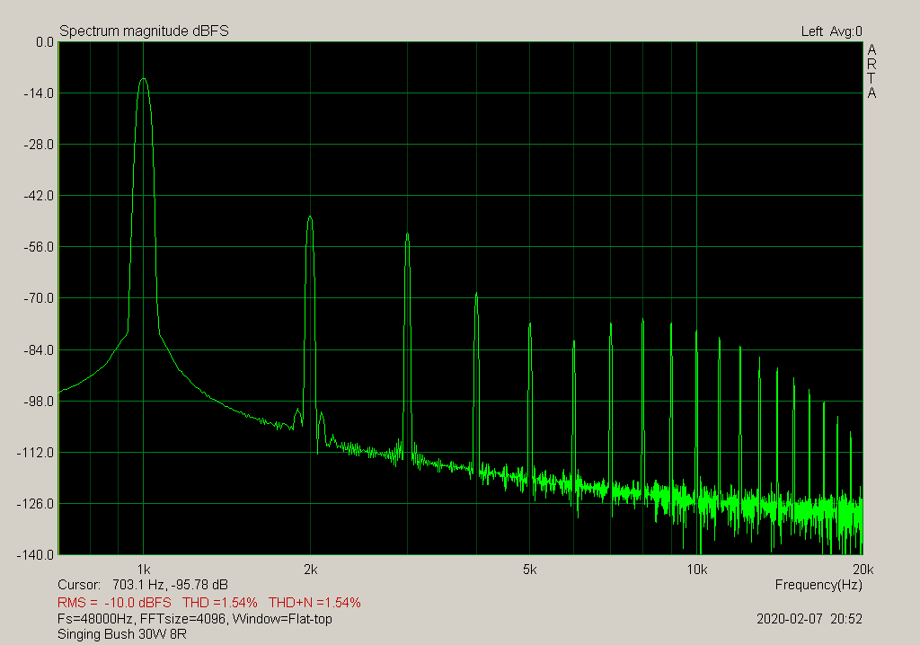

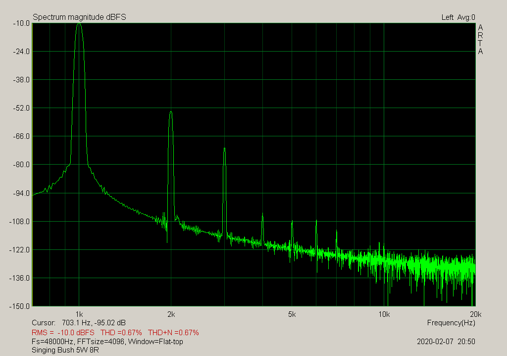

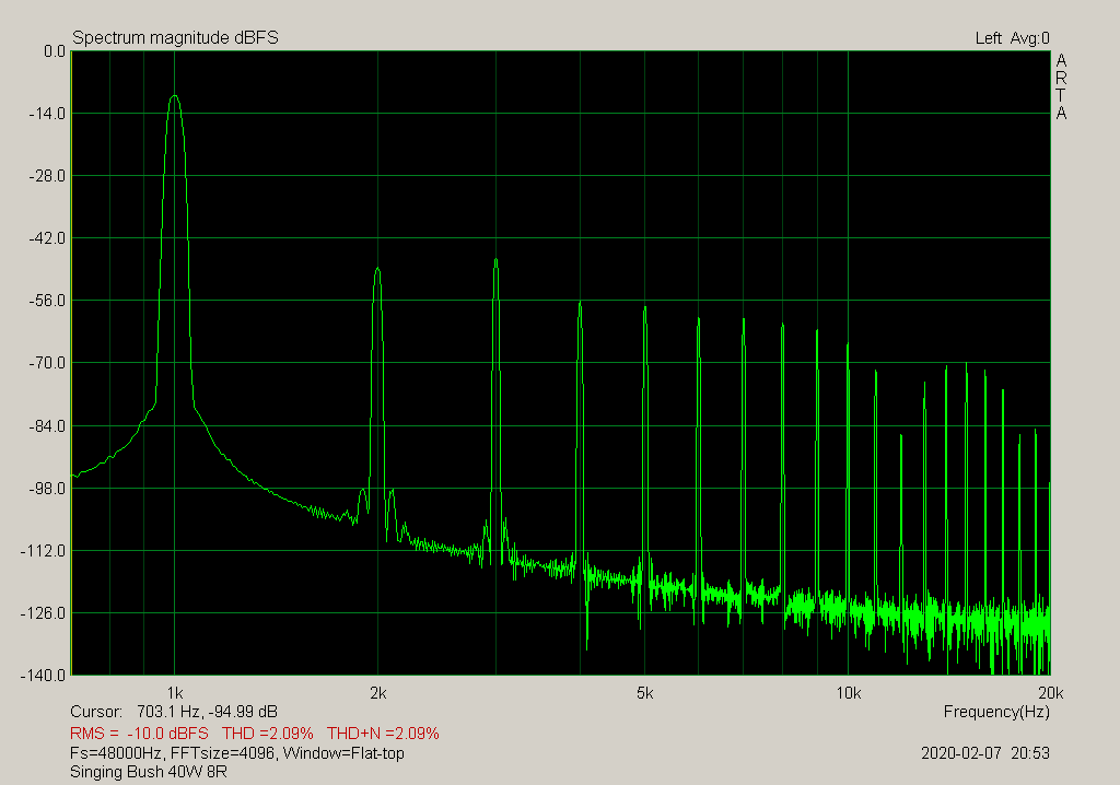

Joined 2003

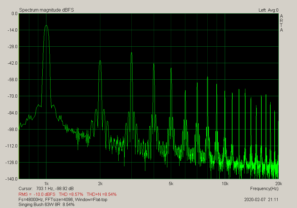

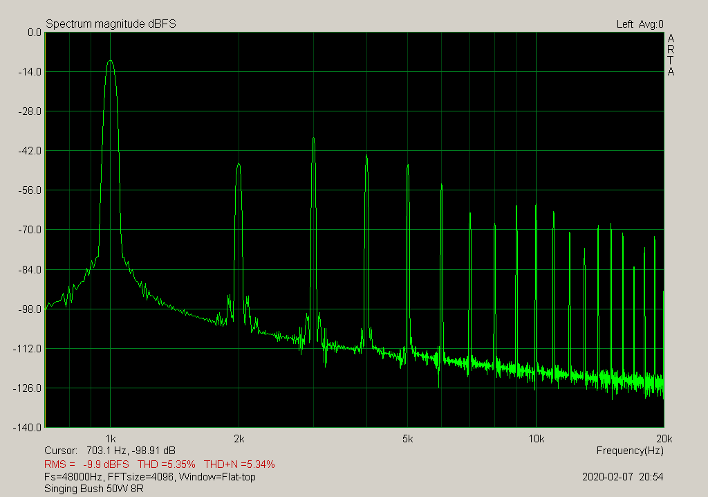

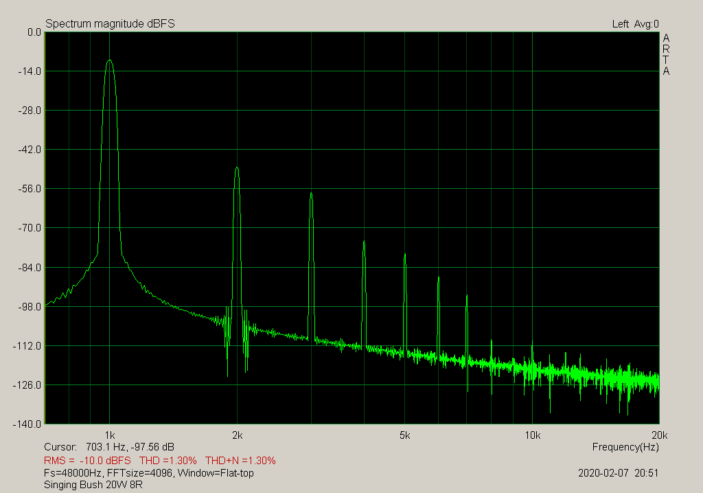

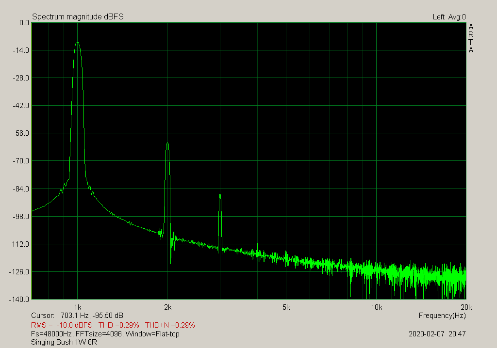

The Larch! 8R load
removed wires from puny 2SK182ES , removed protecting cover form The Larch , mounted gain pcb again on The Larch, and put The Larch in good use ......
The Larch!
my EMU1212 setup didn't had enough cojones to move The Larch to 10% THD , so that's why I stopped at lower

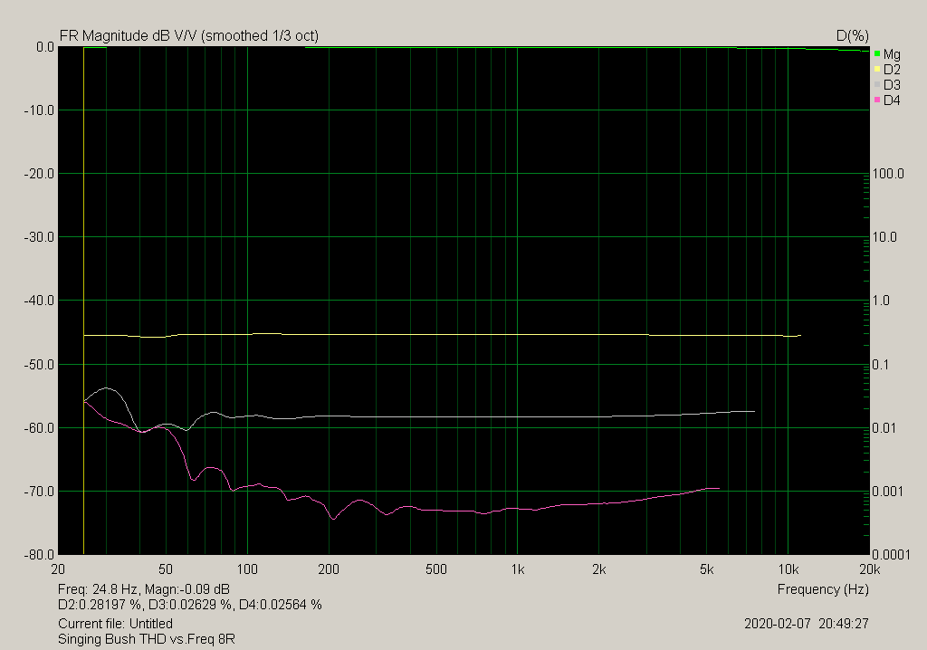

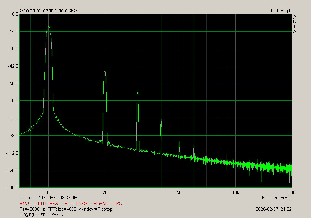

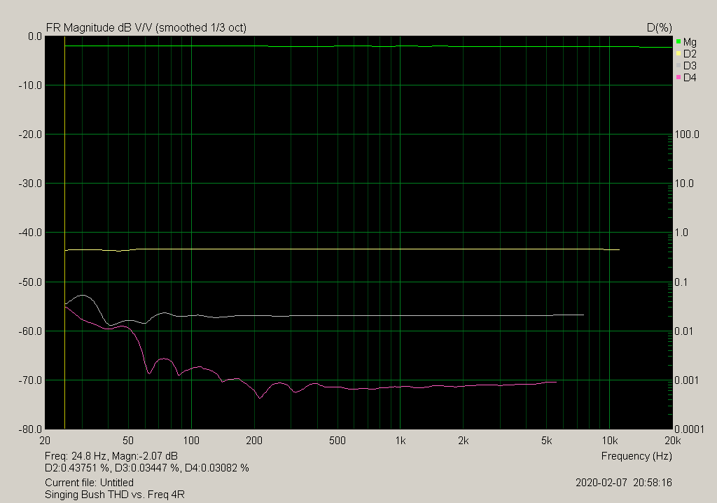

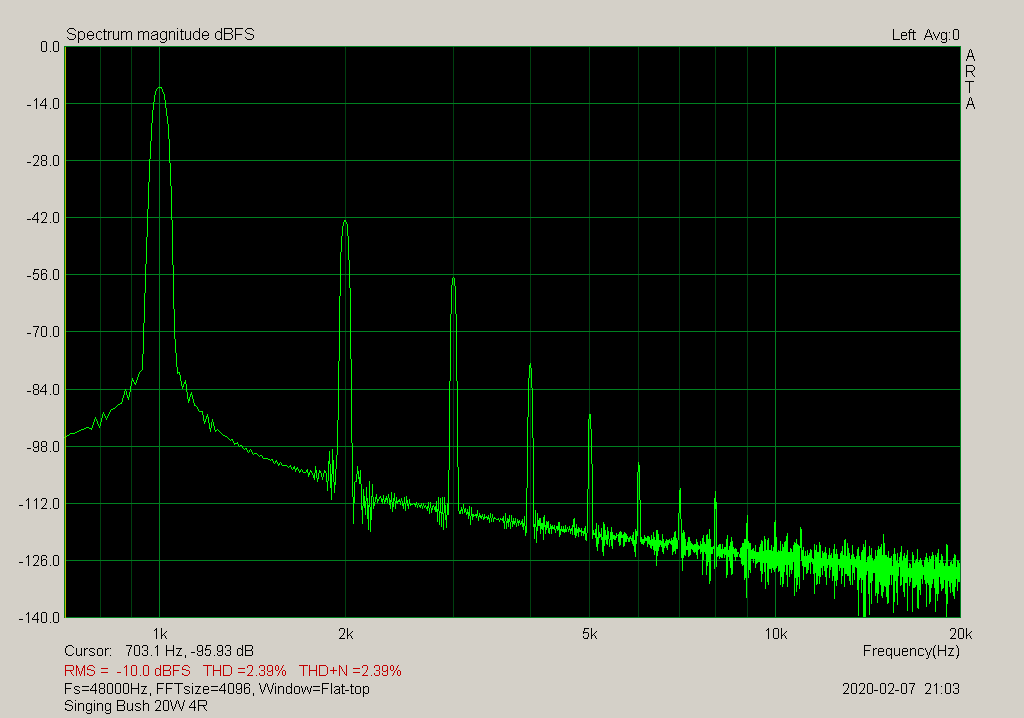

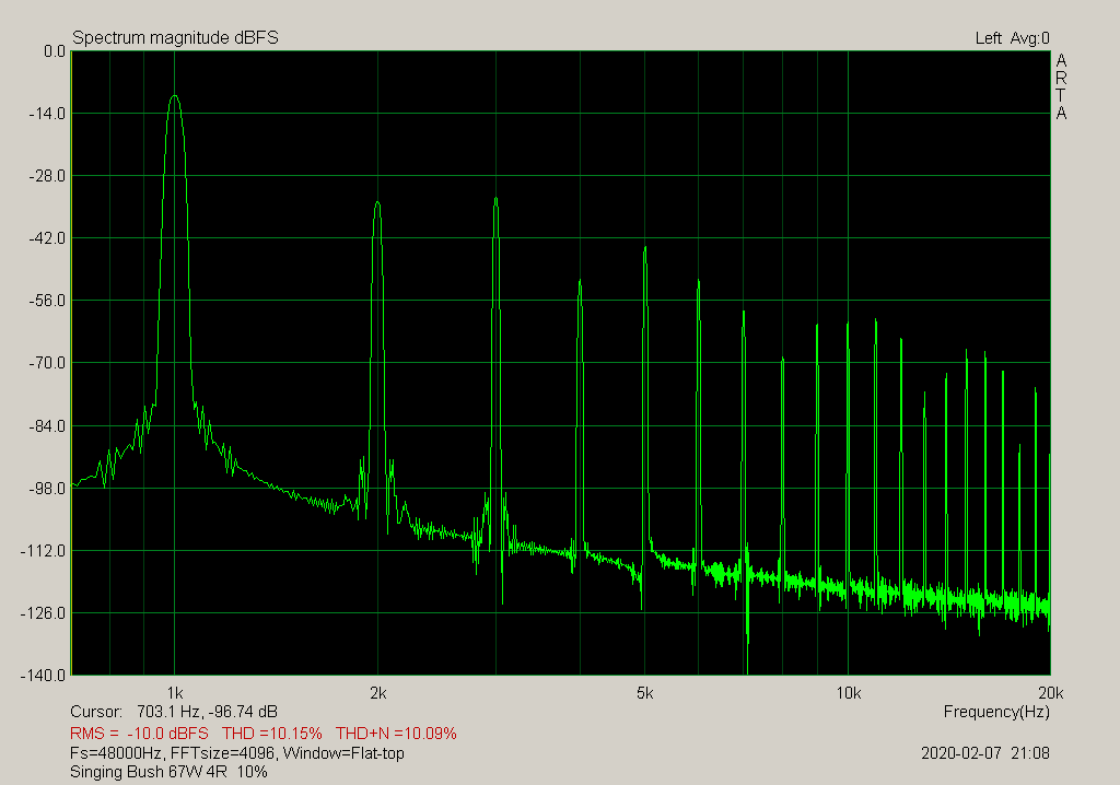

Joined 2003

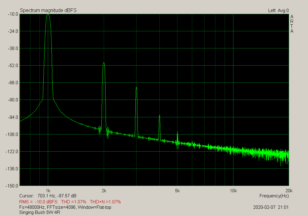

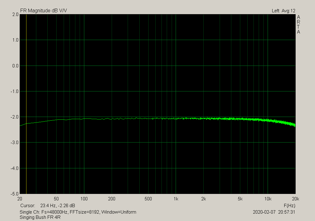

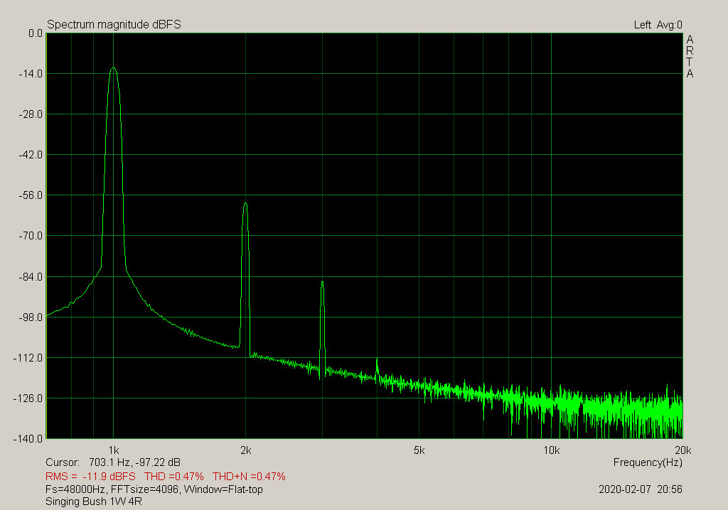

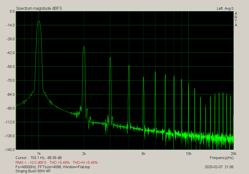

The Larch! 4R load
for this , Cojones for 10% were there
Joined 2003
Conclusions .....
Is it worth to make Lesser Larch/slightly Hysteric Singing Bush, either with THF51S or 2SK182ES ?
Having an eye on last lhquam's musings - he's Da Man when Math and Scientific approach are needed - SIT measurements, Mu Follower, and amplifier build ........ I'll put back TH51S these days and play little more with basic factors (rail voltage, Iq .... dunno what can be done varying Mu gain) trying to find most satisfactory combo of THD vs. power and Cojones
Anyway , even with presented/tried basic factors , I would go and build any of these - whatever you have in drawer
if you don't have it and you intent to - maybe is little better to opt for THF
as I said the other day , I have pair of monoblocks to make for my Polish guy ...... old cases of his (now) defunct Aleph X monoblocks are crying for some heat ...... :)
