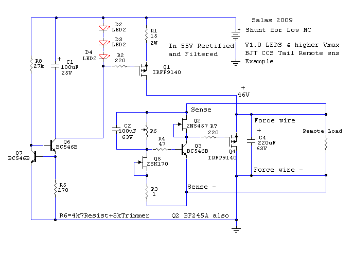

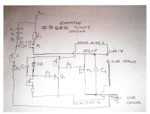

How will have to do with the schematic of version V1.1 for Low MC Phono to became "sense wire".
You mean how you can remote sense any V1.0 I guess. Forget V1.1 when there is 1.2. It was an intermediate step. Here is an example of your 46V V1.0 for Low MC for how to apply sense wiring. That is for just any V1.0 who somebody wants to apply sense wiring. V1.0 is not picking up noise from the sense wiring as easily and it can be done with a twisted pair, same type as the main output force wiring taken from Q4/C4 nodes.
Make V1.0 remote that you have almost ready which is very good, simpler to layout and does not need the expert DIY oscope checks for reactions with loads, also is friendlier with RF pick up and GND, so to listen first, it matches very well with the phono. You can concentrate in a V1.2 build later on, when more expert, so to compare the resolution also.

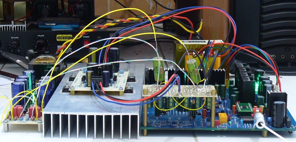

You have some burned out components there.
I have changed Q2 2N5457 due to be burned, also I changed only to be sure both IRFP9140.

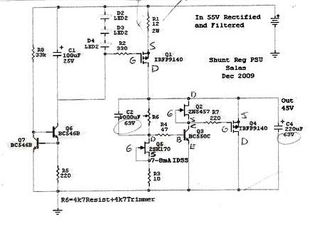

mr. mago, point to the schematic you implemented and which particular Vin and current limit you chose.
Is for Salas Simplistic Low MC Phono, Vin 55V Vout 45V current more or less 200mA.
Use a 10R 10W R input to your main filter cap. Will go down some Volt if the CCS operates.
Is your Ref a 4k7 resistor in line with a 4k7 to 5k trimmer as designated?
Is the Leds CCS correct for connections? Its a bit tricky there. The CCT you make works nicely fore some months now in symmetric for a D1 DAC BTW, made by CRT. So it will work in the end for you too, don't worry.
