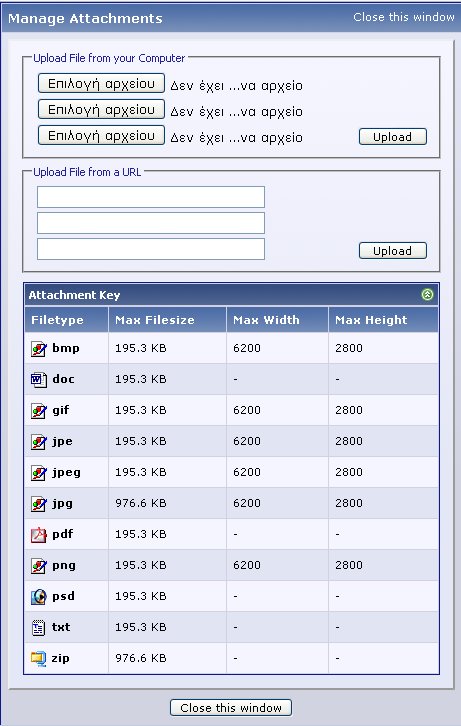

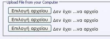

Listen, when you post, if you look down, it says ''Additional Options''.
There is a button that says ''Manage Attachments''. There you attach pictures. OK?

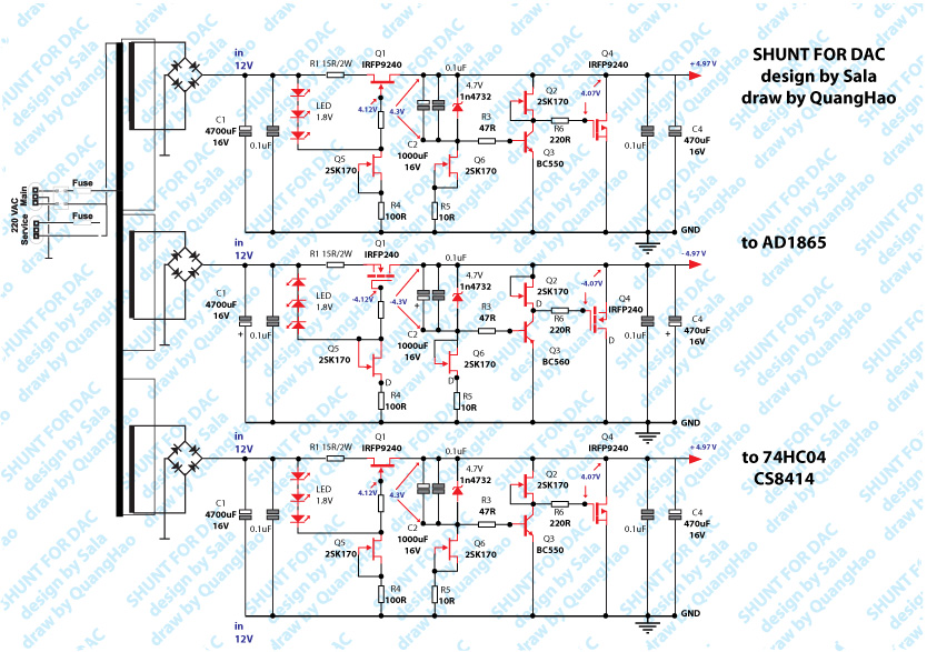

Current you set at 150mA with 15R R1 2-5W, and check if it is enough for your 5V needs. IRF610 OK for negative, IRF9620 OK for positive. Use 2X Led instead of zener, that show 2.2Vf at about 5mA. Vinput 10-12V DC.
Hi Guys,
if i want built salas shunt for my dac, can i use a irf610 as mosfet and what's current for CCS mosfet and shunt mosfet? Thank you! Maxpou

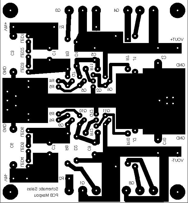

While waiting for some very important parts, I have been working in the pcb for the V1 with sense wires.
This is my last effort after some of your comments.
Please let me know if you agree with this layout... (Hope I can bend the legs of the mosfets even after placing the heatsinks:rolleyes:)
Ricardo
Ricardo
Looks good to me Ricardo. I see no reason why you shouldn't be able to bend the mosfet legs.
Here are a few suggestions, nothing terribly important.
* make the mosfet pads so that there is more copper around the hole; the hole can be a bit smaller diameter, the the pad can be made oval (like eagle does), so that it is extended towards empty parts of the board. When it is circular and you make the pad wider in all directions then it gets too close to other tracks
* make the track from +vin to the 10R resistor as thick as the rest of the main signal track
A general suggestions; try to use C4, the output cap, as small as you can get away without oscillation. Ideal would be to have no cap there.

Thank you Iko
I will review the layout and post again.
What would be the minimum cap value in C4 ?
Ricardo
Do you have a way to tell if it oscillates? If so, then try without any cap there. If its stable, see how you like the sound. If not stable or you don't like the sound, try 10nF, or 47nF, or 100nF, or 470nF, or 1uF... and so on. You're a master tweaker, I expect that you would find the best that works for you; let us know too, your impressions.
Just to explain, there are some experienced people who think that the reason a shunt reg sounds so good is because it decouples (separates) the psu capacitors from the circuit it powers. The output cap on the regulator doesn't have much of a reason besides helping against oscillation. So, if the reg doesn't oscillate without the cap, it should be most transparent solution. Otherwise, smallest best cap you have would be recommended. But you're much more of a tweaker than I, so please test and let us know.

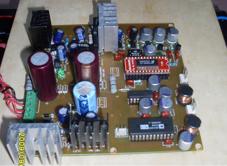

Hi Salas !
I have a job I would ask him to help!
In may DAC shunt supply
Vinput 10-12V DC.
I replaced Diot July 4.7 v = 5.1v
both negative and positive source of real results are:
+ out 5.5 v to the right!
- different a larger capital May 5.9 v!
Please ask how to adjust to negative and positive with each other!
thank you very much
Pm you can see the image!
