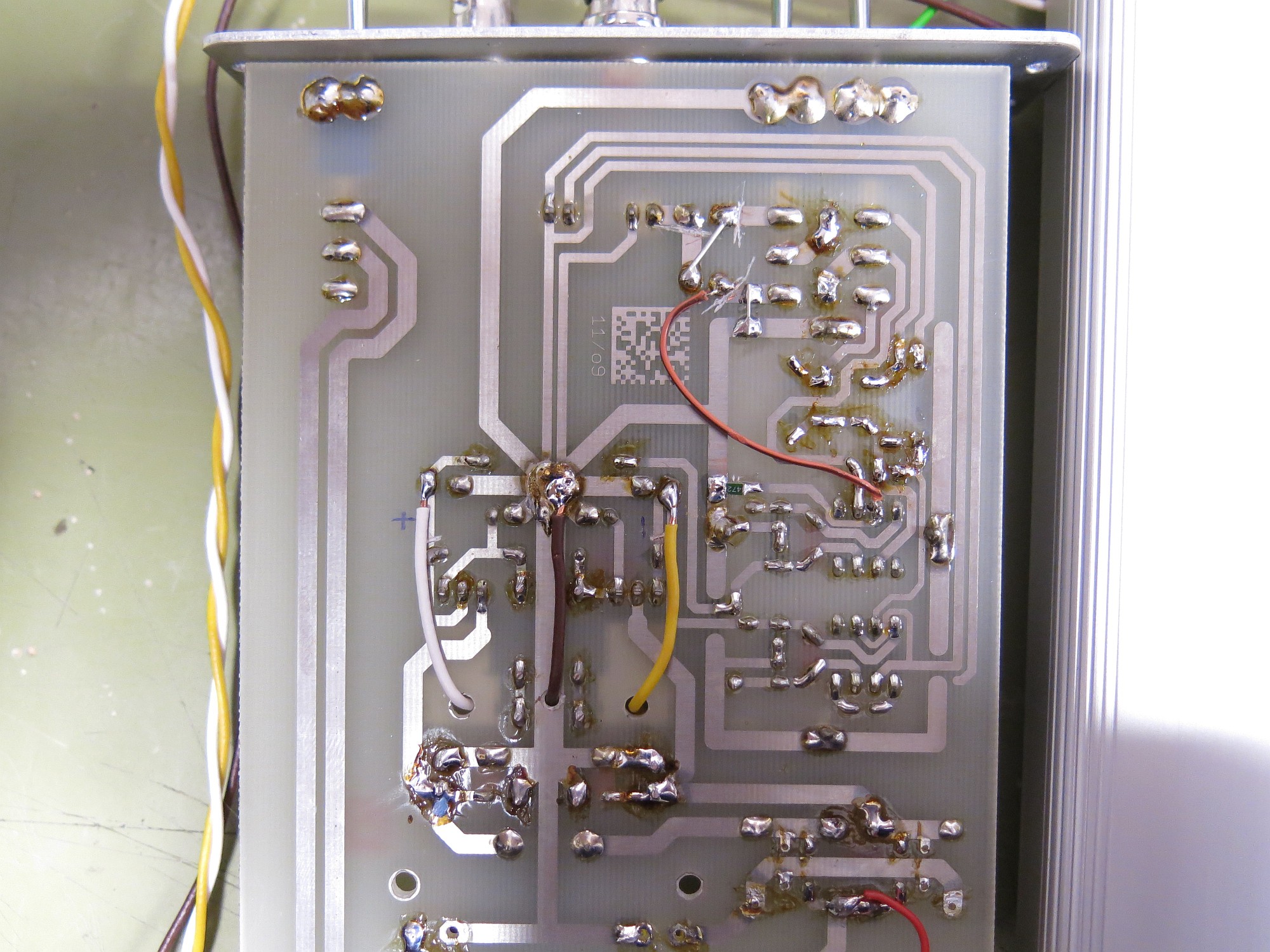

I see a bunch of tracks, but can not identify which one is which node.
Does this help? I'd have shown you the layout from EAGLE, but since it's modified a lot I thought it would be rather more difficult to 'read'.

I cant match different pictures with mobile phone, so now its not enough to reconstruct the signal pathes.

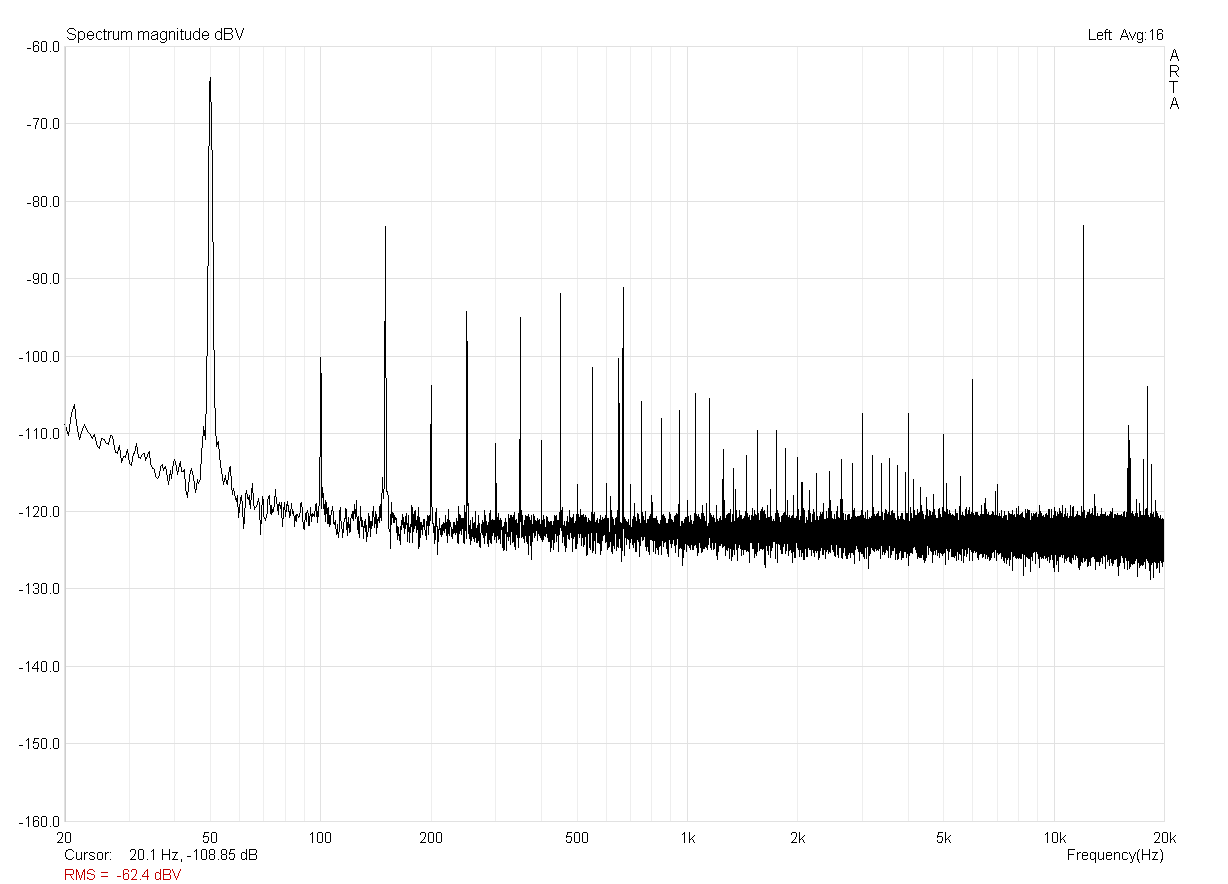

...with lab supply, but this time with a length of cable connected to the input. ... Input was shorted, too.
-70 dB
Other thing I tried was to connect the double-shielded coax to the input and directly short the ends. This is the red trace. Lab supply was used.
-100 dB
What did you do differently???

And I ain't got X-ray... Added some notations that will hopefully make it somewhat easier.

-70 dB
-100 dB
Like I told in post #7290, I removed the ground connection of R3 from the star ground and directly connected it to the input BNC connector. I drew that up in the sketch in the same post. So the first value comes from R3 connected to the noisy star ground and with the measurement cable connected to the unpowered DUT. I also tried to short the wire at the DUT but didn't show a trace of that, because it looked basically the same. Now that I think about it, it was probably due to the DUT still being connected, albeit the cable was shorted. And the second value comes from the shorted measurement cable, not connected to the DUT, and R3 directly connected to the input BNC connector.
It was not clear when did you change it. Especially because you said
So... we have a result of 30 dB improvement, but dont know why, since not tested in the same environment. You can attach DUT the same way as before, and measure the result. Based on the result I will be able to advise the next step.
But you also can do the output cable test as written before.
There are many ways to figure out how big disturbance is caused by each components. Basically you have 3 stages and 3 current injectors. The stages are: 1: input cable, 2: preamp, 3: output cable. The current injectors are transfer capacitance of transformers A: in DUT, B: in PSU of preamp, and C: stray capacitance of environment (this is unfortunately a distributed network, varaiable, but smaller). There are 9 combinations, for each there is a specific disturbance level. What you measure, is the sum of them. You can measure them, and then you can eliminate them as much as you tolerate and as much as you take the effort. Probably you eliminated A2, B2 and C2 already (by changing connection of R3), but didn't test, because in the earlyer test there was a much higher C1, so you can compare them.
which is contradictional, since there were no similar spectum within the published results. Or difference between what?Looking at the spectrum now didn't show any difference though.

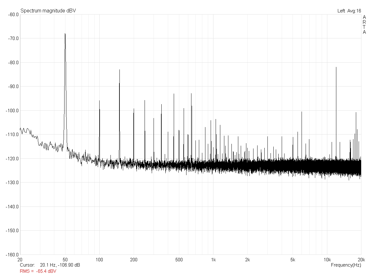

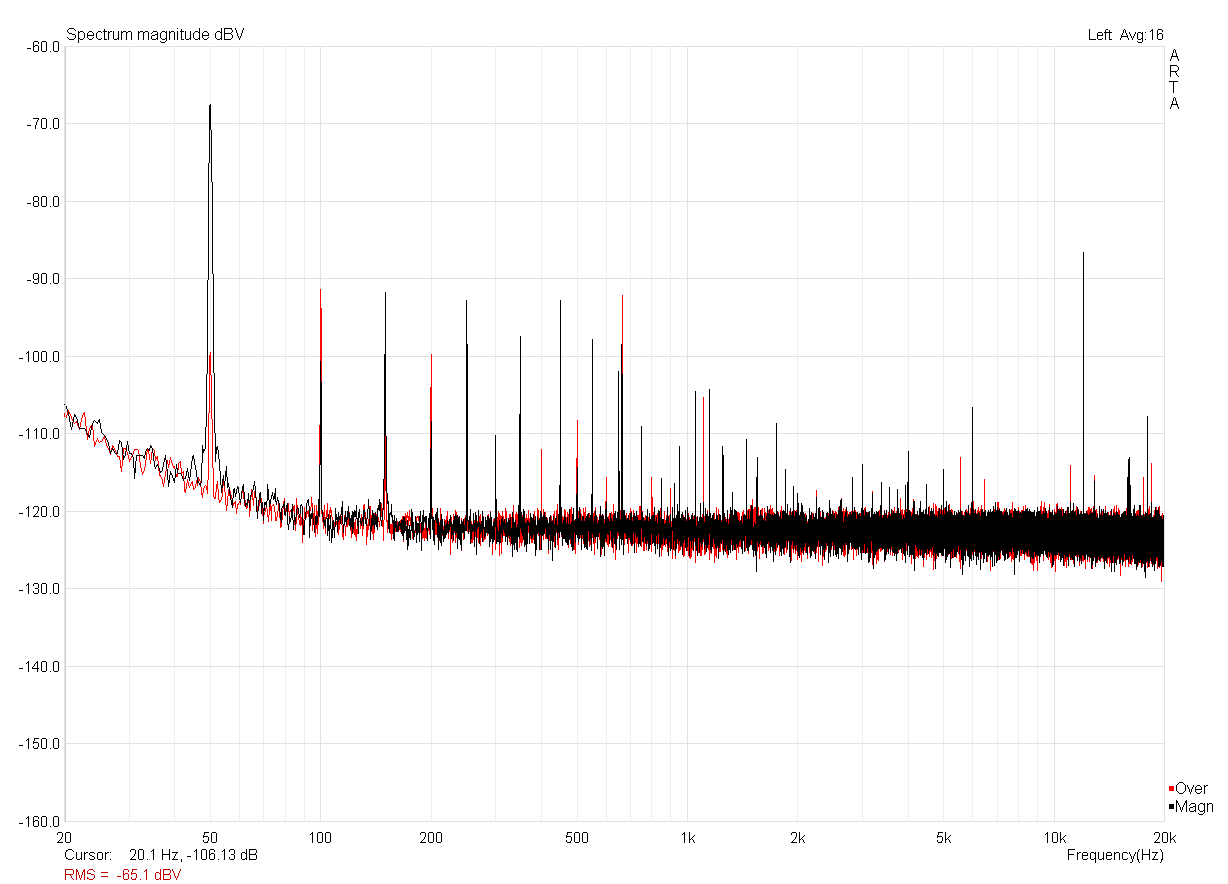

Results here.
Gray trace: Output cable connected to soundcard, input left open
Black trace: input shorted. Note 50Hz is gone.
Red trace: input shorted and shield connected to transformer secondary
The spikes above 50Hz are most probably due to the computer's psu, as they were slowly but constantly moving upwards in frequency. I had powered it up just prior to the measurements, so you can tell in which order I proceeded.
The spectrum with the DUT connected shows lots of even order harmonics way up into the kHz, while they're basically absent with the soundcard only. They're probably swamped by the noise floor.

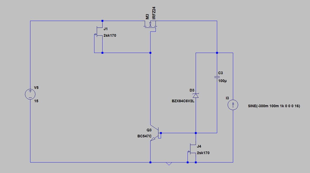

hi everyone,
i wanted to experiment with other regulators for my digital gear as i found out they benefited from low output impedance (it seems) and Salas shunts are designed for analog stages.
i tried a tl431 controling a bjt in series (kind of cap multipier configuration) and it did not sound as bad as i thought it might.
so then i thought about a "series Salas reg" that would give more headroom for active devices to perform
you guys think it s worth playing with?

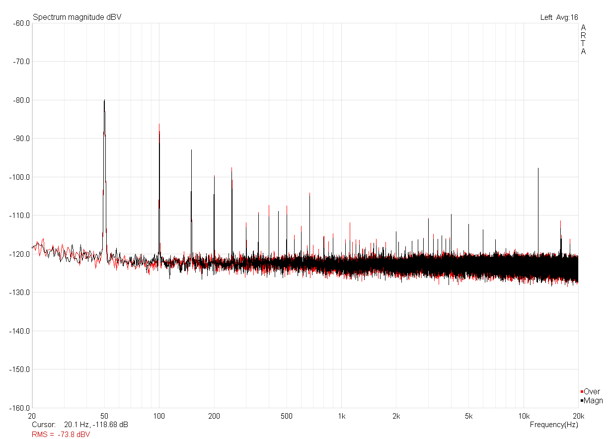

Re-ran the measurement with the DUT connected as before. Looks pretty much the same to me, so the DUT must be a pretty good antenna for EMI and stuff.
Sorry, I was wrong, not the same way! You should connect DUT only to the input GND of preamp, while input is shorted, this way you can avoid activating C1 coupling. But unfortunately there is no this type of measurement was made before modification. :-(
Results here.
OK, it's not so bad. You will be able to improve it with the common mode filter.
Can you show the waveform (filtered)? Maybe somehow the rectified voltage affected the system.

Turning it around as series topologically looks ok in your schematic but I would worry about stability issues in practice. Better breadboard it to test it does not oscillate.

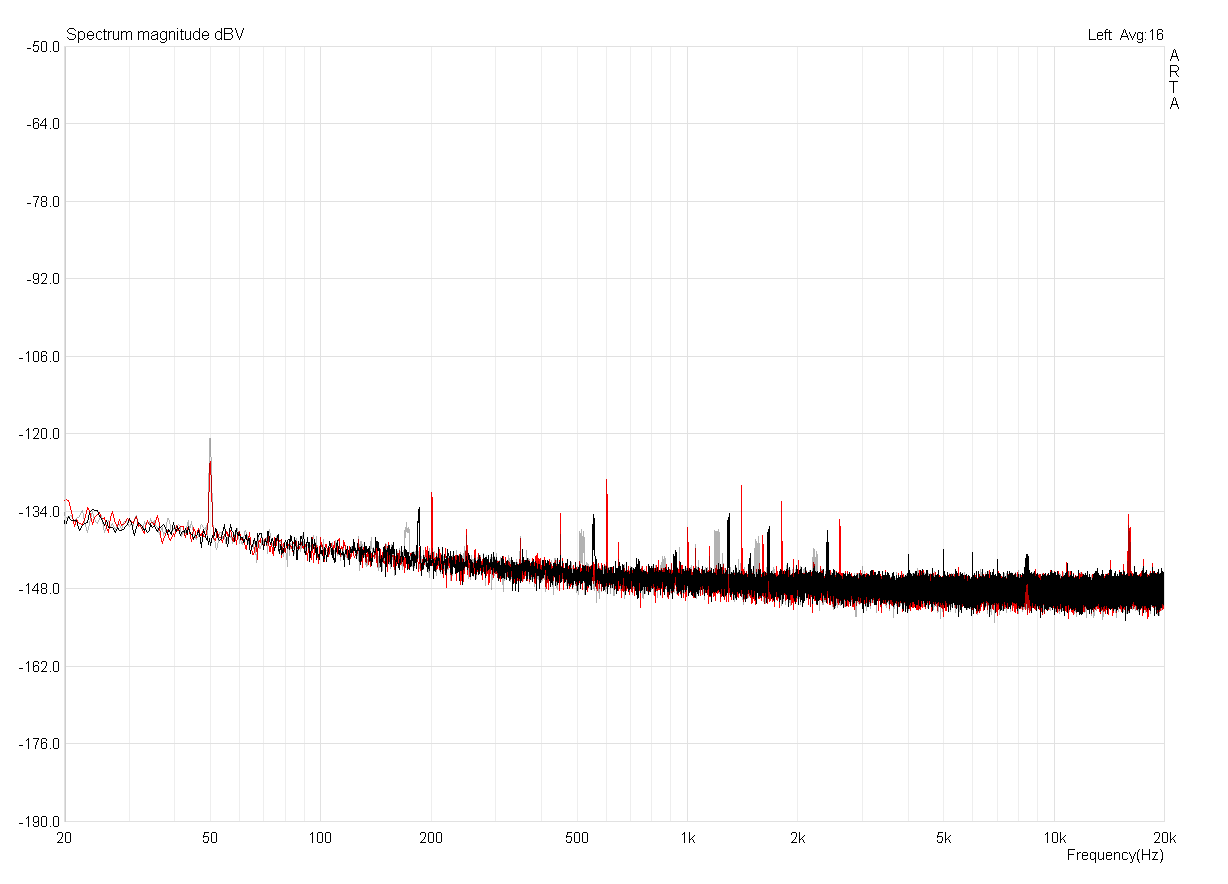

I have put the DUT into a biscuit tin and connected that tin to the preamp's case with a separate wire. Of course the faraday cage was not 100% sealed, but the spectrum changed visibly. 50Hz dropped considerably from ~-67dB to ~-100dB, 100Hz went up by roughly 10dB and 150Hz again went some 10dB down. Looks somewhat better, but still too noisy for what I want.
Why would I do that for practical purpose?
To test immunity of preamp for current injection without disturbances picked up by input cable.
Just did it for a test (with R3 connected to the BNC connector), the spectrum shows virtually no difference.
The red trace is with the input shorted inside and the BNC connector left open,
While the input cable was... ? And DUT was... ?
the black trace is with the coax connected, DUT hooked up to the shield and central connector left open at the DUT.
What about central connector in the preamp?
