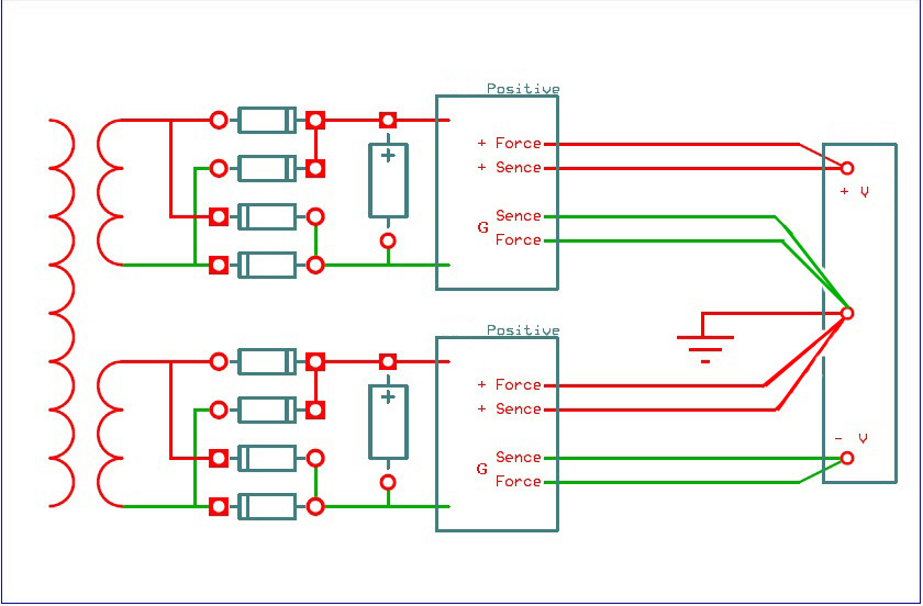

Thanks, and I have another question, is it possible to use 2 positive Reflektor to create a dual rail supply, by having separate transformer secondaries and rectifier bridges, like in the attached schematic.
I want to use this to power a Kuartlotron buffer by Keantoken.
Thanks and regards.

When stacking same polarities to dual its like when stacking batteries. Arrange the Kelvin wiring like in the attached drawing. You may use more LEDS and smaller trimmer value to have the best part of the 10Vout made up by active parts.
