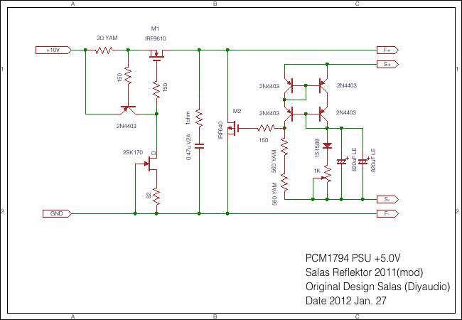

Will need a little advise from the expert.Lookie lookie, my first reflector powered up, and a little adjustment at the pot, it was dead on 5V, so happy Will swap out the Bib with this later for a comparision.
The reflector has been working flawless for 6 months, but when it is compared to my BiB 1.1, I always feel the high is not as crisp. I think I can use some expert advise here. The circuit is based in the a variation of the 5V as in the attachment.
The major changes (as of now) are:
1. The Zobel Cap (C5??) is a 34nf Mica instead of the 0.47uF
2. The 2 x 820uF is replaced by a 2700uF bypassed by a 0.22uf Epcos polypropylene.
3. M2 is IRF610 instead of IRF640.
4. The 2 x 560R are replaced by 1 x 1150R.
Any suggestion to components change to try? The load is no mor ethan 75ma, and the CCS is set to deliver approx 250ma, and the output is 5V.
Thanks!!
Hiw does this look? I have the devices in hand for quite test? The Ciss is somewhat high, and Crss is not as good as MTP3055VL.The lower the Crss and the higher the gfs the better.
Thanks!!
Salas
It is no kidding. Just 2 seconds in the intro, I knew the man's guidance was what I had been seeking for the last 3 months!! I have been using the IRFBC40 in my capacitor multiplier a few times but never even thought one second that was what I needed
I am still in denial of how a recycle (yeah, I recycle it from a broken computer power supply) device can provide such dramatic difference!! Even at this early stage, I can say the reflector is at least as good as the BiB.
FWIW, this devices does have lower Vgs than the IRF610. I think it is around 3.7V. So, I needed to adjust the voltage upward. Otherwise than that, it was pretty much clip and solder affair.
Again, thank you, Salas!!

The STP/MTP are in my Mouser shopping cart. So, they will be in my next order once I accumulate enough to commit.
One educational question, why BiB doesn't need a high Gfs shunt device. The irf9610 is pretty low, but it works just fine in the BiB. So, is the choice of the shunt devices a function of the error amp topology? The current mirror requires higher gain device to work wth?

There is the IRF9530 in the shunt position officially designated for BIB not the IRF9610.
The reason that Reflektor appreciates better more transconductance in M2 is that it does not have an error voltage amplifier to push it but a mirror "bridge" instead to tell M2 how to current compensate the voltage output to Vref balance. So M2 has to listen easier, needs be sensitive. Its a simpler elegant notion and has no strong phase consequences.
