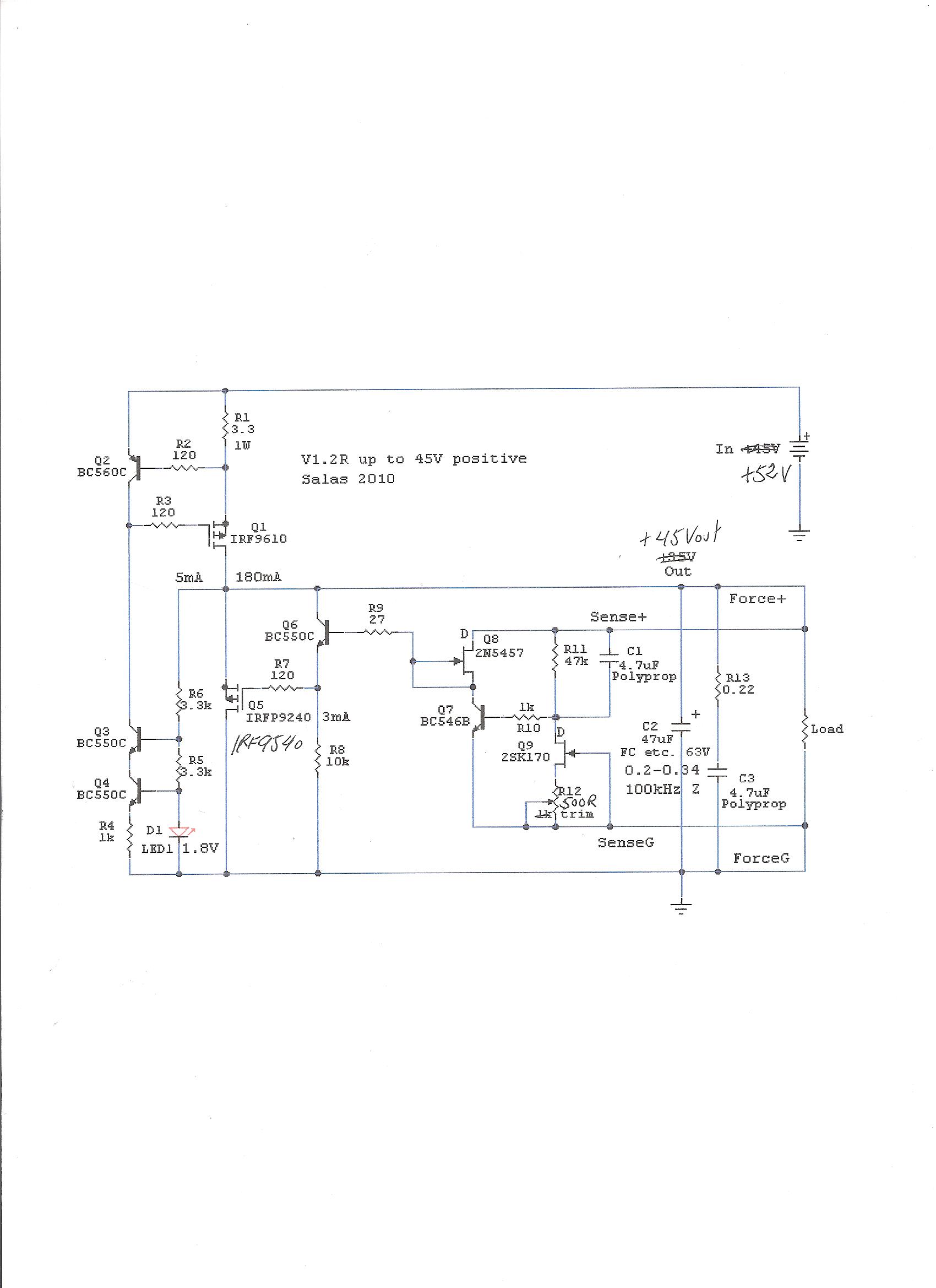

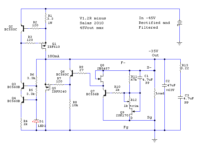

I need to have -45Vout, what have I to change?
salas isn't around for a few days, you'll have to be patient.
swap the semiconductors for their complementary parts.
9610 >610
9240>240
bc550c > 560c
bc546c > 556c
Then turn around (invert) D1 & Q8 & Q9
swap C2 around.
swap the +ve & -ve power leads.
All the regulators can be changed in polarity by applying the same swapping rules.
The PCBs can be used for either polarity.
The -ve regs should be slightly cheaper, certainly the parts are more readily available.
There may be a slight increase in performance due to all N channel FETs being used.

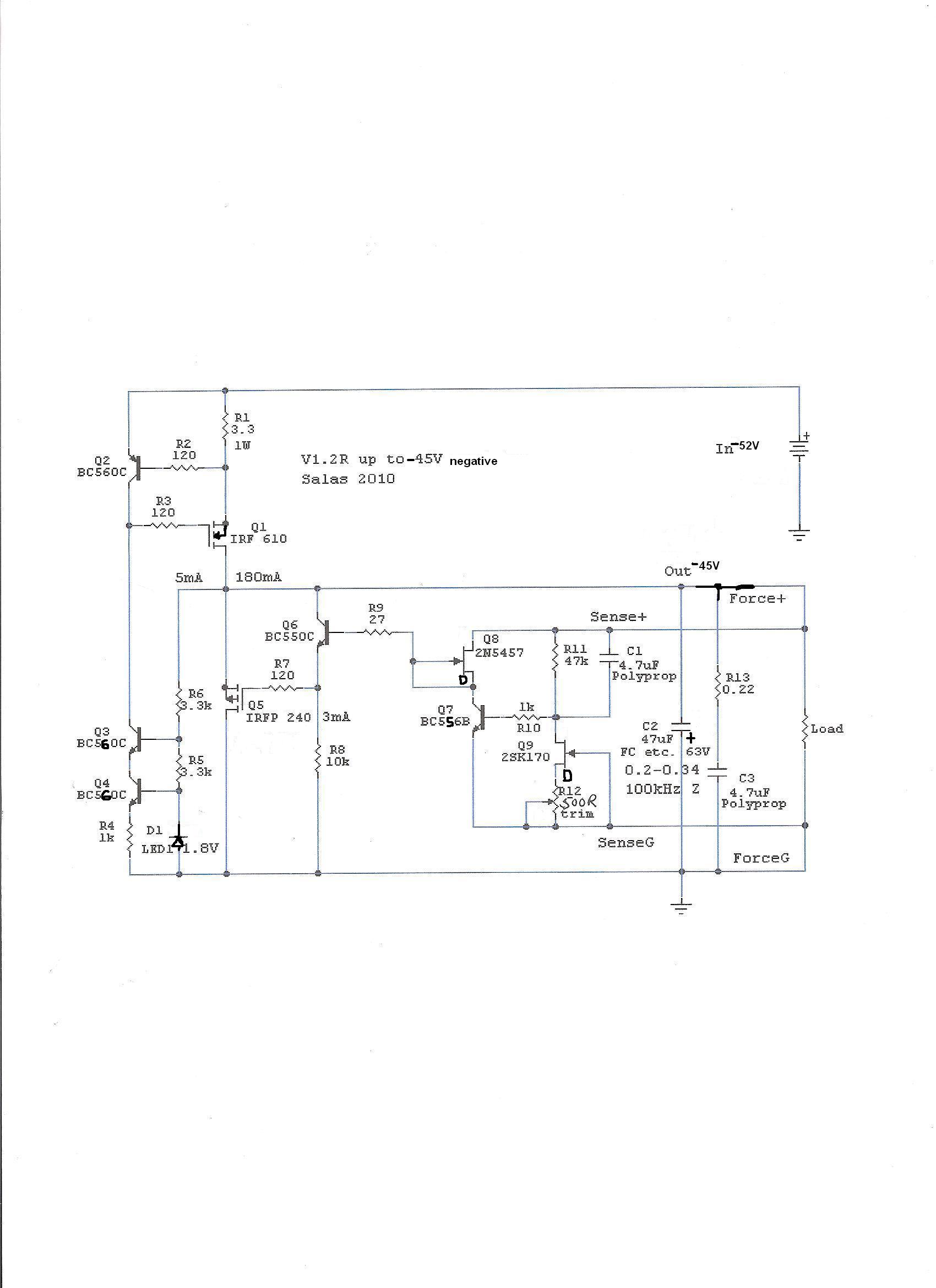

Like attached pic?
The shunt part can be used without any component changes, just switch the output and ground nodes, and use a negative CCS.
