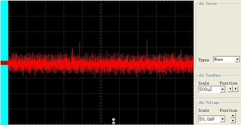

Last night I tried to measure the vout of the 1.2R for TCXO, and it shows severe oscillation! I thought it was the oscons, so I replace them with Panasonic FM and removed the 0.1uf MKP. But, it still oscillates... I found the oscillation was due to the TCXO or OCXO. If I power my reclock circuit with the same 1.2R board, it does not oscillate. I even tried the IRF9530, but no help at all. Is there anything I should pay attention if 1.2R was fed into an XO?

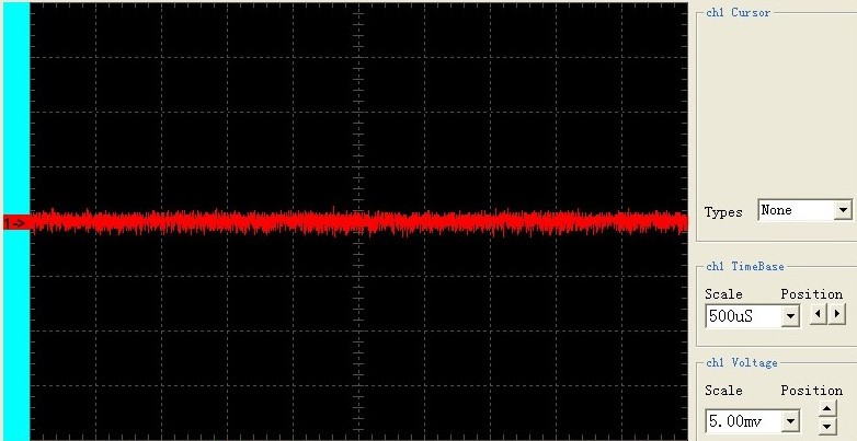

@canvas
your shunt regulator is NOT oscillating, power supply lines are modulated by your clock :) NO regulator will anything at those frequencies, your best friends there are capacitors. Small SMD capacitors, not big through-hole ones.
Bypass, bypass, bypass,....use different sizes & combos, multiple bypasses,... short loops, each milimeter of wire is important (1 milimeter = 0.0394").
Bellow are pictures of similar situation, before and after using multiple bypasses. Put attention on voltage scale, 50m/div and 5mV/div

I don't know about what can be kicking or not with such a reg and crystal oscillators, I have no experience. Enough here have used on digital circuits maybe they can give info. Being multiple frequency and so high is suspicious it has to do with the XO box non the less as Storm argued. How does the XO output look on the scope? Is it clean and useful still?
Salas,
The power line is normal (flat) when XO is not connected to next stage. (#1) With clock output connected, power line was modulated (shown at post #3890), and the clock pulse has a bit of ringing. (#2)
Vout was bypassed with SMD 0.1uf, 0.01uf & 22pf, each with SMD bead connected. (like L-C-L-C-L-C) I guess 1.2R not suitable for XO?

diyAudio Chief Moderator
Joined 2002
You managed to get Vrms modulation much lower, scale of 10. Stormsonic showed similar. I really don't know if you can have zero and with what supply. Unknown territory to me the clocks and their demands. You got to test some regs and scope for best clock and line modulation I guess. One sure thing I will not know to explain is if you tell me ''I found best scope traces with X psu but now I don't like the sound''. :) Wishing you best findings.
