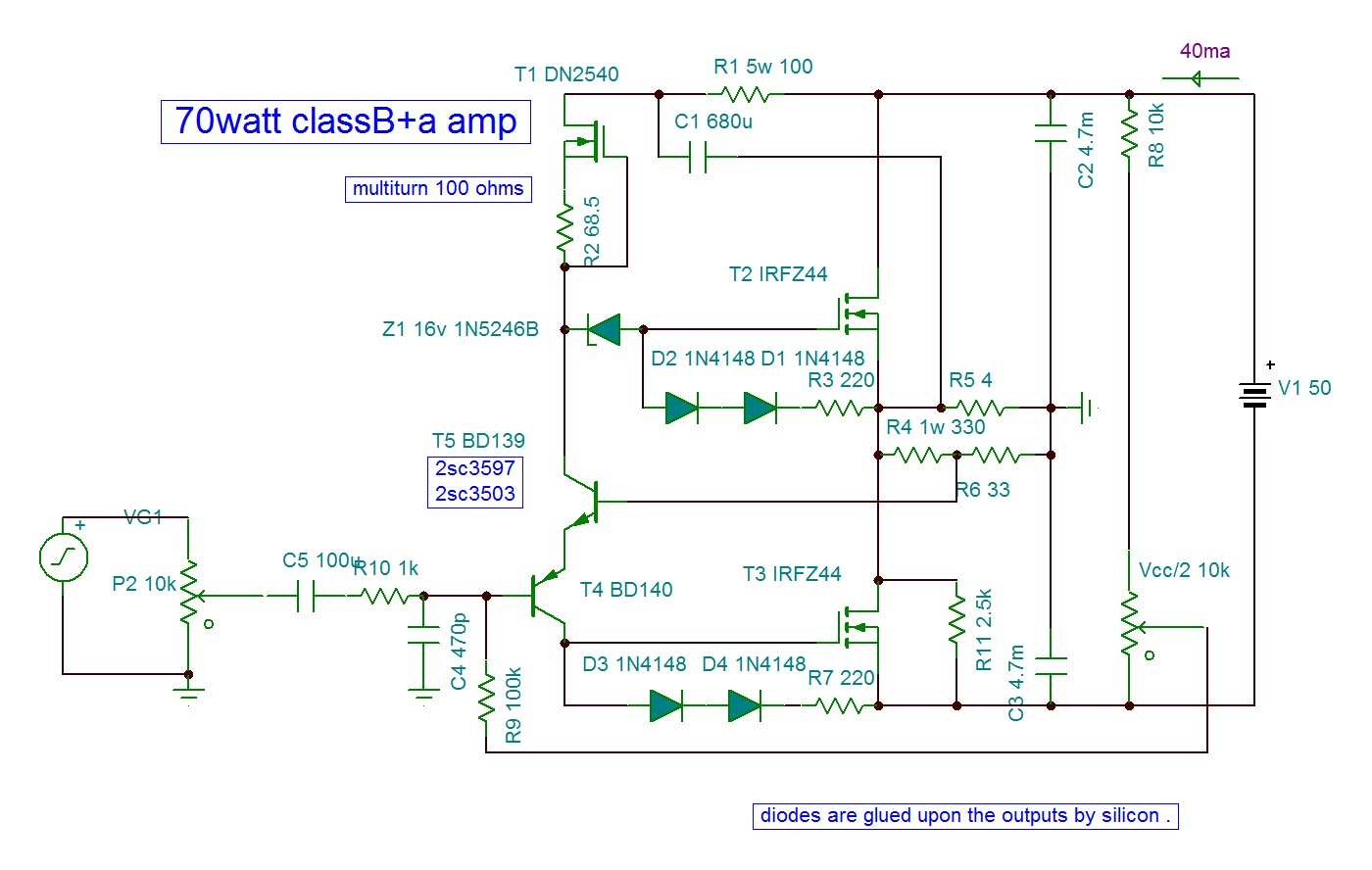

788028d1571182536-classb-mosfet-amplifier-class-jpg
This is my circuit I used for trials.
With BD transistors which have very low Re, It has enhanced dynamic sound. I replaced the feedbacking one with a mosfet IRFBC20, I got the sound with enhanced high frequencies as if the treble control is set to 3 o'clock, although the frequency response measured flat. To try out higher gm mosfet but being low voltage, I mounted it in cascode with a common base. This time I got it even much higher enhanced high frequencies revealing in the music sounds I never heard before, always with flat response.
I replaced the input transistor also with a mosfet, all the magic disappeared, but puting it in compound Darlington with bc337, I still have the high frequencies dynamical expansion but only at very high frequencies as if I used a graphic equalizer with 16k max and the 8k +6db. As I left home a year ago, the experience remained unfinished.
