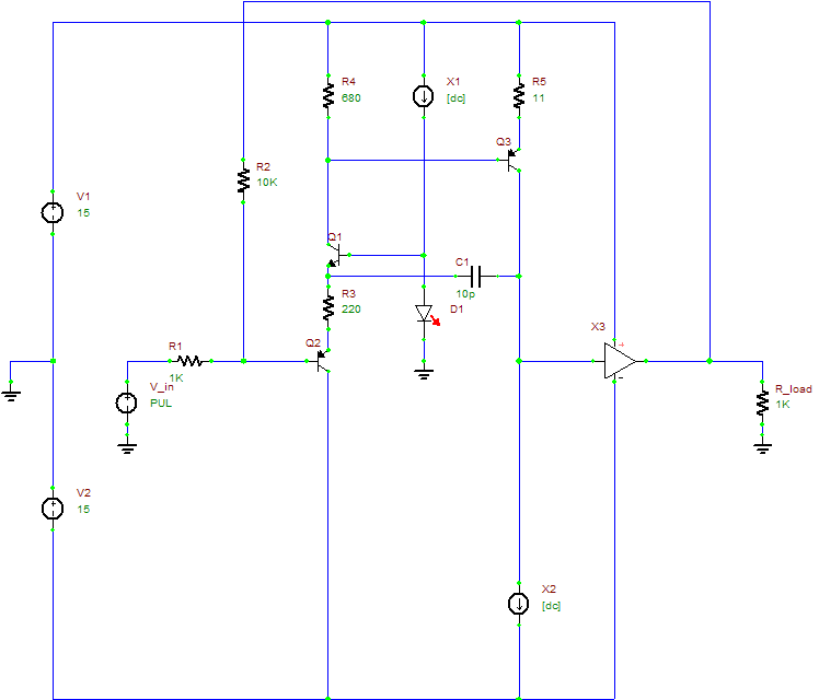

Attached are some ways I have used it in the simulator.

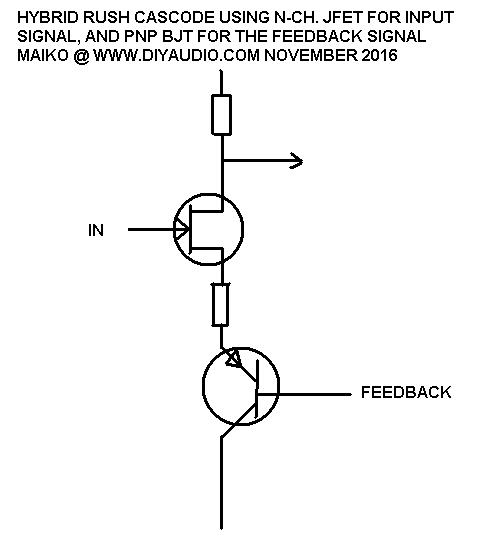

Also, a Rush Cascode could probably be made up of a hybrid mix of different types of gain devices, for instance a N-ch JFET input, and a PNP BJT for the feed back.

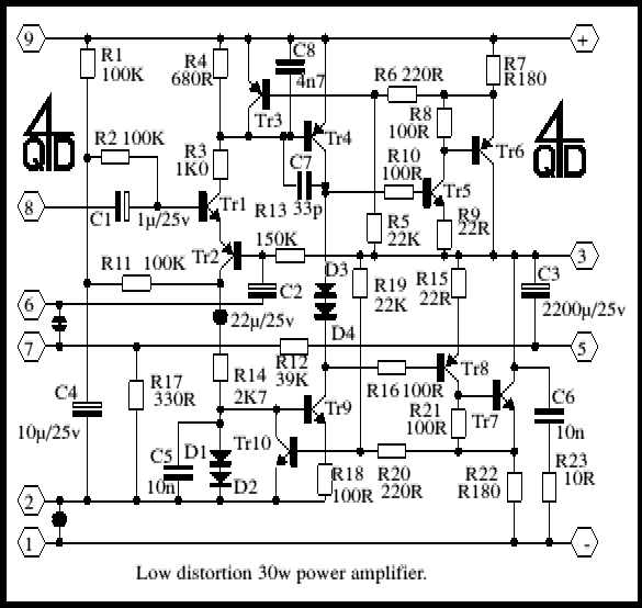

pic.1 4QD-TEC: Low distortion Audio amplifier
4QD-TEC: Electronics Circuits Reference Archive
Low distortion (0.02%) audio amplifier, circuit is dated January 1977

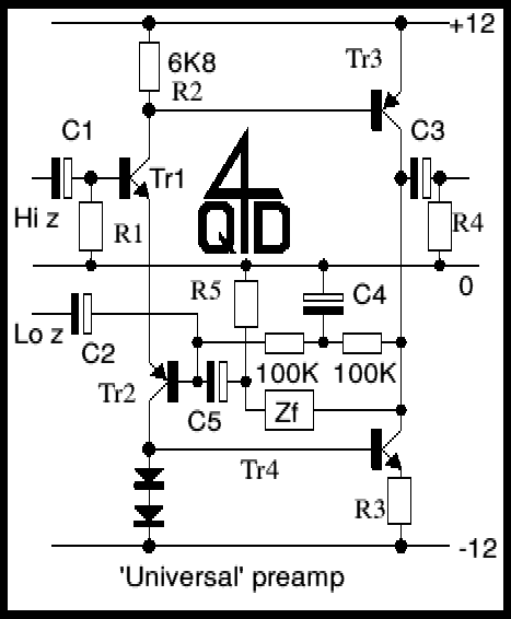

pic. 2 4QD-TEC: Audio preamplifier circuits
Simple to use it as a low impedance mic amp or as a high input impedance preamp for mic or, with a suitable RIAA equalization, for phono pickup or similar.

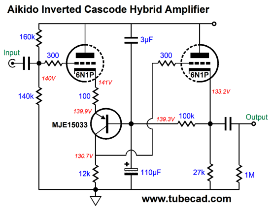

pic. 3 https://mrevil.asvachin.eu/amp/topologies/rush/
A simple Rush Cascode input stage

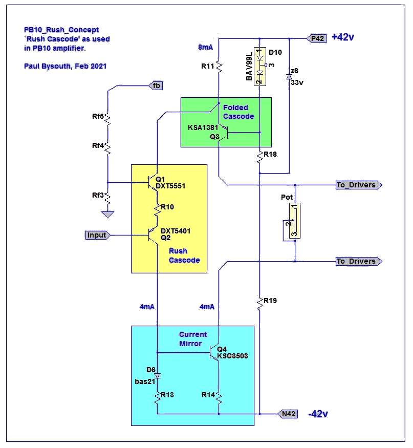

I have used the `Rush Cascode' (and I know it's not really a cascode - but that's what it's usually called) in a few amplifiers, and I think it is a very useful circuit.

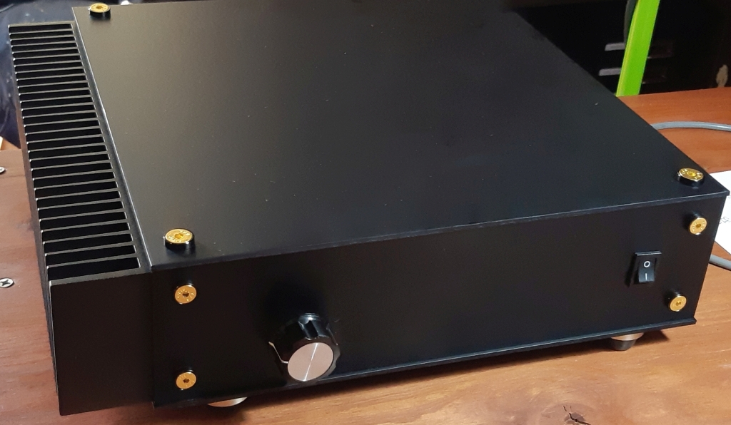

Recently I built a small 60 watt amplifier (called PB10) that uses a Rush Cascode to produce a balanced VAS drive - see the attached concept drawing. I use both sides of the Rush Cascode (yellow) to drive a folded cascode (green) on one side and a current mirror (blue) on the other side. The input was a simple gain stage, and a dual die lateral mosfet output stage, with no overall feedback. A picture of the finished amp is attached.
I find the advantage of the Rush Cascode is that it is strongly second harmonic dominant, and has very low odd harmonics, which is what I like. The PB10 amp is about 0.005% THD and H2 dominant at all frequencies and power levels, which is what I was aiming for.

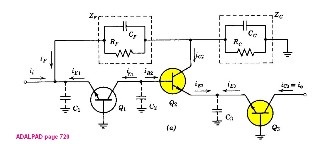

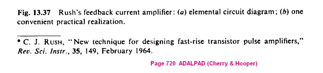

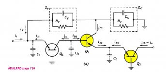

I have some vague memories of Ed Cherry taking about Rush Cascodes, so I went looking in ADALPAD (Cherry & Hooper book), and found some references on page 720 - see attachments.
Paul Bysouth

The Sziklai patent in 1959 quite authoritatively however dons it "emitter-coupled pair". So is it then that the truth been known since 1959 and we poor fools are just too proud to submit to a higher authority?
I came through my electrical engineering degrees hearing this called an emitter coupled pair, and I was first introduced as the input stage of a LM741 op amp. There, it is used differentially and as a composite transistor wired as an LTP (long-tailed pair--I hate that name for a differential pair).
The reason (and this is the general reason for ALL weird topologies in early op amps) is that the IC processes severely limited the quality of the transistors on the chip. In LM741 days, the PNP transistors were absolute crap (low, low gain), so you could not use one for the input pair, nor for the VAS. In the LM741 scheme, the emitter-coupled pair makes for a NPN input (high beta) that acts like a PNP. Then, a high-beta NPN can also be used for the VAS transistor.
So, bottom-line, it's an emitter coupled pair.
