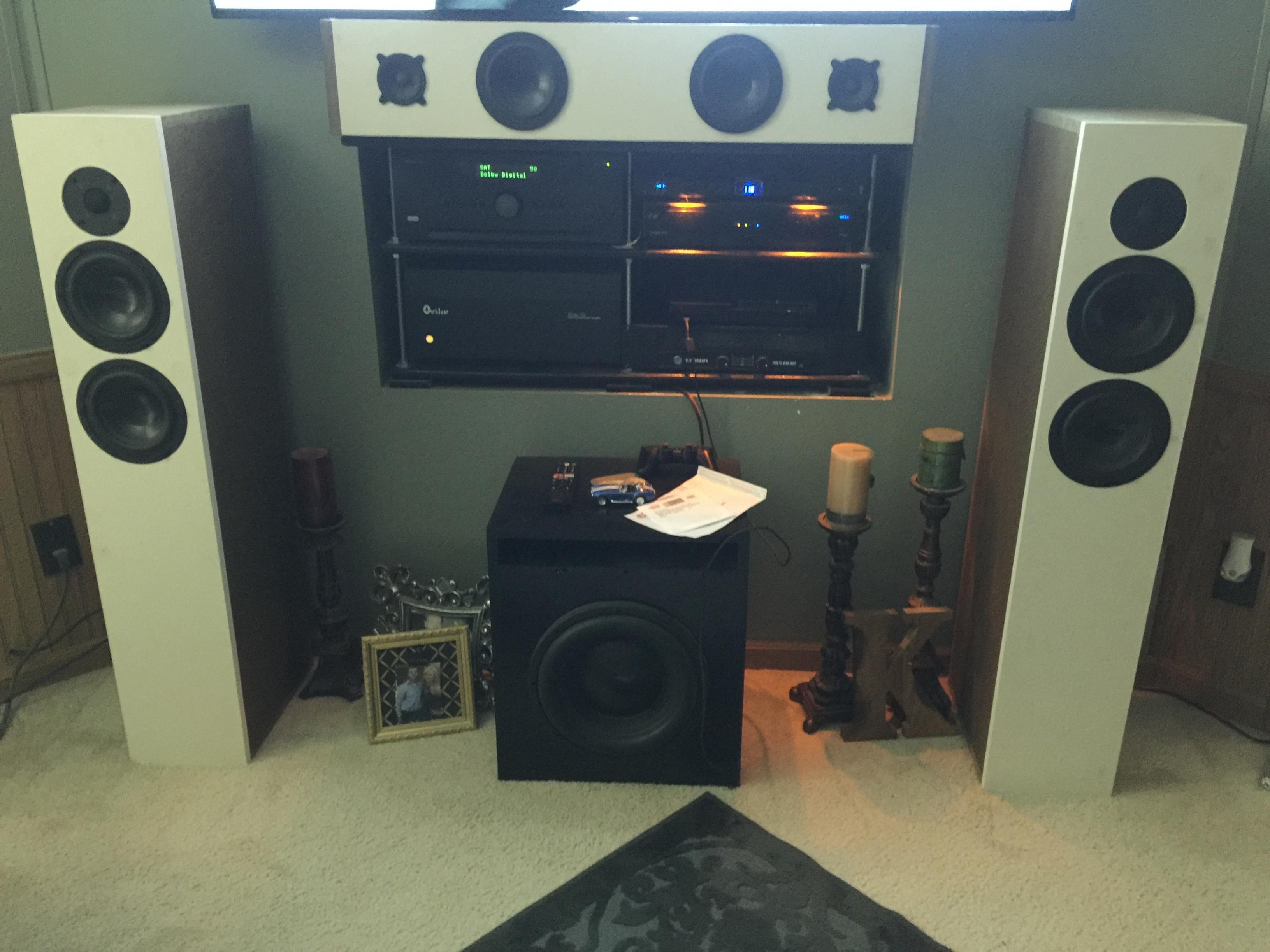

My Renditions and Anarchy 558 center channel with a Stereo Integrity RM-12. I need to build a new sub box to match the rest of my speakers, but now I can run the Dirac Live on the Arcam AVR390, and get everything dialed in a bit.
Good job on the builds, perhaps add plastics laminate to the sides, they make through color products which can be ordered at HD.
https://www.formica.com/en-us/products/ccore
You like a lot of bass! What are your listening impressions on the Renditions?
I still have have mine, a passive pair and 3 more for a active setup [lost some bass, but overall I like them better for HT] Last year,,, I went crazy and built a stack of them lol
The 558s
I looked on the web, didn't find much on the 558s, other than a 5.5" woofer and 3" full range. Some curiosity on that build.
