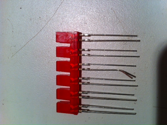

I read SYs excellent RLD amp article on the SYclotron page several years ago, really more interested in the regulated screen grid ideas than the LED cathode bias. It was early in my journey and I suppose I just didn't "get" the benefits of a low cathode impedance. I'm fooling around with an EL84 project now, and want to build it as a RLD, so I went down to the local junk shop and picked up some LED samples.
So check out this 6 pack of LEDs! Perfect, no! They have RLD written all over them. So imagine my utter disappointment when I measured dynamic impedance at 13.7R per each.
I did pick up a NOS pair of 829Bs for crazy cheap so I will stop complaining forthwith. And I did find some LEDs that measured 5R.

SY may have a different view but I would not get too hung up on the higher dynamic impedance LEDS. In fact they may actually work to your benefit. There is some opinion that a small common impedance in the cathode circuit (typically up to around 40 Ohms for EL84 pair) helps reduce odd harmonic distortions and intermodulation distortion by introducing some common mode feedback. I use a common 39 Ohms in my PP EL84 Amp but unlike the RLD it is fixed biased and Ultralinear. I don't have the gear to quantitatively prove this, but my ears suggest that it is right.

And there is another factor I didn't mention. These LEDs run from 2.1 to 2.2 VDC per each. I'd only need five to get 11 VDC which is something of a mitigating factor. I'd like to keep the trimmer pot which can eat up about a half volt so I could live with the result.
I might still use these. It appeals to my laziness (Although I grant you these things are difficult to measure, I'd wager I'm easliy half-again as lazy as SY has claimed to be)
And too, the package was born for this use and would be both a space and time saver, not to mention neatness points.
