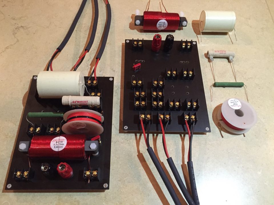

The boards are manufactured by Mundorf.
Just saw that you do not have the latest version XO.
There is a coil added to "shave" the 10kHz peak.
If you need more info ; just let me know.
In my room : L 6,2 , C 33 , R1 5,6 , R2 2,7 and coil 0,22.
but you always have to tweak for personal taste & room anomalies.

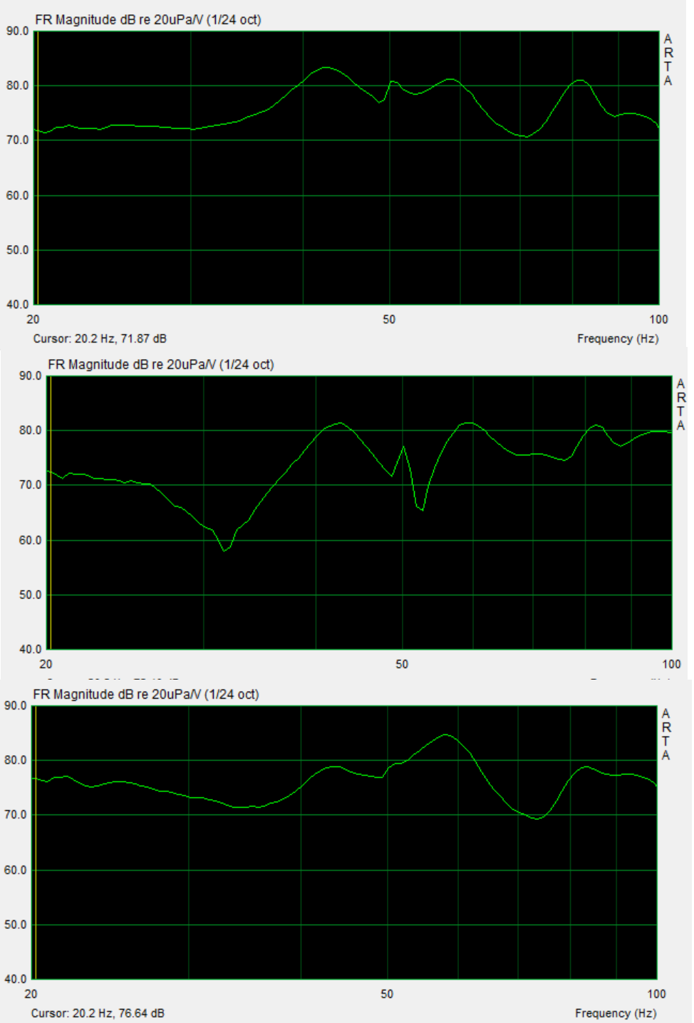

Attached is a picture of how my subs perform in my listening room before any EQ is applied minus the LT and high pass.
As can be seen all three tend to the same at low frequencies, that is flat without room issues. IT appears that my room is modal a little lower than the 40Hz I mentioned before but that 40Hz spike is insidious as it creates and is responsible for one note bass. All three subs and both main loudspeakers excite it too!

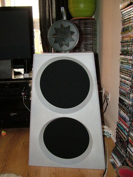

Hi Dave,

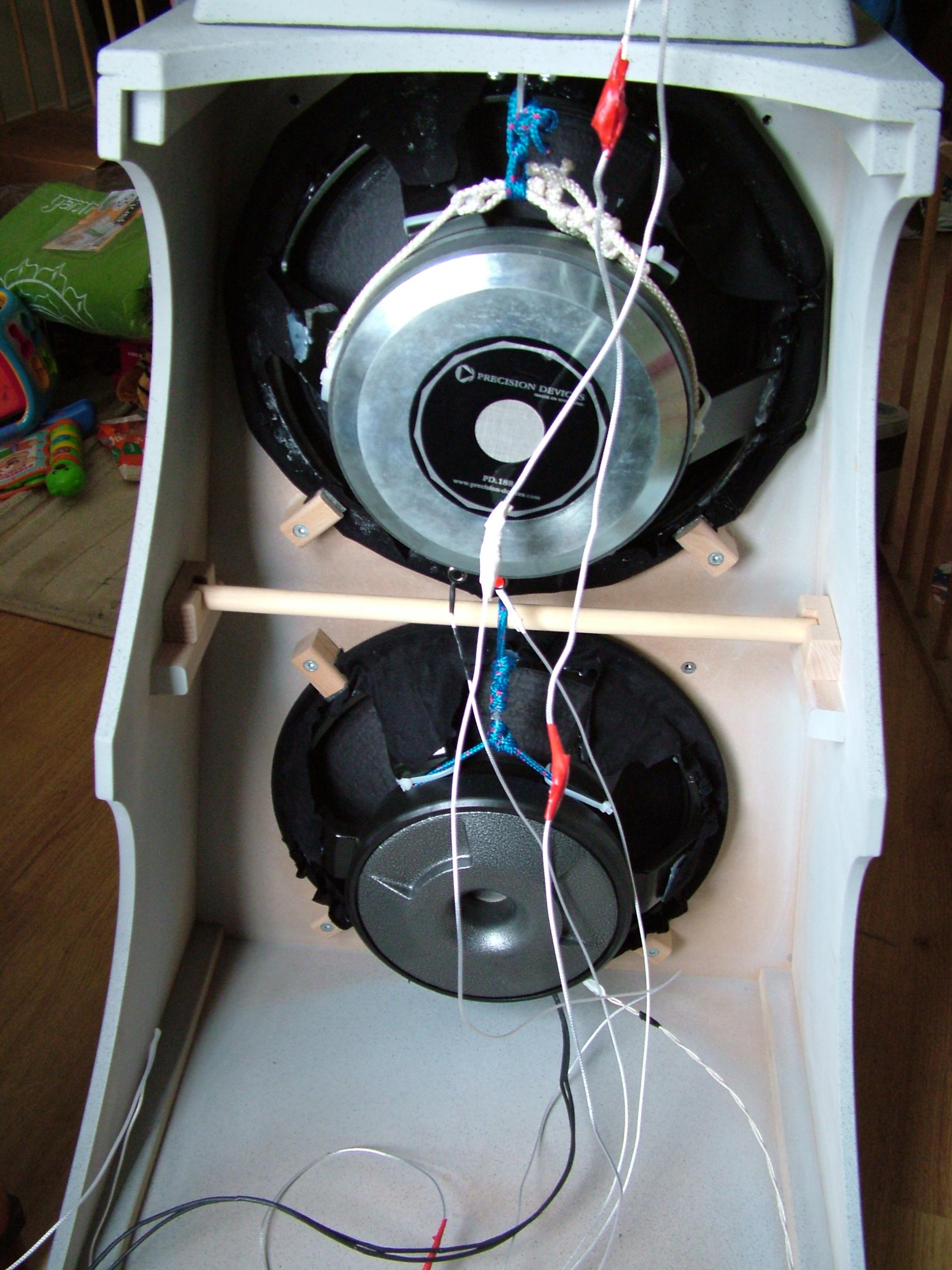

I built a few open baffle designs, I used a Variable Path Length (VPL) baffle and sides to give an effective baffle width of 1.7 meters for the bass, which tapers down to700mm for the low midrange.
Using Beyma and Precision Devices 15 inch drivers, suspended on poly prop rope and lightly sealed with sorbothane gaskets and wooden dowls to avoid vibration being transmitted to the baffle, I got the best quality bass and low midrange I have ever heard....
I coulnt get the power/ extension / high SPL's I wanted for music, and nowhere near what I wanted for home cinema.
But, if you have the room and dont mind big ugly boxes out in the middle of the room OB is the best quality bass and low mid solution.
Hope this helps and all the best
Derek.
VPL
Hi Dave,
Yes I am a bass head...!
The thing with good open baffle bass and low midrange is that when its soooooo natural and low distortion you just keep wanting to turn it up....!
Its very addictive and you can see why Stig Erik got so hooked he went up to twelve 18 inch drivers!!!
As im sure you already know, the bigger ( broader and or taller) the baffle the more extended the bass.
Big baffles are ugly, so folks made narrow baffles with deep sides, effectively a folded baffle. In fact some guys actually use hinges and keep it narrow when not in use (or the wife is home!) and then fold out the "wings" for serious listening.
The down side of deep sides is nasty standing waves in between the sides, plus , a very deep notch or step at the frequency which corresponds to the wavelength of the total effective baffle width.
It comes down to the basic path length of sound travel where the back wave curves around to meet the front wave.
This tunnel resonance / baffle step sounds cuppy / muddy and unnatural.
So all a VPL is is a way to "stagger" the step ie Vary the width of the baffle, which in turn varies the path length of cancellation....VPL .
Derek.
