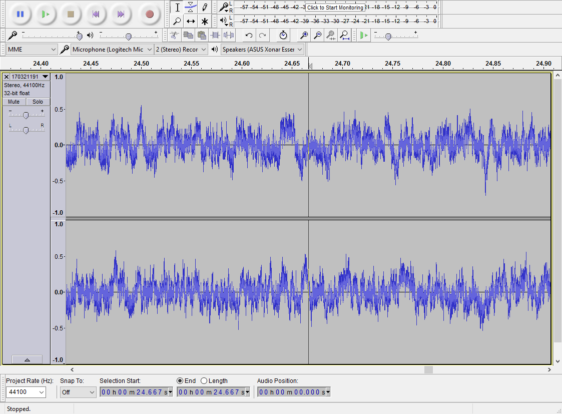

are the spikes at 60Hz, 120, 240, 360Hz etc?What are the frequencies of the spikes?
The odd harmonics are usually dominant, but if I read that correctly you don't have odd harmonics, only evens.

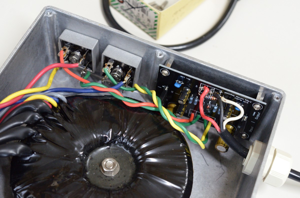

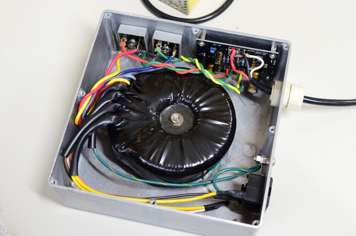

Yay, fixed my hum issue. The LED in the power switch borrowed power from the diode bridge output (the ~+12V side). Probably something with the switch itself but it was feeding back into the circuit. removing that connection cleaned it up a ton.
Now my LED is powered off of the mains with a simple series 50Kohm resistor and a diode (parallel reverse polarity).
ahhh, finally. I knew it had to be something stupid too. A few pics of it buttoned up. I wanted to laser etch the faces like I did my integrated amp project, but ran out of time lol.
Anyway, thanks for all the input guys.
This is my now-regulated power supply. Output is +11V -11V courtesy of a single Z-Reg board.

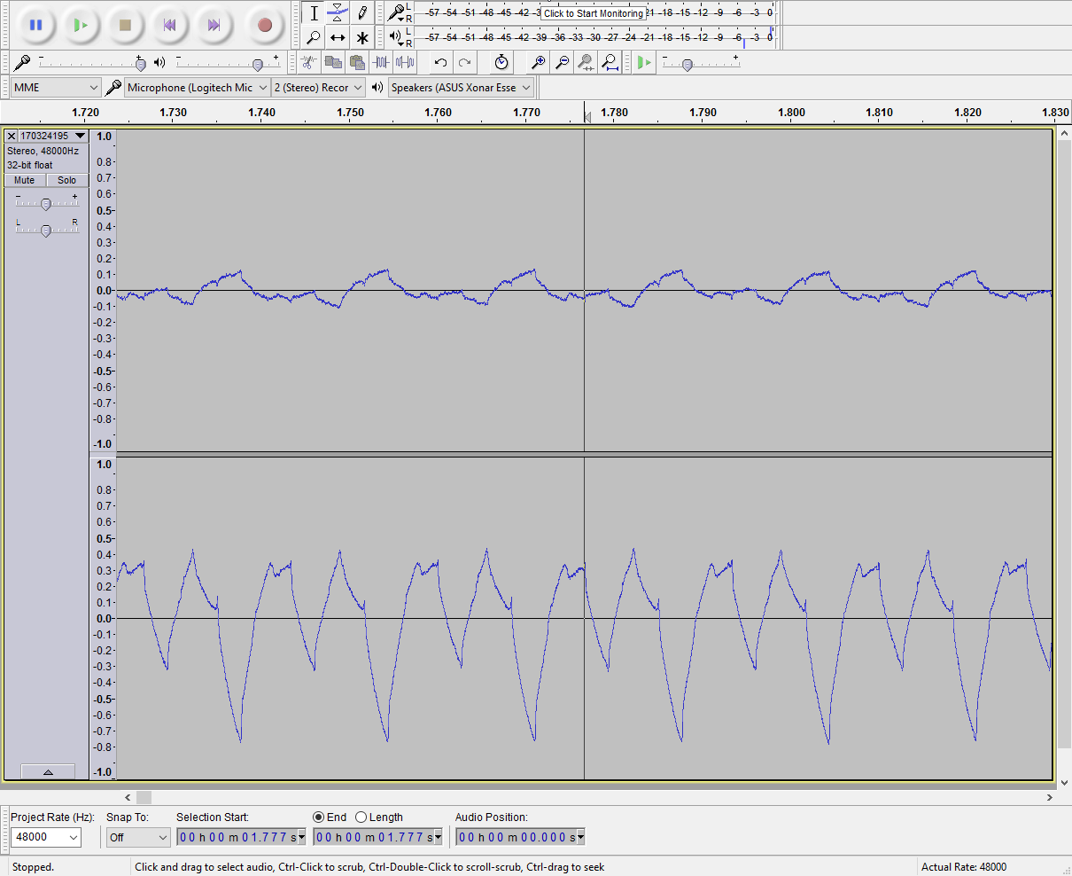

Well, that worked nicely. Fronting the S-Reg with a Z-Reg-equipped power supply eliminates all ripple and hum from the phonoclone output.
So the final report is that the noise was interference from charging currents flowing in the S-Reg being picked up by the phonoclone input section. It was not a ground loop or a board error per se., more that the the S-Reg is not a good choice for the application - not by itself at any rate. It does not handle the input ripple gracefully like a series circuit would.

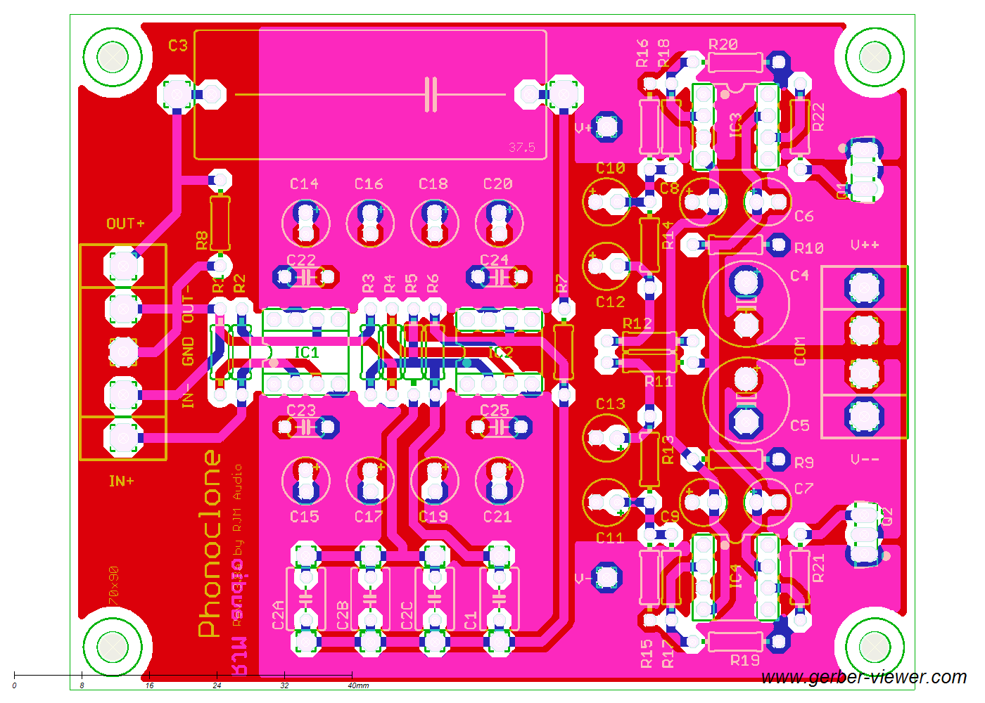

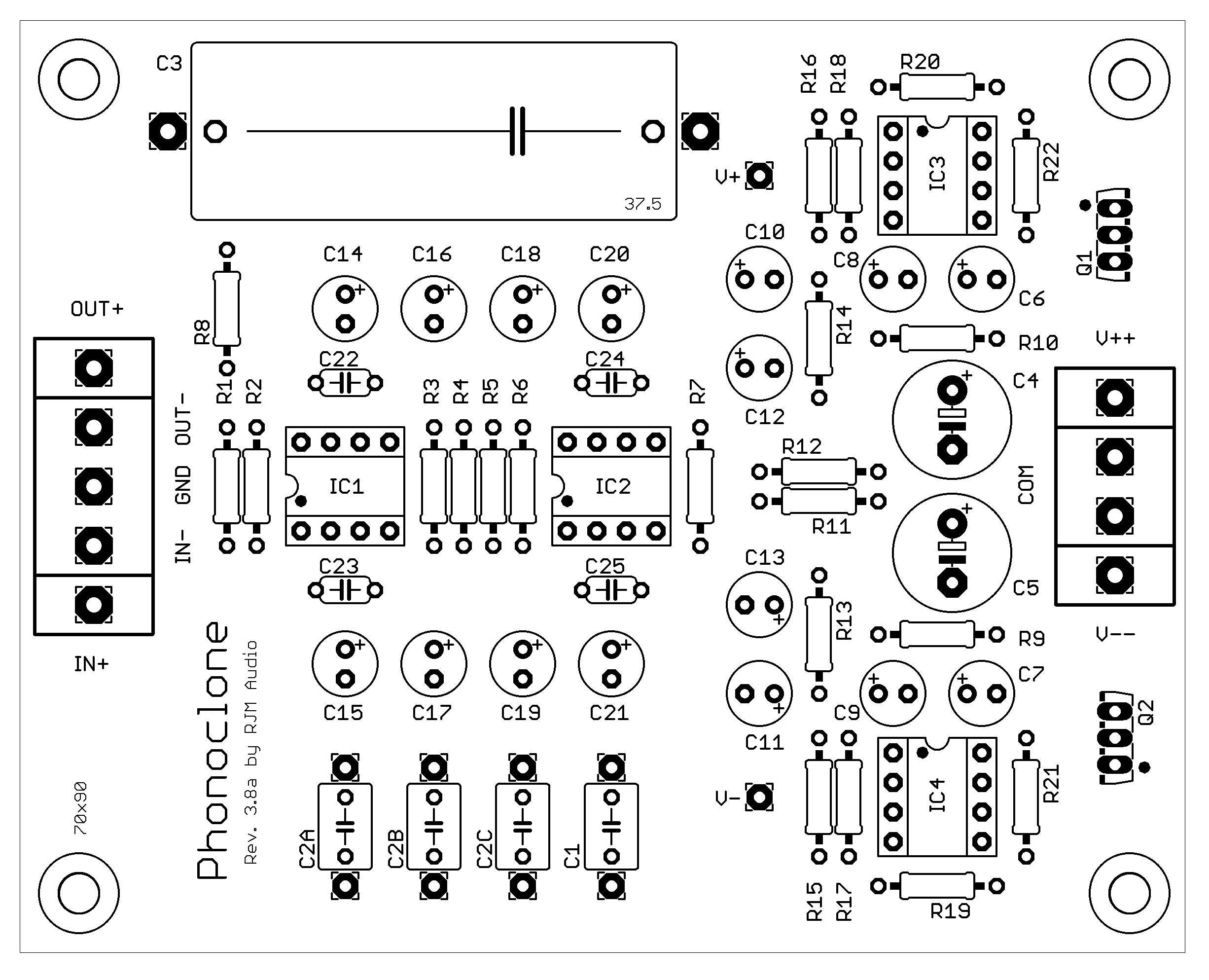

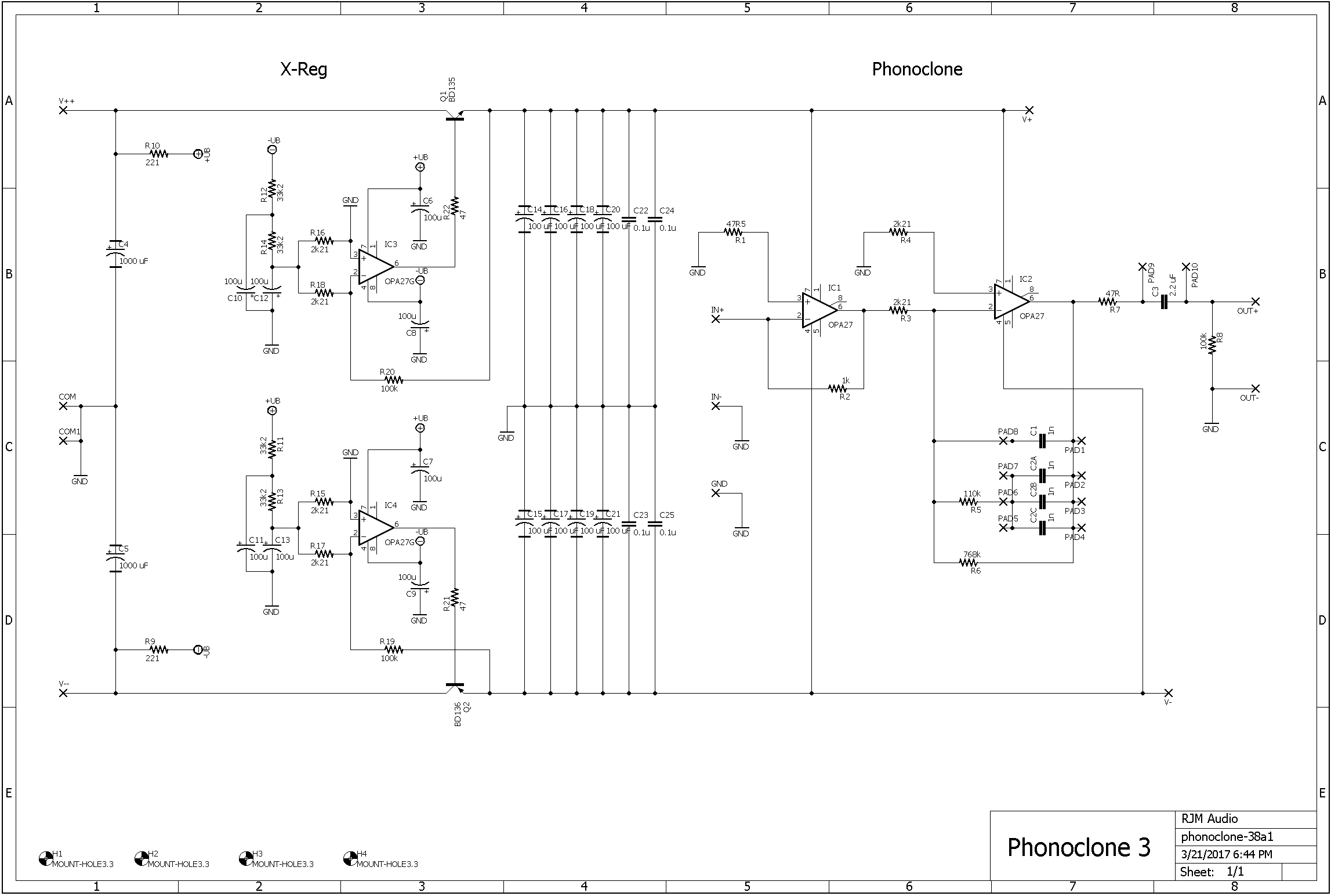

My recent work on the phonoclone 4 has been folded back into a new version of the phonoclone 3 (3.8a) which is directly based off the 4.2 layout but with the X-Reg in place of the S-Reg.
3.8a has some considerable improvements in the phonoclone layout (fingers crossed... ) and the X-Reg has also been completely redone. The BOM has been tweaked so the X-Reg uses standard resistor values now instead of those oddball 75k and 30k values.

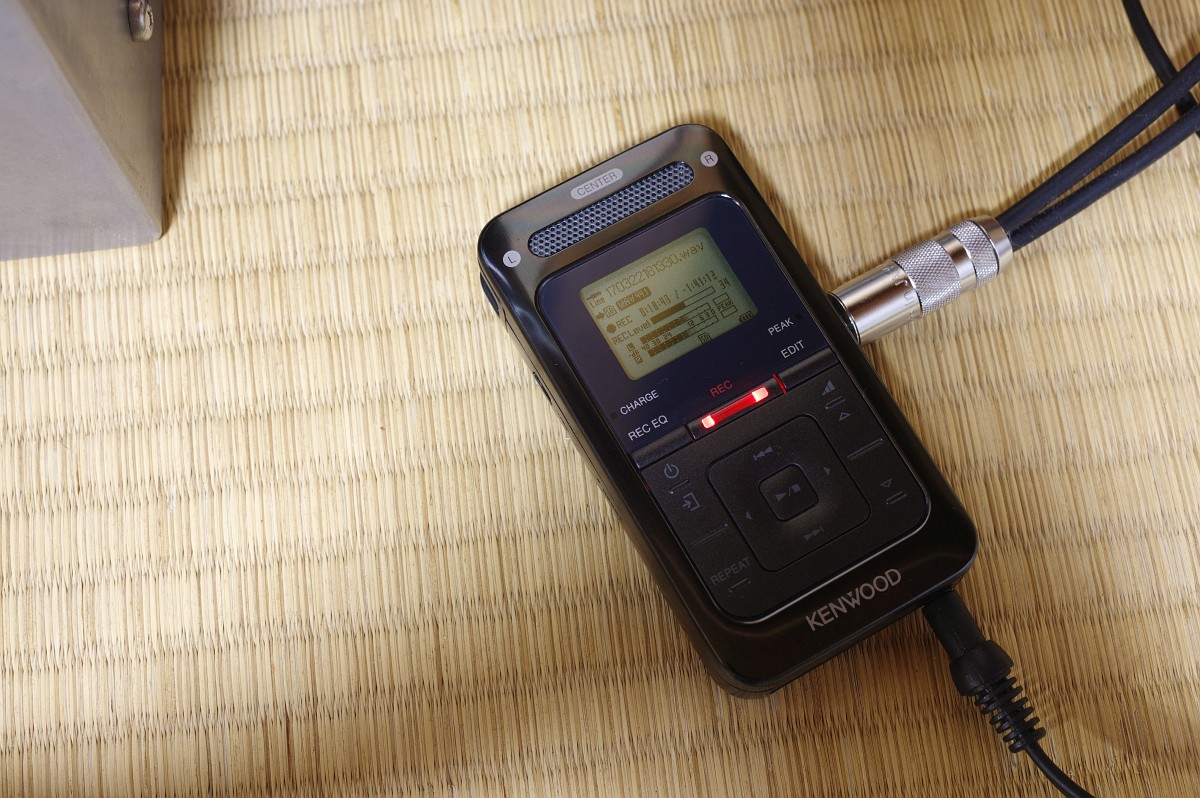

No takers? I'll go first then:
1. The Kenwood recorder gives an authentic representation of the tonality of the analog chain, with very little loss of overall quality.
2. I've back-and-forth compared this a couple of dozen times and can barely sense any difference between the two power supplies. Which is to say I cannot hear anything I could attribute to the ripple noise visible in the FFT spectrum.
3. While I have no confidence I could pick this out blind, I do feel that there is a small difference: the unregulated supply sounds more open and dynamic, the Z-Reg version flatter and closed in. So I'd have to say I'd prefer the unregulated supply. This might be do to the distribution of filter capacitance, which now has 1000 uF both in the supply and the phono stage. I'll be tweaking that next.
note the files are 16 bit 48kHz wav. They don't seem to play in the browser but work fine for me if I download them and open with VLC or media player.

I didn't comment because I didn't hear any difference - but I could only play through the audio jack on decent but not high-end headphones. I may try my 32/384 USB DAC but I don't expect much difference there either. With tinnitus it's really only bigger differences that I can make out.
I think you didn't hear any difference because there isn't any difference to hear. I was a bit surprised ... I was expecting more blackness, or more resolution, or more low level details ... but I guess the power supply has passed over the threshold were it not longer limits what you hear. There is no more there to unlock.
