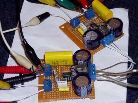

OK busy testing, and ...still no better
What does too little gain sound like?, the breakup is quite apparent at the fading bits at the end of songs (but not limited to this).

While we are on caps, may I ask why we don't use any decoupling caps close to the pins here?

Are the voltages both + and - 15VDC?
What opamp did you use? Do you have another that you could insert into the socket?

Should be fine. Just checking.I used NE5532...
I used the OPA2134 in the low impedance version..still sounded great.
OK, switched over to the OPA chip and suggested resistors...
It sounds better but still very grainy...

Circuit no longer hums, one good thing from the OPA it seems, and the distortionseems more evenly dispersed rather than just in the bass and treble...
Could it be that the REV C is too sensitive for the output of this phonopre...? Would changeing the gain help then?

Nordic,
Your problem is most likely related to the power supply, not the RIAA loop.
The LoZ (or HiZ) versions and 40dB of gain, as you have built, will work fine, and should be stable, with your op-amp and cartridge.
Try wiring the bypass caps directly form the opamp power pin to the signal output. Check that the DC voltage going into your LM7815 and 7915s is above 18-19 V. Check that you aren't using a non-polar cap for output coupling.

Sadly I have no digital camera....
I have copied the layout as provided on http://www.geocities.com/rjm003.geo/rjmaudio/diy_pho5.html
PSU consists of 4 x 250uf caps as per instruction...+.1uf caps just after the regulator. I am getting 24.1V between V+ and V- inputs on IC socket. Also, I am using 7812 and 7912 (not 15) as per instructions....
Not sure about the cap you suggested... do you mean from output pin on the IC to the V+ pin?
Erm why? the instructions says, C3 4.7µ, Output coupling. Must be non-polar......
I got that poly cap in there as per the picture a few posts back...
Just confirm if you mean for this to be an electrolytic.... (I got some NP electros I can use in there...)
Yes, must be non polar, but not a non polar electrolytic!
I recommend a good MKP quality, some WIMA will do the job well.
BTW: why, Richard, do you still use such a high value? The resulting roll off with a following 22k input will be 2 Hz.
You could insert a 1uF cap without any remarkable loss in the bass area. Even with a following 10k stage, you will be on the fine side with 2.2uF.

Ta Franz, will play around with the output cap a bit but I still think there is a simpe mismatch between the VSPS and the REV C, unless I made a stupid soldering error somewhere..
I have now added 10nf from power pins to ground as per datasheet, and added 1000ufd before the regulator...
Not enough..you should get 30VDC between V+ and V-. In other words....around 15vdc between v+ and 0 and
-15vd between 0 and v-
12V rectified gives about 15.xV, which then gets regulated to 12V, I got some thicker wire to redo the ground line with too now... was using doubled up wire for it... as I do notice some hum that increases with volume...
I just put the thingy down for a bit, before it breaks my spirit...
Can it work with only rectification and no regulation? that would give me a few more volt.

Not everyone has a high input impedance pre-amp. 4.7uF is good for anything down to 600 ohms in a pinch, and using the BG N it takes up no appreciable space. As I've said several times before, lower values are perfectly acceptable as the load, size consideration, and availability dictate.
Nordic,
A 2x12V AC transformer is fine. This will produce about +-17V DC, which then regulates to 12V DC after the 7812s.
You've only got 15V DC unregulated for some reason. Depending on the ripple, thats actually a fraction low for the input of the 7812s, though unlikely be a problem ... also its a sign perhaps that the circuit is drawing more current than it should or that something else isn't quite right.

Nordic was talking about the regulated voltage between the op-amp power pins, you were referring to what I call V+ and V- on the PCB, the unregulated input voltage.
