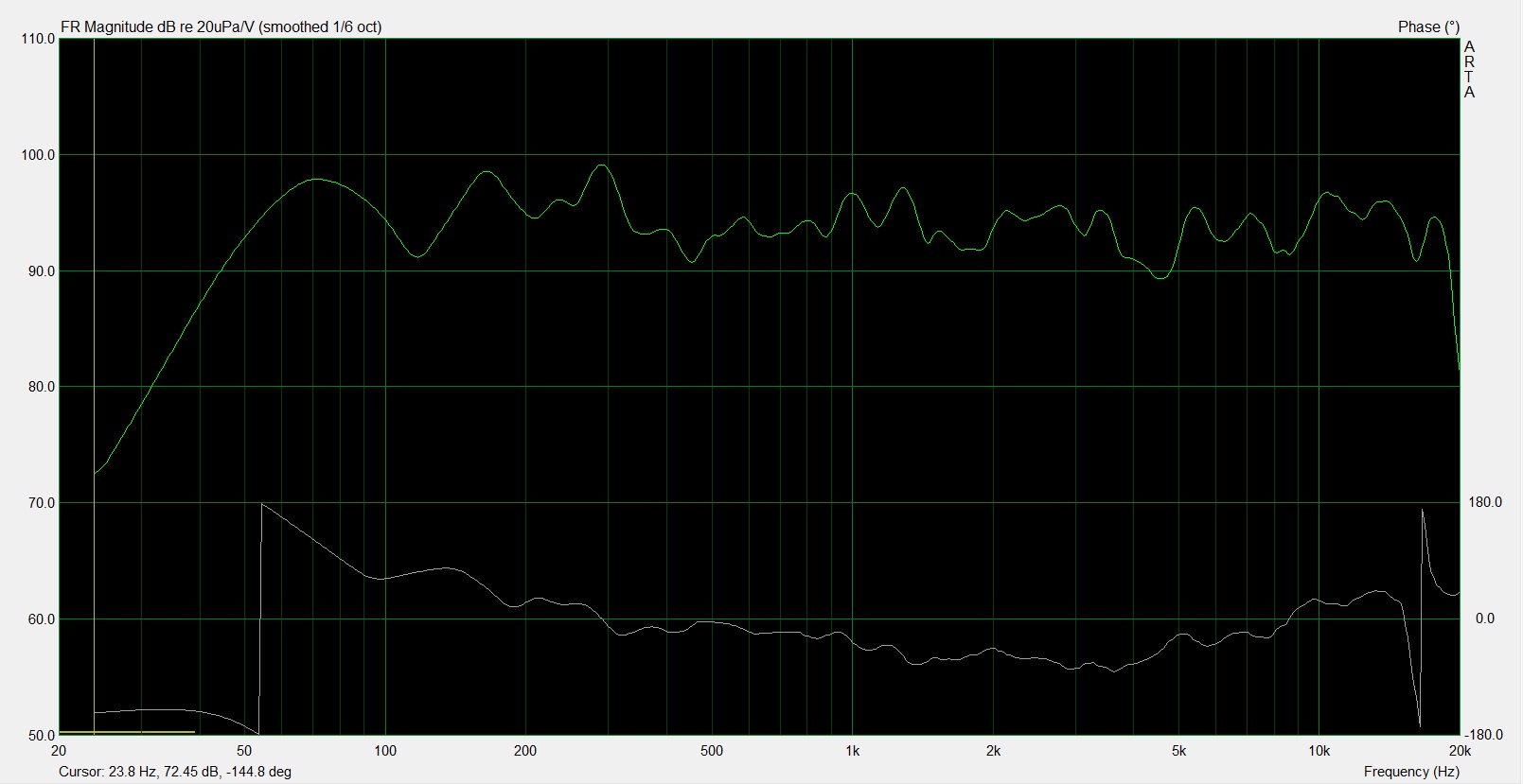

Per the title of the thread, here is a measurement of the same speakers or one anyway, this is at one meter in a livingroom with a bare hardwood floor and no room treatments. The electrical crossovers are around 300 and 1200 Hz. As one can see, there is no crossover phase shift, it looks like one very broad band driver in a large CD horn.
Best,
Tom
