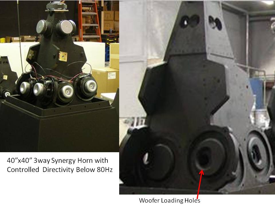

Elias,
Your post helped educate me on why early Altec theater speakers which use a crossover from the woofers to a large midrange horn at around 600Hz-700Hz, going up to 10Khz are so well reviewed, and still loved. New 1.4” compression drivers and new horn profiles are popular today for this bandwidth. The data also helped explain why the poor polar response when a tweeter is added at 10Khz can be an "acceptable sin" to many Altec big horn lovers and even a few golden-ear critics. (Read the WIKI on vocal range below).
SO...SO....
1) ARE HARMONICS KEY? Should we design speakers like the classic Altecs with a constant directivity horn covering 630-10K Hz.
2) ARE FUNDAMENTALS KEY? Should we design speakers with a wide bandwidth midbass that covers the 80-1,100Hz fundamental vocal range?
3) SHOULD WE ACCEPT COMPROMISES TO COVER BOTH F & H? Should we perfect a 80-20Khz Synergy Horn even with subtle horn High Order Mode artifacts. Put 40” x 40” Synergy Horns in every living room?
WIKI:
Vocal_range is the measure of the breadth of pitches that a human voice can phonate. The most common application of the term "vocal range" is within the context of singing, where it is used as one of the major defining characteristics for classifying singing voices into groups known as voice types.
The following are the general vocal ranges associated with each voice type using scientific pitch notation where middle C=C4. Some singers within these voice types may be able to sing somewhat higher or lower:
Soprano: C4 – C6
Mezzo-soprano: A3 – A5
Contralto: F3 – F5
Tenor: C3 – C5
Baritone: F2 – F4
Bass: E2 – E4
In terms of frequency, human voices are roughly in the range of 80 Hz to 1100 Hz (that is, E2 to C6) for normal male and female voices together.
Fundamental Speech frequency
The voiced speech of a typical adult male will have a fundamental frequency from 85 to 180 Hz, and that of a typical adult female from 165 to 255 Hz.
Telephony, and equal power:
Telephone transmission is optimized for 300-3000 Hz since the small telephone receiver speaker can cover this range while also isolating 60Hz/120Hz power noise, and the brain can rebuild a voice fundamental from the upper harmonics. Speakers with 300-3,000Hz crossovers avoid midrange intermodulation (doppler) distortion and power dissipation problems, but they put a xover in the vocal range that is often audible.
