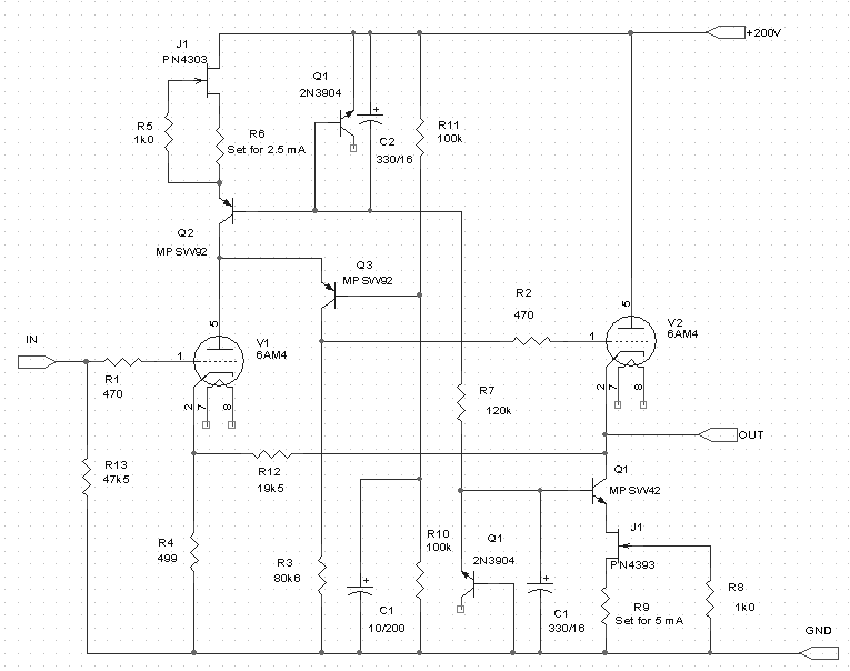

The pre was actually designed to go into my "Ultimate Preamp" project. The mWCF is not really going to be DC coupled to the stage. There will be a cap and the selector switch and volume control in there. I just left it in to do the noise and THD tests as accurate as possible. (haven't settled on the line-gain tube yet, 6N6P or 12B4. Though I may DC couple that into the mWCF after all...)
For a standalone phonopreamp, just leave the 120R||100uF cap out completely.
The 10K tail end resistor's sole purpose is to bleed the static charge off the 4.7uF polycap.

I do have some qq regarding the decoupling of the Ck of the WCF and why a 10K tail end resistor is being used?
Personally, I'd ommit the decoupling cap, up the Rg for that stage to 1M and use a smaller output cap with a 100K tail instead. Unless I'm missing out on something fundamental perhaps?
The pre probably has enough output to drive an amp straight in, ZOut sure won't be a problem if it's a tube amp we're driving, so somewhere I'd like to see a volctrl. Probably best put right at the WCF's input, right?

Hmmm. Interesting circuit. I assume that you've gone for the added complication of a folded cascode in order to get the DC voltages more nearly optimum for the cathode follower? 2.5mA seems rather a low current for the two input devices. In theory, driving a bipolar transistor with a current is a much better idea for linearity than driving it with a voltage, so your hybrid cascode should work well. However, there's nothing like a real measurement, and the exact distribution of the harmonics in the distortion will be important.

I tried your idea, but a simplified version. Works cool
Don't want to retype everything, so here's the new schema and serious measurements:

Regarding the folded cascode circuit I showed a couple of posts ago - lying in bed this morning, I realized that you can't close the loop as I've shown it because it's positive feedback (Doh!). Without the feedback, there's a lot of excess gain. I could keep the current arrangement sans feedback, beef up the top current source, and use a smaller resistor as load for the PNP folded cascode transistor. This would tone down the gain to sensible levels, but would require transistors with higher dissipation capability for the top current source cascode and the folded cascode transistor. I'm thinking a 2SA1535A would work ok. A lower noise JFET for the top current source is in order, too, as the noise gets passed right down into the folded cascode load resistor. Let's sling a 2SK170BL or V in there instead of a PN4303.
As for current through the input tube, I was going on earlier comments in this thread about the advisability for fairly low current in the tube. One could always run a couple more mA thropugh the 6AM8. At 100V plate voltage, dissipation is not a big problem.
Since the output folded cascode now will have a much lower value load resistor (I'm thinking ~ 5K), the possibility exists for just ditching the output cathode follower and driving the RIAA network directly off the folded cascode transistor. The cathode follower can be saved for the output gain block. With this type of arrangement, I could see a tube complement of (3) 6AM4, or maybe one 6AM4 at the input and a dual triode like a 5687 or 5965 for the output stage. Being contrary by nature, I would resist suggestions to use a 6DJ8 or 6922 as being too popular - this is all about lowly TV tubes, after all. Maybe a 6BQ7 would fill the bill.
A remark in passing - one of the advantages I see in the folded cascode approach is the relative freedom you have in biasing the tube, since tube bias current and the current in the load resistor are separate, while the current source supplies both. I'm mining this kind of approach for some sand state phono preamps, too. I'll find out sooner or later whether this approach sounds decent with tubes.
