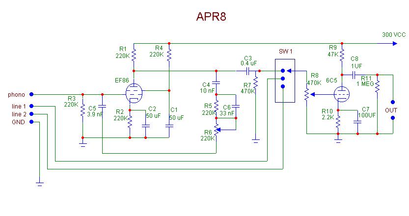

Has anyone tried this phono stage? It looks simple enough but is the 220k resistor on the EF86 cathode a mistake? It seems way too high to be useful.

Here it is, within +0.2dB of the RIAA curve from 20Hz to 20KHz and sounds great! :)
THD of the unit was below my ability to measure (<0.03%) at 1KHz and the dynamic range is wicked. 7mV in at 30Hz could not overload this thing. Great for those 5mV high-output cartridges.
Actually has less noise than the one I made a few years back based on active FB.
3-tube/channel unit, which if incorporated into an existing pre/line driver is 2 tubes/channel. Design goal was tube unit efficiency and to use standard 5% components for easy repeatability amongst the do-it-yourselfer's.
Output stage shown is my modified White CF with an output Z of 100 ohms, suitable for ignorant cable/amp systems.
Have yet to try SY's boosted LED bias idea to reduce their dynamic Z.
Cheers!
http://geek.scorpiorising.ca/contrib/Geek/phono_preamp.gif

I'm still scratching my head over that first stage cascode...
I've used the 6AQ4 in an RIAA stage, although not in cascode as here. The 6AQ4 has the mu of a 12AX7 with about 5 times the gm. This combination offers the potential for a low-noise front end. My quick back-of-the-napkin analysis of this cascode design predicts a low-frequency gain of roughly 600X (55dB). So, if there is adequate overload margin, the signal is boosted up to a large amplitude before the passive RIAA filter loss drops it back down closer to the noise floor. However, overload margin and distortion performance may this design's Achilles heel with so much gain.

Thanks, Greg. What's the overall gain at 1kHz?
1mV in = 0.5V out @ 1KHz.
Hi Brian,
This is a finicky circuit for large voltages in. That's why in the design process, I used the unused portion of f V2 for the second gain stage instead of a 5751. The input stage, as long as you're within phono levels, will be OK. The most critical component for distortion is the cap from the top tube's grid to ground. Experiments showed 0.1uF would be *just* enough. So I made it 1uF poly and listened to the highest-output albums I had on headphones (Zamfir - any non-linearity will kill those panpipes and an older Boston Pops, if the instrument exists, it'll be in there....). Sounded great! :)
So, why did I use so much gain in the first stage instead of distributing it? Noise. I hate noise and the only reason I stayed away from passive pre's for so long was because of that. So, we get the gain with the lowest noise components before the EQ. Problem cured.
There will always be tradeoffs. I swear these RIAA stages are best left to philosipher's and theologian's. I do not have a super high output cartridge here to test a straight ECC88 input. Sure the instruments will tell me, but I design for sound ;)
Cheers!

Agree with Brian's analysis.....
Adding an MC stage may have the preamp run into trouble with a number of higher output carts but I guess Greg's happy with his MM and is aware of the shortcomings of his current pre.
Still, it looks fine if you use it for what it was intended.
I do have some qq regarding the decoupling of the Ck of the WCF and why a 10K tail end resistor is being used?
Personally, I'd ommit the decoupling cap, up the Rg for that stage to 1M and use a smaller output cap with a 100K tail instead. Unless I'm missing out on something fundamental perhaps?
The pre probably has enough output to drive an amp straight in, ZOut sure won't be a problem if it's a tube amp we're driving, so somewhere I'd like to see a volctrl. Probably best put right at the WCF's input, right?
