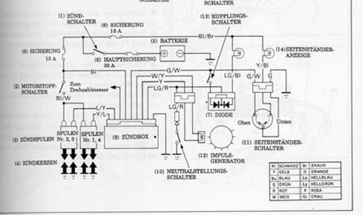

ok - perma alternator , rectifier , reg , cap , DC CDI , pickup , HT coils
That means a 12 V perma alternator, and the CDI gets that up to whatever the coils need trigged by the optical pickup signal in this case?
inductive , hall , optical - whatever is your choice for CDI

say small rotor with magnet tip and pickup coil from any honda
then any DC CDI for 4 cyl , with original HT coils ; they're (at least to my knowledge ) all based on single pickup impulse , and both advancing and distribution are made electronically in CDI
though , I believe Stajo's drek will have plenty of RPMs , so purchasing something new , along with know how , could be smartest thing
