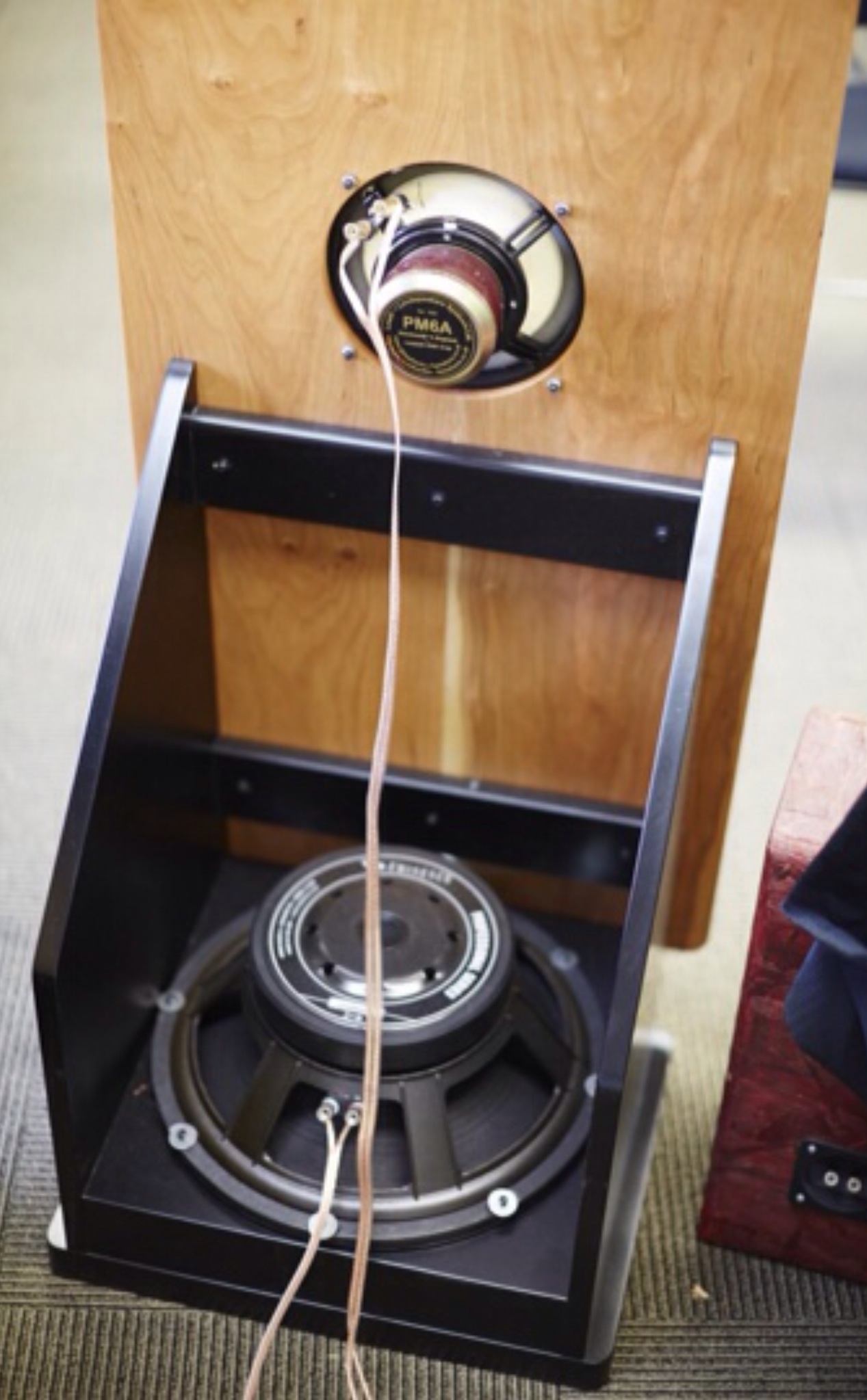

Hi Zen, here's my first large prototype for the bass drivers. Gets down to 1 HZ. Heil AMTs on the lower right. My dear wife didn't want them in the living room though. Open to more suggestions.

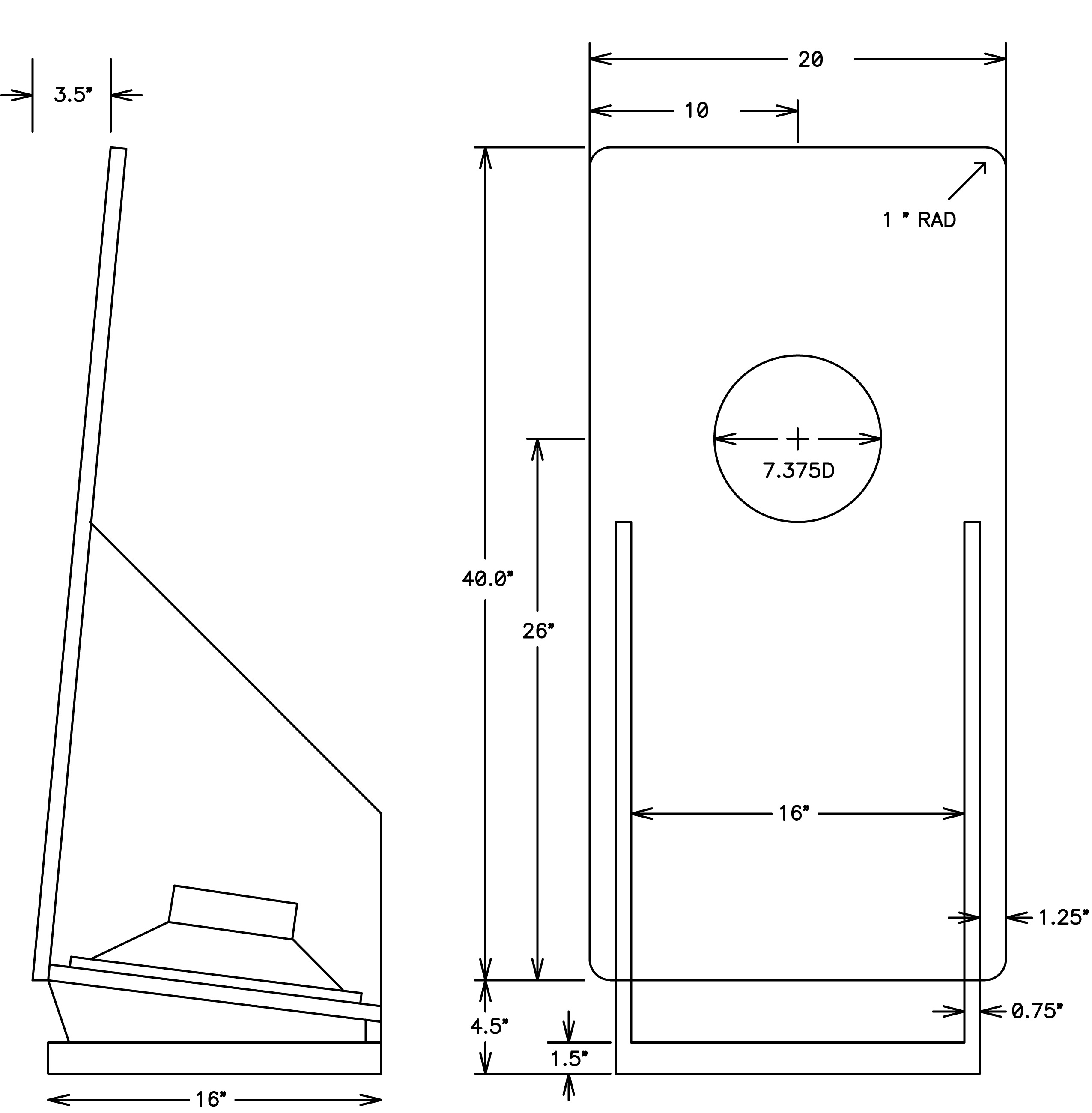

Medium with woofer open baffle ? Oh Papa DIY design are easy to build!
