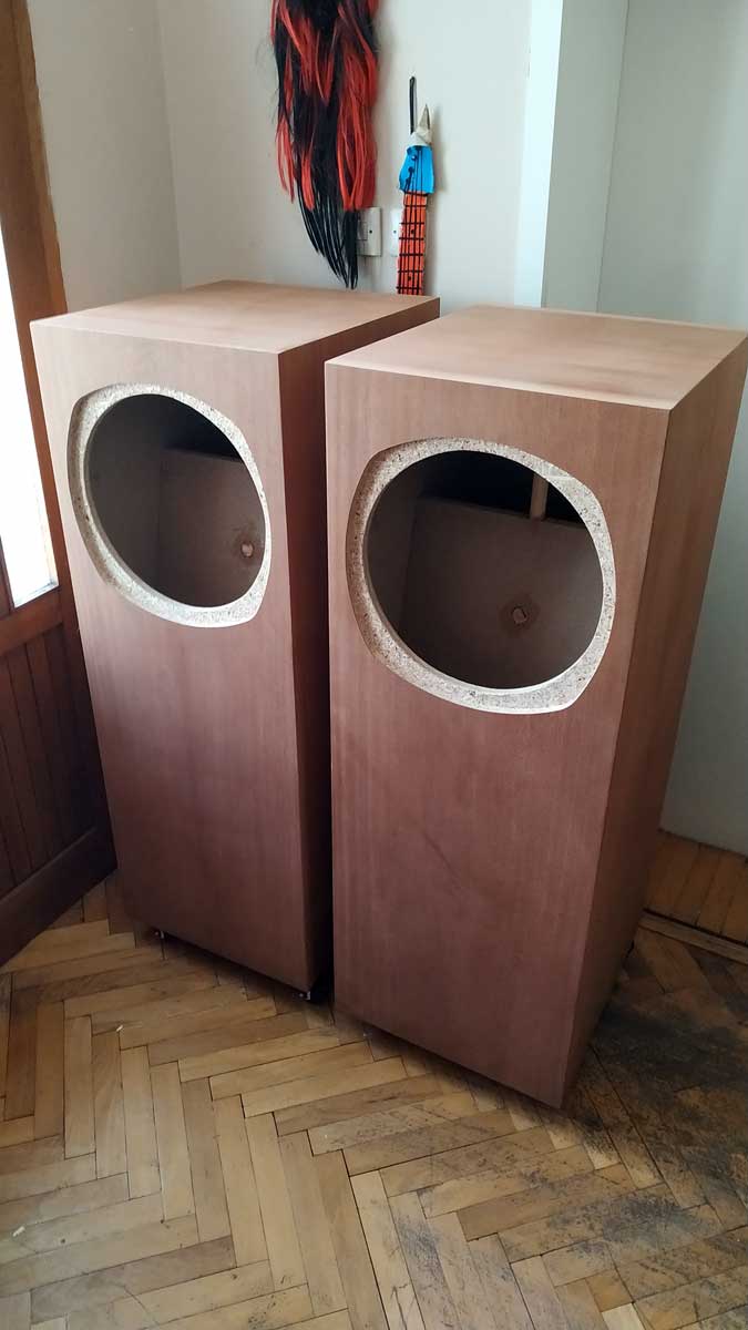

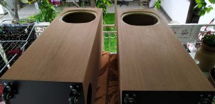

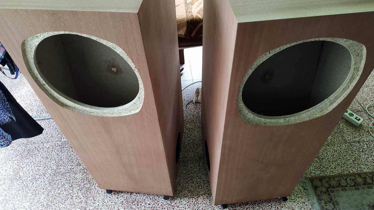

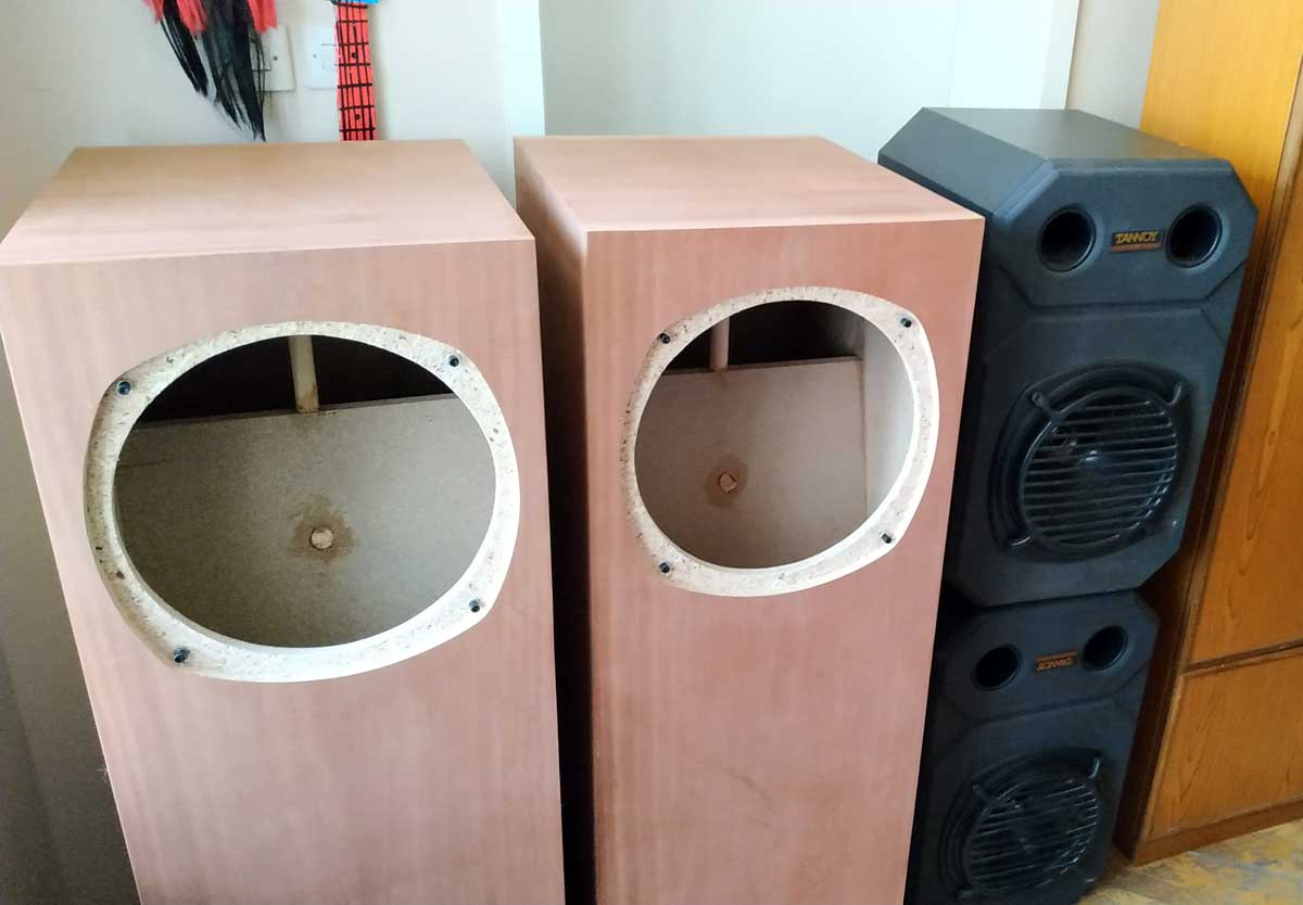

soon to be finished, small Tann boxes for Living Room, to take place of Absolute WAF OB
some wax on veneer, to finish hefty xovers and to put that fluffy white stuff in...
though, it'll wait a little, not overly in mood for dragging them around

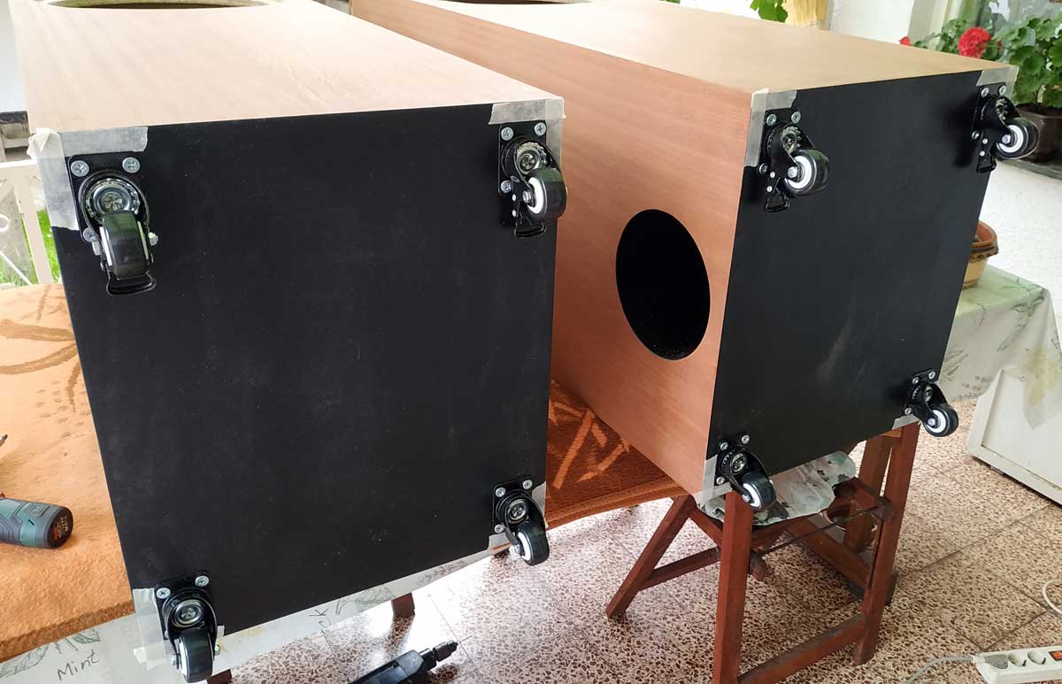

it's (whitish) from light - Mahogany Veneer
material is premium particle board (lazy to fight to acquire plywood, while I don't like MDF for spks), several broomsticks for braces, 200mm sewing pipe for TL opening
I've send Pa Sketchup file, slightly bigger ones - project for his venerable Tanns, but he's lazy to try it instead of his bigbadass Jensen cabs
that's Pa .... :)

I didn't made them (this time)
it was change of works with local guy (having plenty of work in audio carpentry etc.) - he made me boxes, I did assembly of some preamp to him
I don't like veneering job, so arrangement was great for both of us

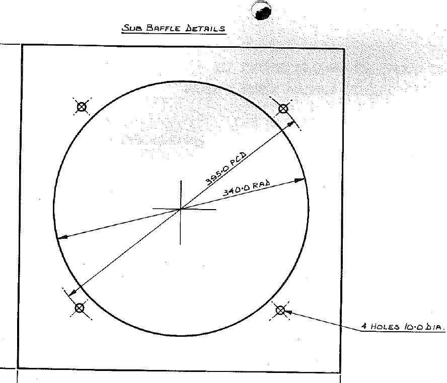

though, rebate for that Tann basket is easy , they gave nice sketch in some papers
Official Court Jester
Joined 2003
If you look at what ZM posted, it's pretty straight forward wrenchone. The corner radii are done from the center. Can't read the radius but the sides are done from 93 mm further away from center on a 289 mm radius.
39mm Dia router bit, to get nice rounded corners, rest as you wrote
