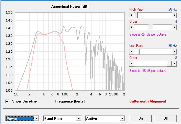

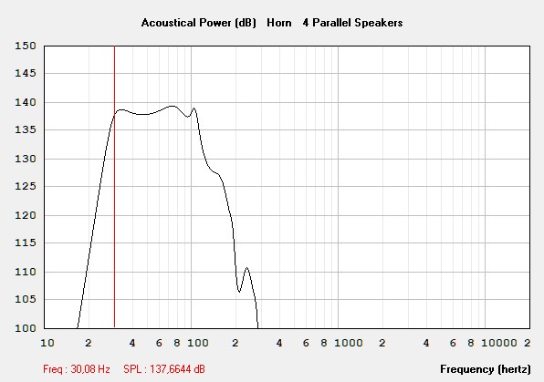

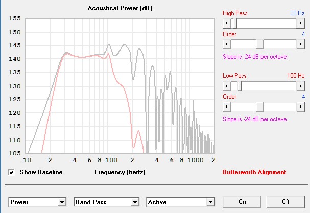

Josh do you have an idea of how well the Void V18-1000 would work in the Othorn? I live in England and can get them for less than half the price of the B&C 21sw152-4, but they have extremely high BL, low Fs and Q and high sensitivity so seems like they should work well in your design
Here is the simulation of the Void V18-1000 8-Ohm, about 600w at its xmax vs the 18sw152 8-Ohm at about 900w at its xmax (grey). The low Xmax of the void is killing the performance in the lower region, where the Othorn shines at.
Here is four cabinets with HP and LP filter applied, the cone at xmax of its 10,5mm.
And here are four cabinets with the 18SW115 4 Ohm:

Thanks, that's very useful! Seems like for a single cab the void is at most 3dB down from the B&C, and below 30hz is almost the same. Need to decide if the extra cost of the B&C driver is worth it for the extra output...

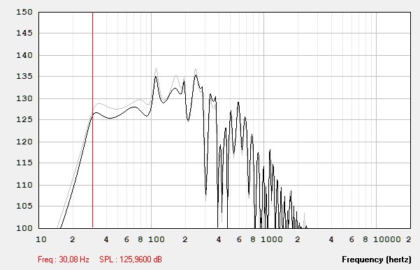

Has anyone tested the Eminence NSW6021-6 with the Othorn at all? Is the cone up to the task? I'm trying to decide which driver to load a pair with that I hope to acquire soon.
At the moment it is between the B&C 21SW152 (£420/$523) or Eminence NSW6021-6 (£720/$896 - if even possible). Any other recommendations? I've simulated (Hornresp) quite a lot really with only the Eminence appearing to clearly come out on top.
What are the advantages of the 21SW152 4 Ohm over the 8 Ohm? The response on Hornresp seems to show the 8 Ohm on top on my simulation (parameters are correct).
Any help would be greatly appreciated! I am also very thankful to Josh for this free plan of what seems to be a great sub judging from feedback. Looking forward to seeing how they compare to the Void Stasys X V2 I already have.
After testing TC parameters Josh Ricci wrote about the Eminence NSW6021-6 last year "The low Qts and high motor force indicate that this driver is efficient and well damped. It should be suitable for highly loaded cabinet designs....All signs point to this being a very powerful and capable driver. We will have to see how outdoor ground-plane measurements in cabinet turn out."
The MMS, Xmax, and power handling all appear to be proportionately higher than the 21SW152-4, indicating it should be "up to the task".
I'd expect output to also be higher, though can't be sure about power compression comparisons from the specifications.
The price gap between the drivers is quite large, almost 3dB- do the sim results look like that much output difference?
When looking at drivers that can take 8 to 10kW peak, the lower impedance is an advantage primarily from an amplifier expense standpoint- there are few choices that can deliver that much power/voltage into 8 ohms.
The minimum impedance won't be much different between the "6 ohm" Eminence and the "4 ohm" B&C, but as well as paying more for the Eminence, more amplifier power will have to be purchased to get the performance it might provide.

Oh right, the driver certainly looks to be up for powering the Othorn, I was just worried about the cone strength itself, given the high compression ratio of the Othorn.
I've attached an image showing the results when comparing the NSW6021-6 (grey) vs. the 21SW152-4 (black). Looks like around 2dB to me, if these results are accurate, that would mean a considerable amount less subs in order to achieve the same output.
I currently have an MC2 E90, powering 1 x 6 Ohm Eminence per side it would put out close to 1.5x the RMS value, whereas it would have more than double the RMS value of the 4 Ohm B&C and would happily power 4 I would have thought.

I've attached an image showing the results when comparing the NSW6021-6 vs. the 21SW152-4. Looks like around 2dB to me, if these results are accurate, that would mean a considerable amount less subs in order to achieve the same output.
Danz9876,
With only two dB between the two drivers, and the NSW6021-6 requiring more power to achieve the output, power compression is a big "if"- if it's power compression is more than the B&C, that 2 dB difference could shrink to almost no gain when the coils heat up.
Power compression aside, it would take 5 of the 21SW152-4 cabinets to achieve the output of 4 of the NSW6021-6.
If we put cabinet cost at $500 per with your driver costs, 4x NSW6021 =$5584, 5x 21SW152 =$5115, still a cost savings for more B&C boxes.
I'm all for less cabinet building, hauling and storing, but I'd want to compare one with each driver driven hard before ordering more.
