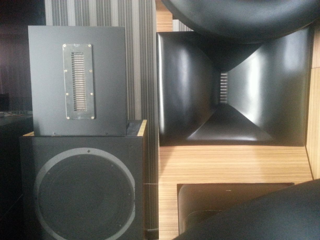

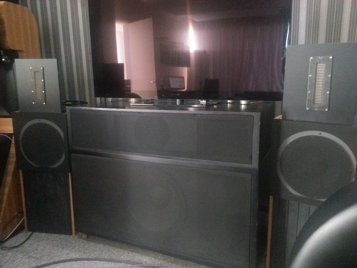

Raymond ( RayCtech ) sent me a pair of his midrange amt's for testing. I made a baffle for them ( 35cm x 30cm ). Back, its open, so it runs dipol. Today i hooked them up for the first time mounted on the baffle. I crossed them at 300hz , first order. Below,i use the Beyma 12p80Nd up to 300hz/24db.Since these are prototypes, and where folded by hand, they are not 100%, so at higher spl , at peak, there are some resonances, but nothing too much to bother. Integration with the woofer is not perfect, i will have to tweak and make some adjustments in the next days. Will do maybe also some measurements. So what are the first listening impressions? I would say, my reaction is similar as with the Beyma TPL150, when i listened to it the first time. It sounds very, lets say unspectacular. But in a positive way. It is extremely neutral,natural, open, revealing,fast, with correct timbre and tone. Voices sound simply as they should. I played already all kind of music, classical, jazz, vocals. It covers a very wide range, just as a guess, flat up to 10khz. More to come....:=))
Angelo
on the first picture, a size comparison with the Beyma TPL150
