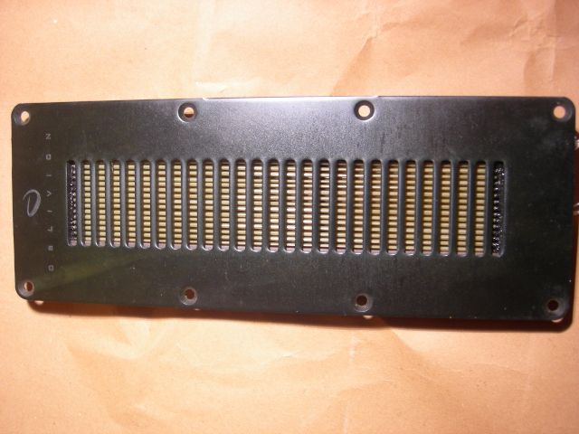

Then I designed a AMT driver with full range in mind.
After a lot of investigations regarding materials and physical sizes I was limited to a maximum size of the diaphragm.
I designed a diaphragm that was 1mm below the maximum size that could be produced.
Neodym N52 magnets was the strongest I could source and settled for that.
The poleplates was the next issue to be solved and I tried laser cutting first but got problems with warping, and I ended up with ordering some special stamping tools.. Due to limitations with the stamping process both the back and the front plate are made of two 3mm plates that are stacked.
One AMT driver (front plate) measures 240mm x 90mm and have a diaphragm that are 560 cm2 in area, and the Xmax are 1mm.
Compared to a 8" driver with 220 cm2 this AMT have (560/220x1) a calculated Xmax of 2.5mm. The impedance of the AMT are 8.2 ohm.
The AMT measures "flat" from 100Hz to 18kHz and drops of controlled in both ends.

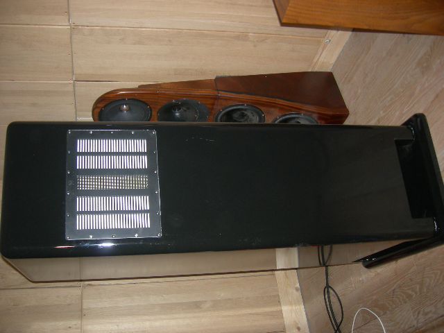

Due to this I will be using five AMT with a crossover at 125 - 250Hz.
One AMT above the crossover frequency and four below.
In a horn enclosure I expect a resonse down to possibly 25Hz.
Due to this I have made a version of the AMT with five diaphragms (front plate measures 240mm x 300mm).
So fare I have finished the cabinets and finished the first AMT driver, the four remaining AMT elements in each driver will be finished shortly, but the combination of the enormous resolution of the AMT and the slow fall in level downwards gives an impression of a system that have nearly all the bass needed.
Due to this I will soon make a system with four or eight AMT´s in a line source with a wave-guide for a truly full range AMT without any components (crossover).

Some photos..
Front and back of the one element AMT,
and the five element AMT (on element mounted) in the horn cabinet (down firing horn).
NB! this was the first prototypes so please do not look to closely on the finish..
The folding of the diaphragms have been improved in several steps...

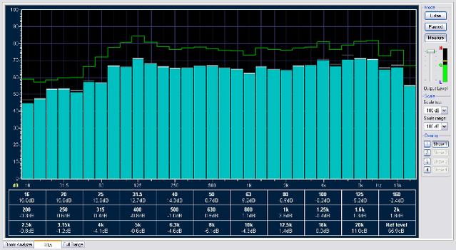

Here is a measurement i did now with XTZ room analyzer.
It is measured with one AMT in a horn cabinet designed for five AMT drivers.
The measured driver have not the latest and most linear diaphragm.
I will come back with better measurements when I get the proper measuring equipment running again, and I have prepared drivers with the final diaphragms..
