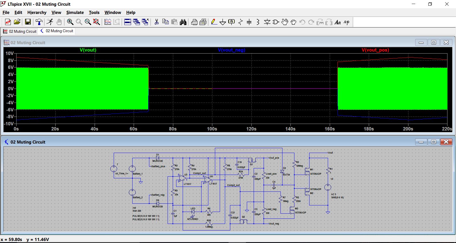

Mting circuit idea for the 02

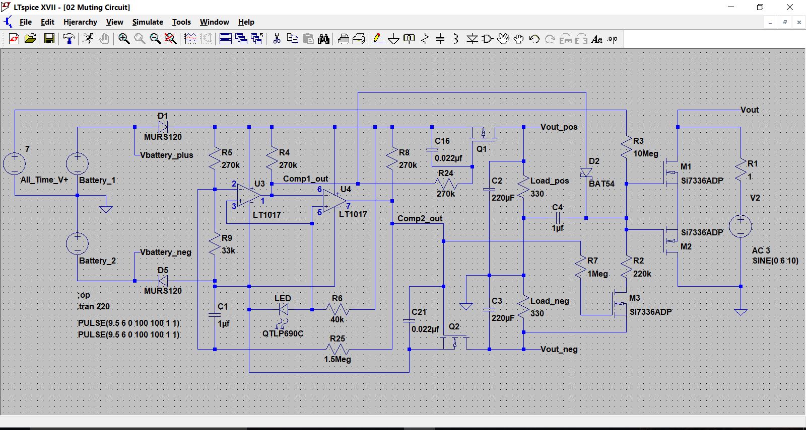

This is just an idea which seems OK as a simulation and so should translate to a real circuit.
The muting circuit is the bit at the right of the diagram. All the rest is standard 02 powersupply from an earlier simulation showing how the low voltage cut-off worked.
The mute consists of a FET solid state relay which is the two FET's. The lower the on resistance the better (Rds). This relay shorts the audio output.
The FET's are permanently biased on via a 10meg from the positive battery supply. This means the mute is permanently active.
The FET's are turned off (unmuted) when FET 'M3' is turned on via R7 when the appropriate comparator output goes high.
The FET relay is turned off quickly via shottky diode D2.
Possible issues...
1/ The O2 opamp output stage may not be able to find its operating point with a 'short' across the output. If this were a problem then the 1 ohm series output resistors could be increased slightly. It may be fine though.
2/ The FET types seem fairly critical. Many of the modern high performance low Vgs threshold devices provided in the LTSpice models are fine, the older common devices such as 2N7002 are not.

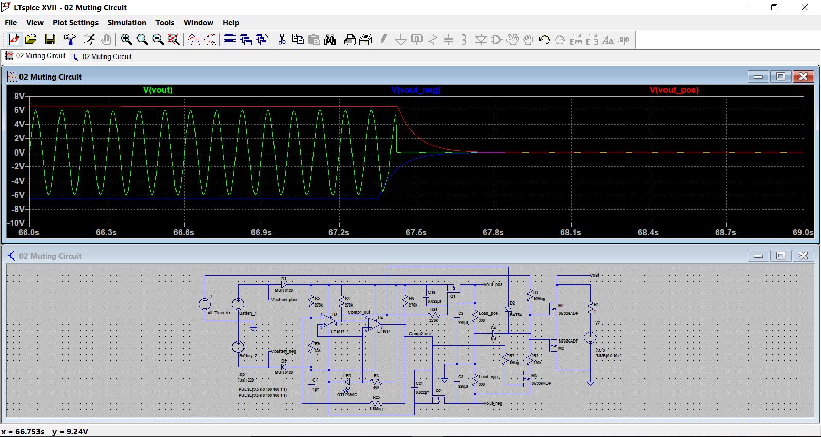

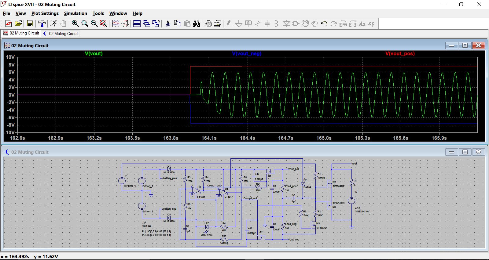

This shows the on/off behaviour. The voltage source at the right represents a continuous audio source that can be shorted to mute it.

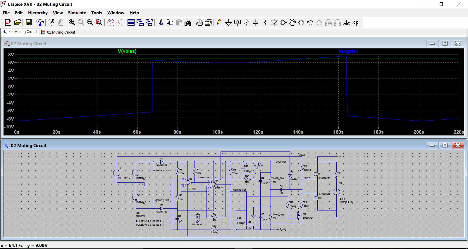

The FET's themselves draw nothing, the only current flow is in the 10meg bias resistor and here the simulation shows that in the 'off' state there is virtually no voltage across that resistor. Even if there were, the draw would be microscopic.
