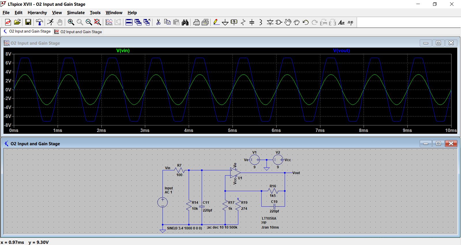

2. I noticed a noticeable distortion on high gain setting(R16/R22=1.5k, R19/R23=274). When switch back to low gain, it is better but still noticable if listen carefully. Is it due to the resistors value too small??

The distortion sounds like you are overdriving the input. You could try increasing or even totally removing the 1k resistors (R17/R21). Removing them would drop the gain to '1'.
The gain is given by Gain = (R16/R17) + 1 assuming the 1k is switched into circuit.
So you have a gain of 2.5 at the moment.
Try something like a 3k3 to begin with and see if that improves things.
Noises at power on and power off are to be expected. It is the single real failing of the whole design imo.
Thanks for your answer. But I am not understand why using small value pair of resistor will overload the input? Could you briefly explain?
The gain of that first opamp is determined by the ratio of the feedback resistors.
A CD player could deliver as much as 2.4 volts RMS (my Marantz does) and that would overload the first stage (cause it to clip).
This shows such a signal applied.

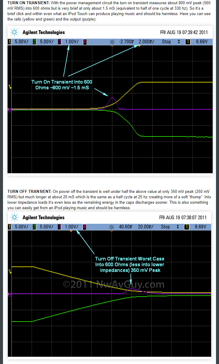

NwAvGuy did document throughly the transients, see the attached image 🙂

Thanks CHiroshi.
Interesting, and that reafirms my view that this this is a poor aspect of the design. I'm pretty sure some effective muting could be employed as an add on, perhaps using a discrete FET relay that is held 'on' all the time by the + battery supply, and that gets turned off when the negative rail appears (after a short delay).
Quoting 600 ohms is a bit misleading because the same 800mv will appear across load impedances down to single figures. 800mv across 8 ohm is probably just about within the current ability of the parallel opamp output stage, and that will sound very loud indeed.
Thanks CHiroshi.
