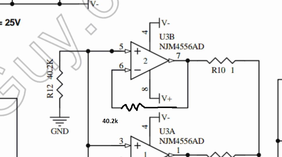

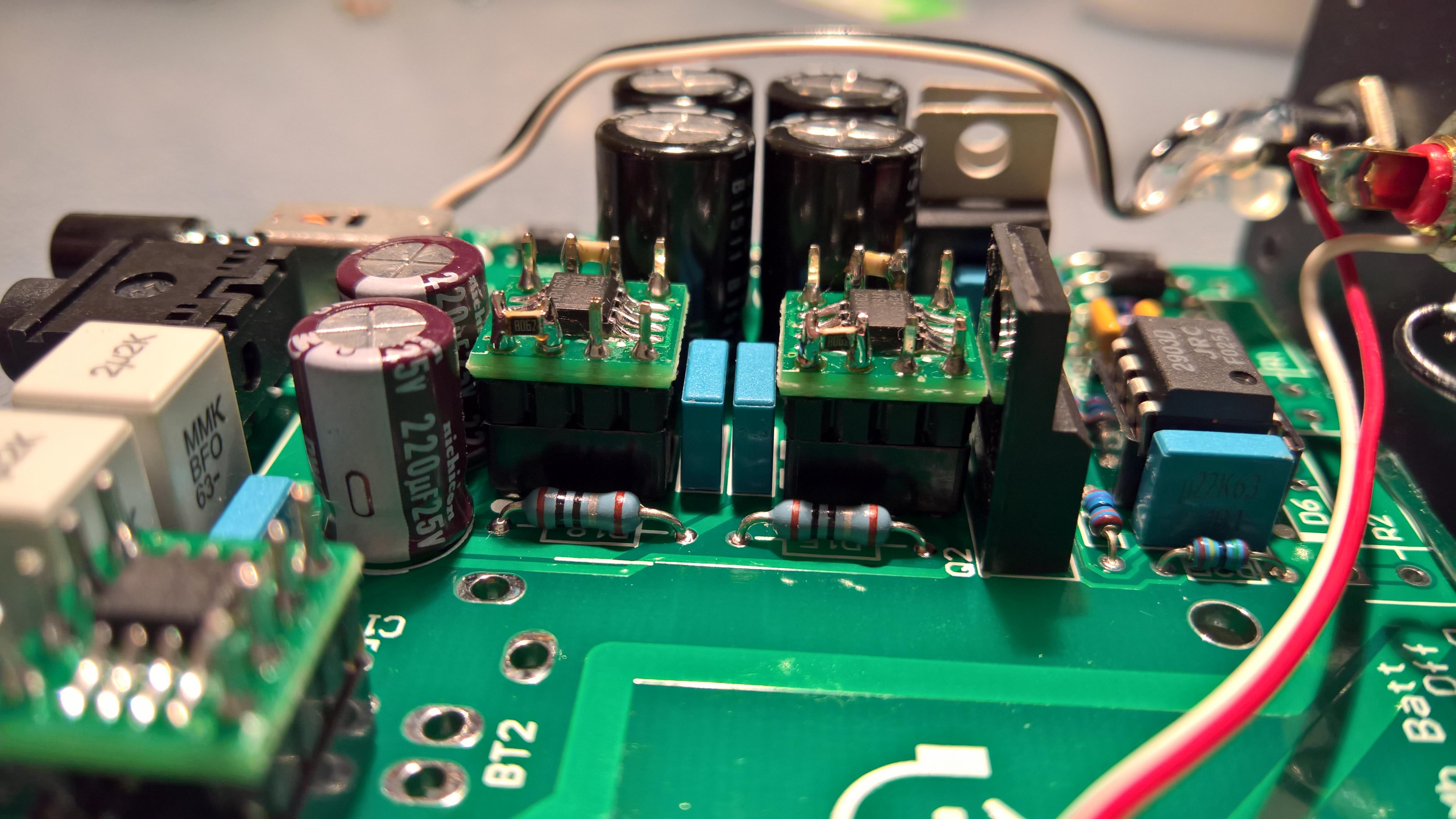

Hello, been lurking a long time here but finally time to post.
I tried OPA1662's as output chips on my O2, after reading about it here: http://www.diyaudio.com/forums/head...ersion-o2-desktop-amp-oda-69.html#post4191566
However, my DC offset rose to 53.5 and 55 mV. With stock JRC4556 I have only 3.5 mV offset and with LME49720, 1.5 mV both channels.
Now OPA1662 have a lot higher offset and bias currents than 4556, but I'm still surprised. Can anyone confirm this is enough for the big difference or is something else going on?

It sounds high but not beyond the bounds of possibility given the specs of the device. Worst case of 1200nA across the 40.2k would give 48mv and on top of that there is a possible imbalance in input offset currents to make things worse.
Try shorting R12 (or R13) and see what the offset falls down to.
Hi Mooly. I shorted R12 and DC offset is down to -0.5 mV. Other channel stayed at 53.5 mV.

Interesting. So it looks like this is going to be normal behaviour and purely the result of the relatively high input bias currents for these devices causing this offset. The good news is that although it sounds high, in reality little current will flow into a typical headphone DC resistance. You can measure how much for your particular headphone by measuring the volt drop across one of the 1 ohm resistors of the appropriate channel and calculating using ohms law. The voltage will be very tiny though and perhaps not resolvable on a typical DVM.
If the phones have say 20 ohm DC resistance then something around 2.5ma would flow.
No easy fix I'm afraid although it could be made 'better' by lowering impedances of the surrounding circuitry.
Administrator
Joined 2007
Although I say there isn't an easy fix... well the 'obvious' one would be to add a similar value resistor to R12 and R13 into the feedback path to equalise the error and make both inputs see the same offset voltage. You would have to do it for all four opamps. The downside of this is that the opamp node becomes sensitive to stray noise pickup, and also the step response (squarewave testing) of the circuit could be altered although probably not in any audible way.

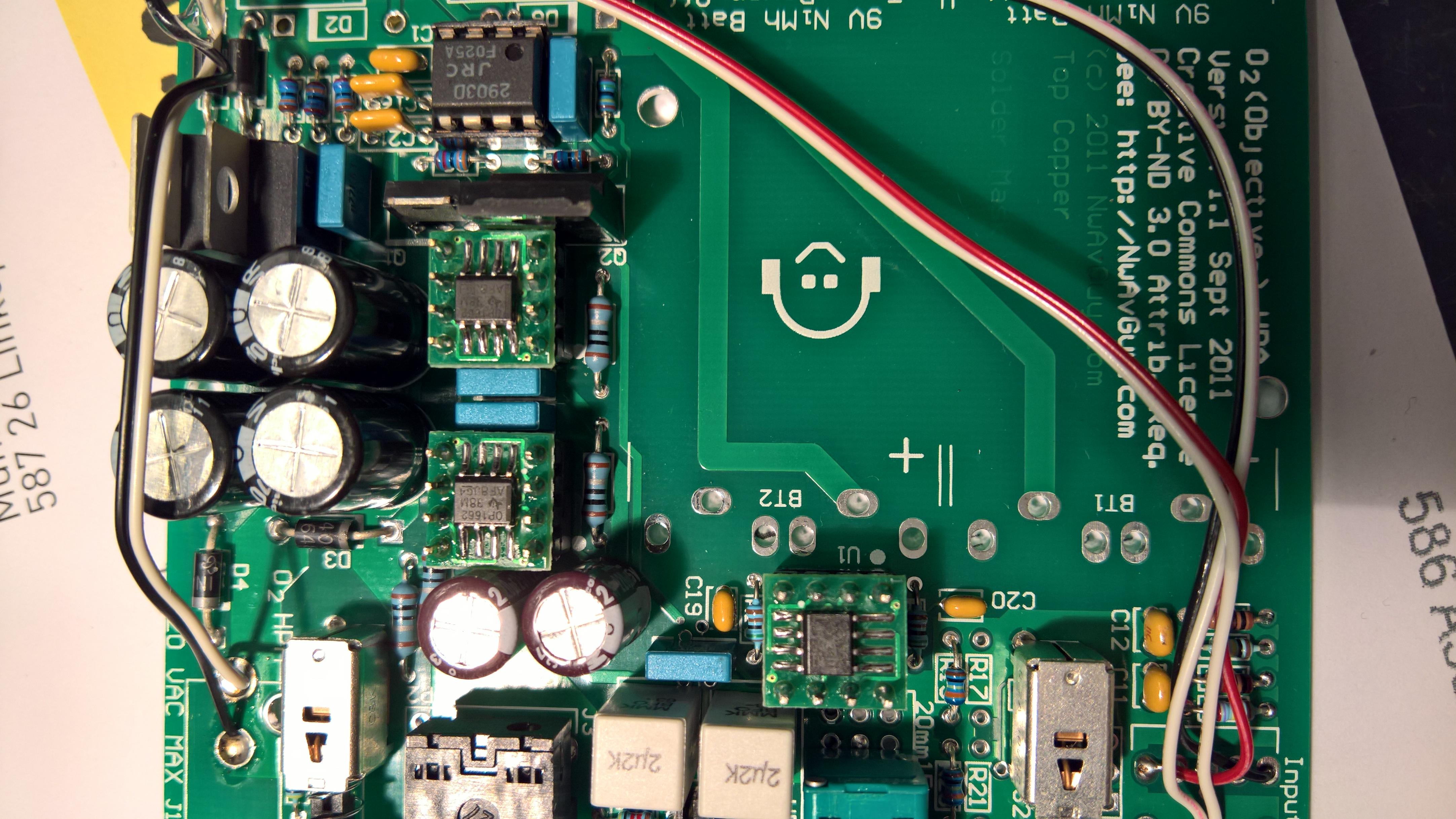

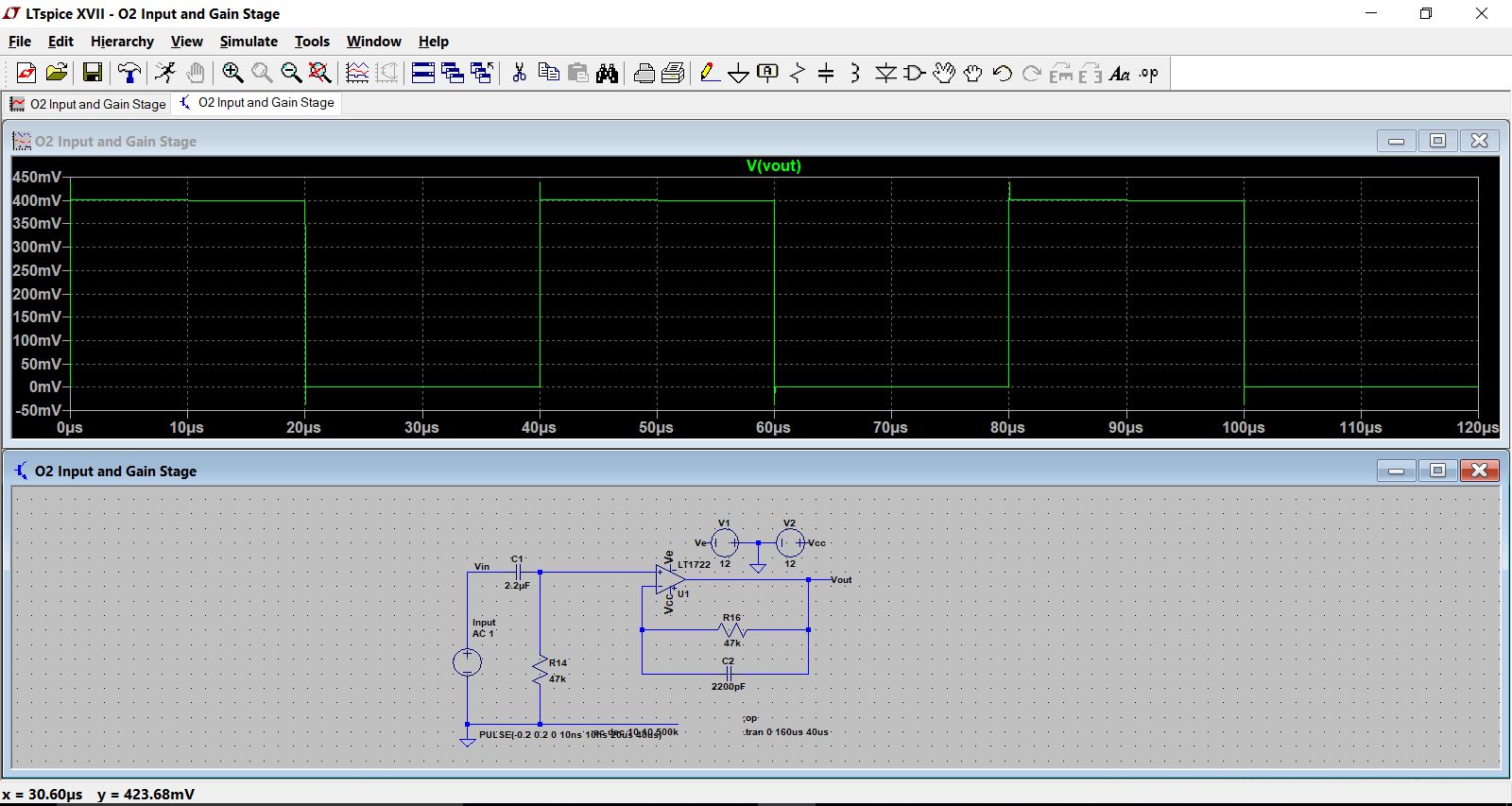

Hi again, I didn't really feel good with leaving 30+ mV offset...
I did this modification after realising I can keep it all on the adapter boards - no need for cutting traces on the actual amp. So I cut leg 2 and 6 just before it enters the socket and soldered 80k SMD resistors between pin 1&2 and 6&7.
It works! 1 mV DC offset! However I got oscillation due to the decreased phase margin (yeah I've read a bit about this). IC temp was all they way up to 64°C, although music sounded fine.
Soldering a no-name salvaged 56 pF ceramic as a phase compensating cap parallel to the resistors seems to fix the issue. IC temp is down to 39 °C after playing loud music 1 hour into my cheaper 60 ohm cans.
My question is, does the quality of the capacitor matter? There's so many choices, although in the 10-50 pF range (to stay above 30 kHz -3db) I can easiest find MLCC NP0 caps for cheap.
Administrator
Joined 2007
The quality of the cap should make no real difference.

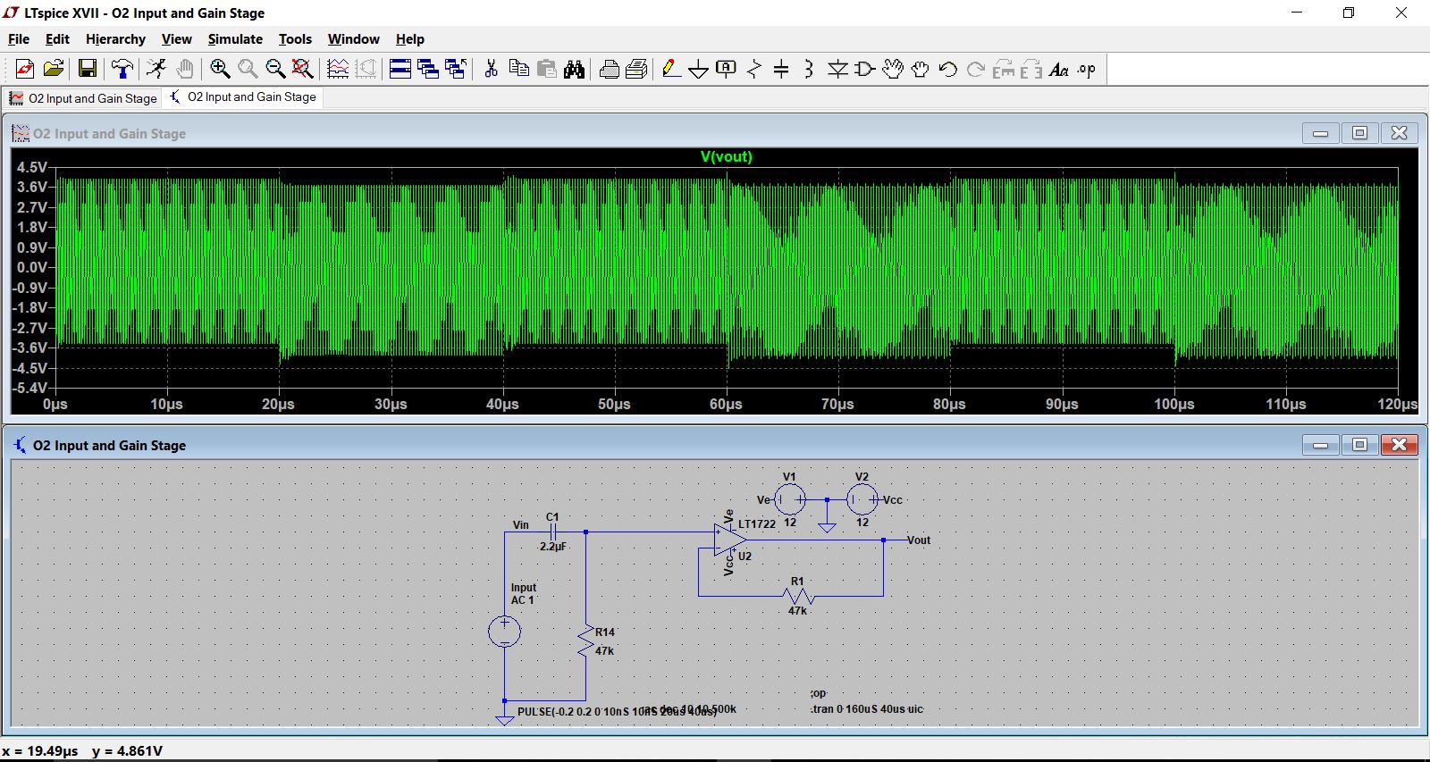

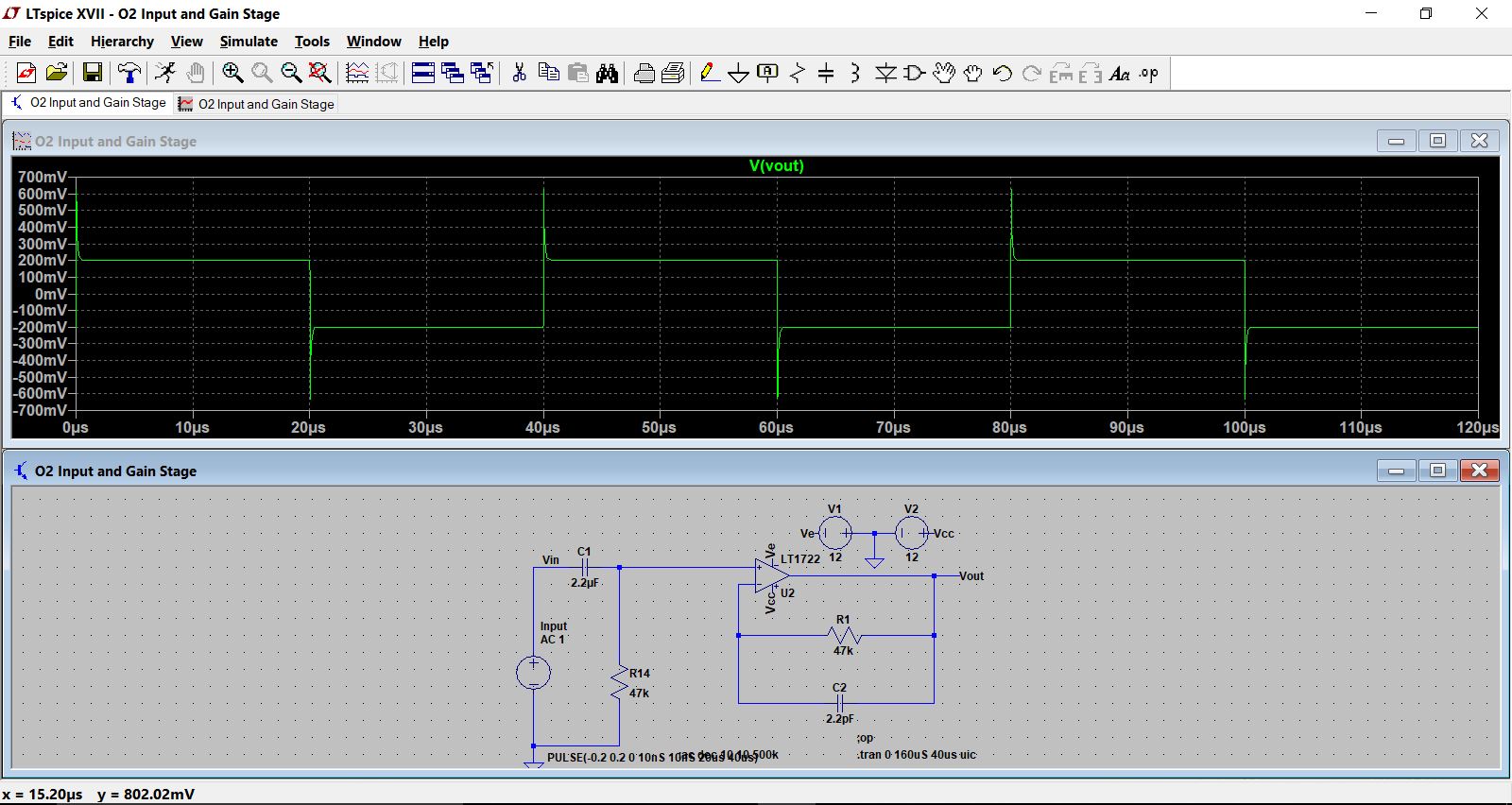

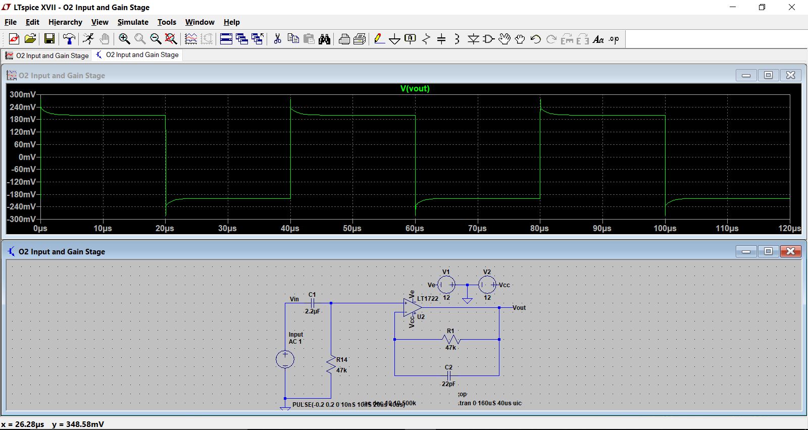

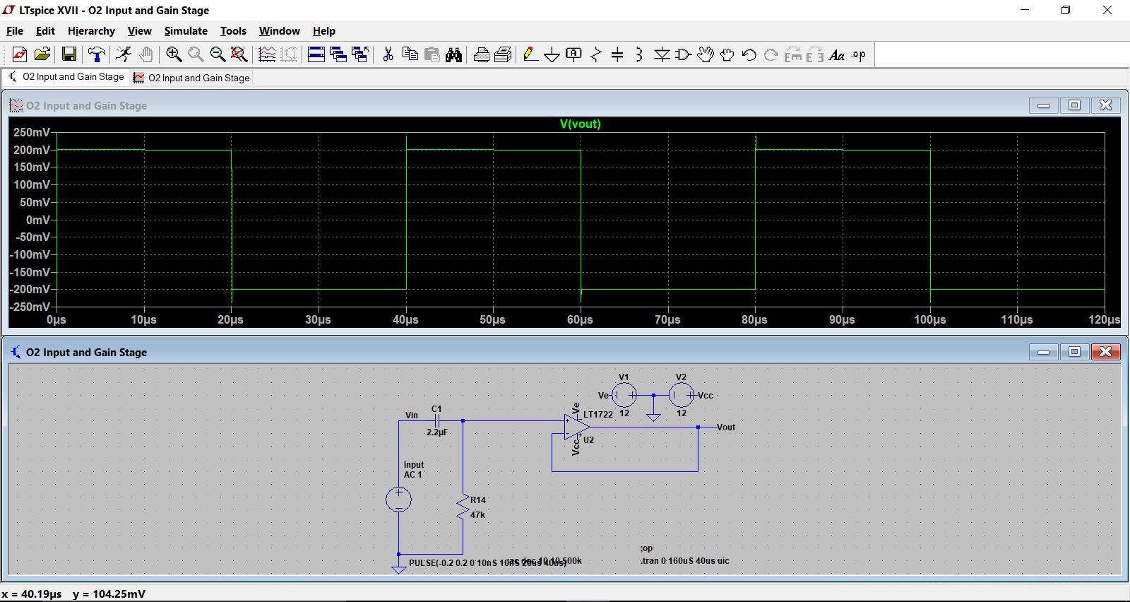

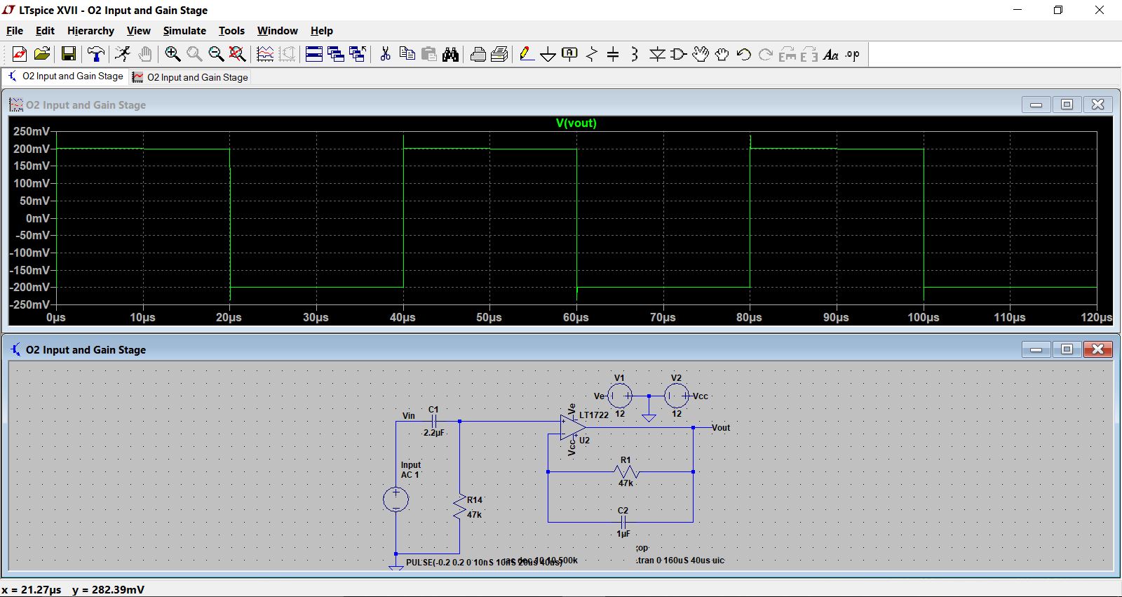

There is another way of looking at this though. The cap value isn't critical because it is working into an amp configured for unity gain. We can simulate this quite well using a high speed opamp and using a squarewave test source.
Image 1 is the baseline performance.
Image 2 is with the resistor in place. The circuit oscillates.
Image 3 is with just 2.2pF added.
Image 4 is with 22pF. The circuit is stable but not still at the 'baseline' level.
Image 5 is with a much larger 1uF cap added. We have now matched the baseline performance and as a bonus, the cap ensures the input pin is tied to the low output impedance of the opamp output at AC. This means the pin is not susceptable to stray noise pickup.
In other words if you to touch the pin with the resistor and a tiny cap in place then the opamp will hum and buzz loudly. Do the same with a large cap fitted and it will not.
Image 6 is with 2200pF cap (as requested ;))
