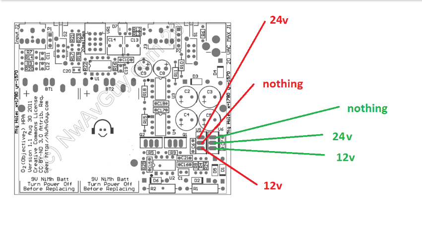

So i just measured this (o2%2520voltages%2520u2%2520only%255B14%255D.png (image) )
I got wrong values on r24 - instead of -11.4 i got -9,25. And on top o*oo u2 i got 7 instead of 9,8. What could that mean and what should i measure next? (everything else is fine)
It points to the unregulated supplies being low.

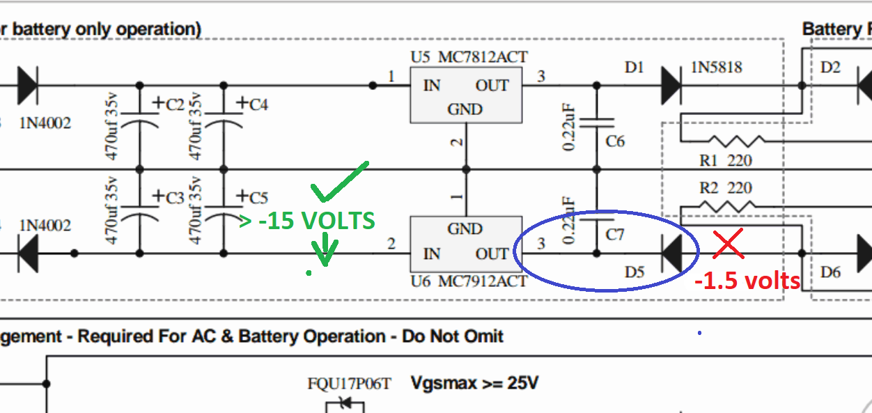

OK, so that seems to show there is a problem within the blue ellipse. You are now going to have to very carefully check that the -15 volts is reaching the regulator input pin. Be very careful not to short the pins out when measuring. Also check the voltage directly on the output pin of the regulator.
This particular problem could be broken or 'lifted' print around a solder pad on the regulator or on the diode D5.
You say that all was good except for D5, and so I take it U5 is all correct and that it has the correct +12 volts present. Yes
That means you measured at least -15 volts on the point I have marked on the diagram. All you do now is check that the -15 is reaching the actual leg (pin 2) of the regulator.
If that is OK then you check the voltage on pin 3 which is the output. It will either be present or not.

What point do you mean? I didnt understand clearly, sorry. I dont know if you got my point with explaining the values so i did this Imgur: The most awesome images on the Internet . And i am sure i shorted regulator. Should i get new one or is something else broken too?
Those voltages look basically good
You should find the voltages on U6 are negative. So -24 and -12. Yes ? (make sure they are).
If so, then you must have an open circuit connection between the regulator and the diode D5, or (unlikely) the diode is open circuit (or fitted wrong way around).
You must end up with the -12 volts on both sides of diode D5.
The regulators are tough, and your measured voltages show they are working OK. The spark would be one of the capacitors discharging.

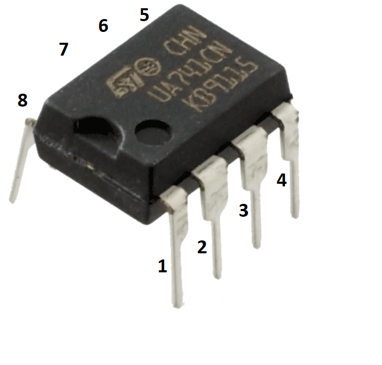

May i ask which pins are 8 and 4? Imgur: The most awesome images on the Internet green or red?
