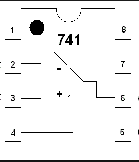

Assuming you have a basic tool like a multimeter to check your work for electrical continuity, you can repair mistakes like broken, lifted pads with scraps of fine tinned wire. If your close-up eyesight is good and you have good lighting and fine tipped tweezers, this is no problem for most people and the remaining pins will be sufficient to hold the IC firmly. Remember when soldering; the surfaces must be clean, the iron should be of the temperature controlled type for fine PCB work and set correctly. This allows you to work quickly and effectively, minimising damage. Pads usually only lift as the result of of excessive heat, delay and repeated mechanical stress.
Simply make sure the IC or component is fully inserted and wrap a turn of the wire around the relevant pin. Then cut off the remainder of wire, leaving enough length to solder along the remaining copper trace. The copper trace may need to have its coloured resist coating scraped off gently to allow tinning and then soldering the wire to it securely.
The IC orientation is marked on the assembly diagram by a notch in one end of the IC outline. This should correspond with either a similar notch in the IC or to the same end where a round "dot" or depression on the top of the IC is made, next to pin1

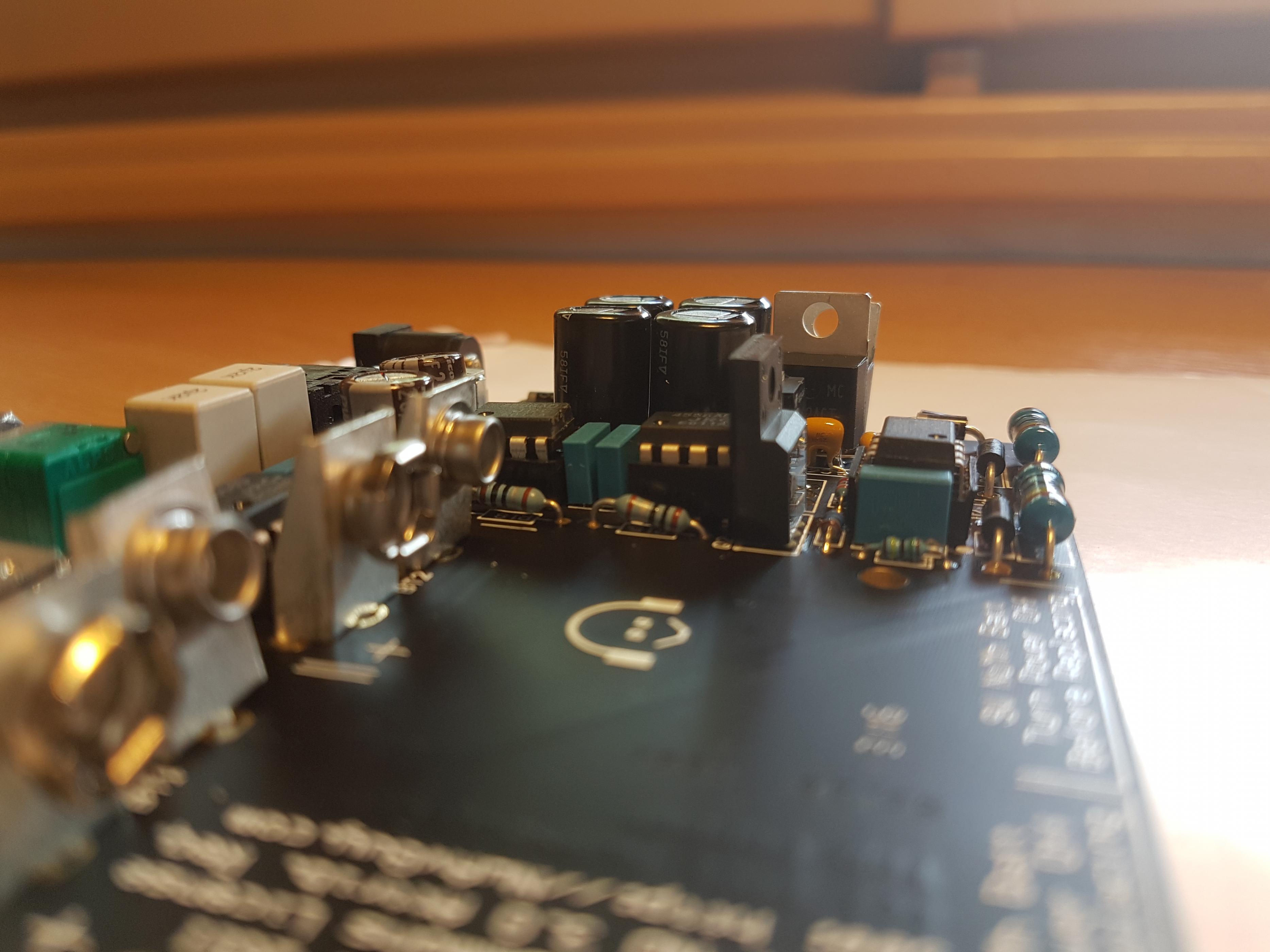

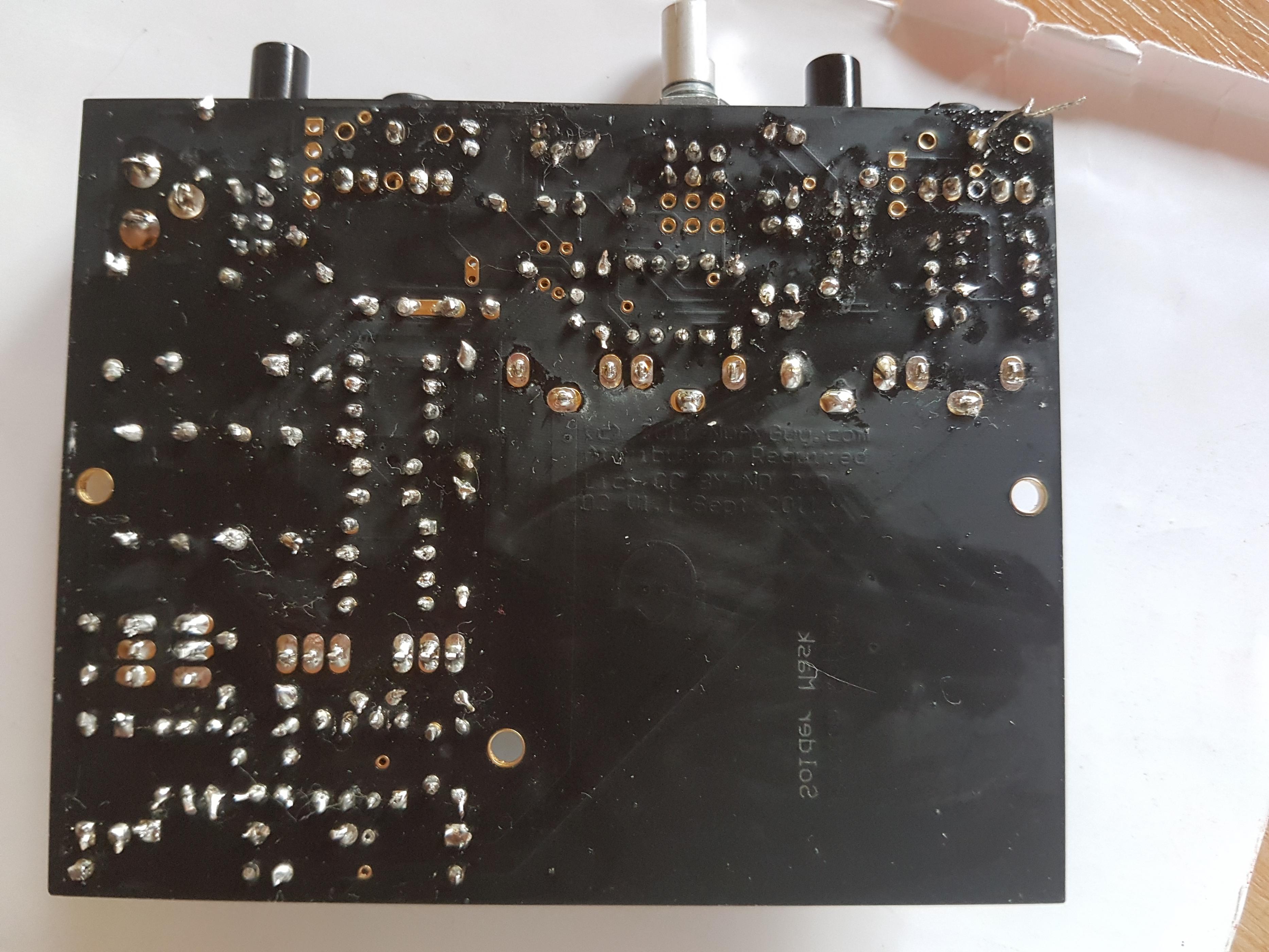

Here are the photos as you said. If they are not enough i can get more.
Well the orientation of chips is good i watched a lot of pictures of working amp only problem is if they are not inserted enough :/ Can you recognize from pictures?

Do you think that they are fitted correctly? Imgur: The most awesome images on the Internet
Can that be repaired or will the heat damage components?
You can repair it (just resolder the connections): - remove the socketed ICs before you solder anything - give the board enough time to cool down between soldering, don't try and repair all the pads in one go
