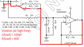

The thing is interesting: is the LME49990 is unable to drive the volume pot ?!
Fancy fast opamps require careful frequency bypassing/compensation that are not met in O2 cuz its not designed for such opamp:
1) Power bypassing recommendation that given in LME's datasheet: 'To achieve a low noise and high-speed audio performance, power supply bypassing is extremely important. Applying multiple bypass capacitors is highly recommended. From experiment results, a 10μF tantalum, 2.2μF ceramic, and a 0.47μF ceramic work well. All bypass capacitors leads should be very short. The ground leads of capacitors should also be separated to reduce the inductance to ground. To obtain the best result, a large
ground plane layout technique is recommended and it was applied in the LME49990 evaluation board'
2) About frequency compensation. Fast opamps can amplify up to tens of MHz. At such frequencies inductance of few cm wire loop can be enough to cause phase shift enough to turn NFB into PFB. So frequency compensation capacitors better be placed at millimeters distance from such opamp's pins.
3) Load (even if its a pot) may have stray capacitance, enough to slowdown output that again will lead to critical phase shift. Datasheet tells that at unity gain config such capacitance is 100pF. It would be so if wire of 1..2m length was connected to your opamp's output and unlikely that small pot will have such capacitance.. But who knows..
4) There is also one suspicious moment in the circuit: NFB's ground resistor have two possible values - 243 or 715 Ohm depending on switch position/presence. Whats yours? Suspision its because frequency compensation cap via 243 Ohm resistor can again cause problems, but its most unlikely guess cuz even 243Ohm resistor must be enough to avoid such problems.

so.. inappropriate PCB layout (some ground loops inductance) + too capacitive load via NFB'c capacitor - ground resistor.. Fast good opamps require good care to work correctly.

From my research I found that best attenuation at 90 - 100MHz area is acquired with small: 10-20pF caps, + 100-120Ohm resistor in NFB network, or just without any caps here.
So I removed C19 and C20. The oscillations completely gone from everywhere. The amplitude of the residual noise is about 2-10mV on the opamp output @ full bandwith, with bandwith limited to 20MHz there is flat line on LME and NJM4556 outputs. More testing when I'll get the load resistor set.
Only good square pulses will tell if capacity in NFB is ok. Squares must be square, without overshoots.
As about low resistance to ground in NFB, see:
However usually (with less... cool opamps) putting serial resistor of>= 100R is enough to compensate any capacitive load, but since its a really cool opamp even 200 Ohm may not do the trick here..
