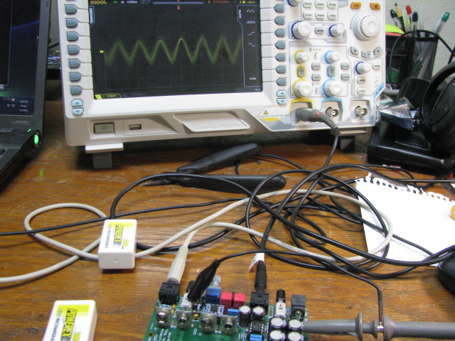

I tried to replace the NJM2068 by 2xLME49990, and found that LME opamps just not suitable here.
First I noticed timbral change, much more noticable than expected from going from 0.001% to 0.0005% THD. The sound became just like sound of tube amp.

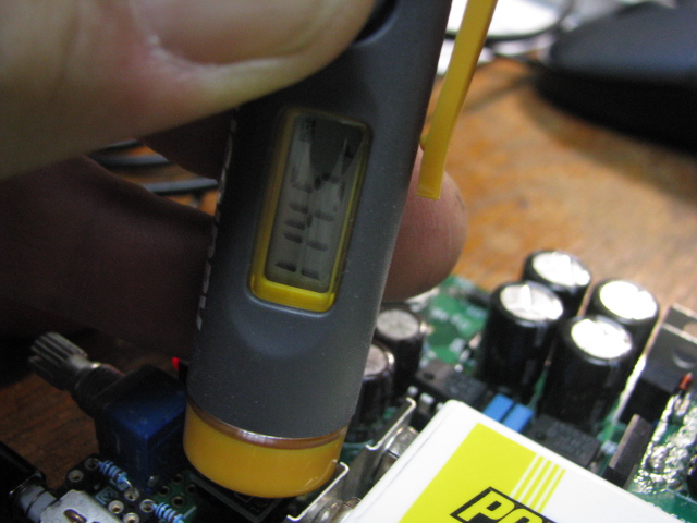

The first measurement I performed just by my finger - the temperature of opamp was about 50-60 C*. It's quite abnormal hot for opamp loaded to about 1.4K. Then I went to more advanced measurement - I used my DSO to see what's going on the LME49990 output. And as I expected, there was an oscillation. Small - less than 0.1V amplitude, but enough to impact the sound, and make the opamp hot to touch.
Of course I tried to add 1 0.22uF cap, or 2x0.22uF caps with middle connection grounded.
There was a very small change of amplitude of oscillations. I swapped LME opamps to 2068, and oscillations gone.
I returned an old pot and 40.2k resistors, and checked the circuit again - the result was same: LME49990 - hot, perfect sinusoidal 0.05-0.08V output, + tube like sound,
NJM2068D - cool package, neutral sound, almost flat output at no input signal.
Looks like that not impedance issue. It's like something altering the signal phase at high frequency. NJM eliminates that problem because it slow, while 110MHz LME49990 becomes an oscillator.

You always can to build separate PSU, then to deliver the power to amp by screened 3 axial cable, or even screened twisted pair.
2Tolik all that looks like inproper caps on power rails or improper frequency compensation
So,
- If that 2x0.22uF were ceramic ones? Many film and all electrolytic caps are useless at MHz-s frequencies.
- Do you put them close as possible to opamp pins?
- Try to add 4.7pF ceramic just between 2&6 opamp pins. That will be effectively paralleled to O2's own 220pF frequency compensation caps, but afraid that inductance between opamp and that caps too high to work them correctly with that fast opamp used with adapter. If that will help - better to move that 220pF close to opamp instead of adding additional caps. However likely that 220pF are not best value for new opamp, but that should not cause oscillation - just produce more THD that it would be with optimal value.
- As last, try to insert ~470R resistor between opamp and VR, close possible to opamp itself.

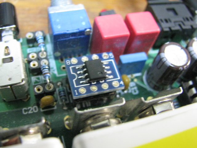

Hi! I'm curious, did you use the dual LME49990 adapter from "Frugalphile" on eBay? Those are the ones I've been using and so far haven't had any oscillation problems. I'm fairly sure he is using genuine chips. The properties of specific adaptor boards can make a difference too. His are fairly small surface area boards. If the adapter board is accidentally routing an input line too close to the corresponding output line that can also be trouble.
As it turns out an 0805-sized surface mount MLCC capacitor will fit just fine between the pins of those film 0.22uFs the O2 uses. I'm working on new O2 design with inverting stages and I've HF-bypassed all the 0.22uF films that way with 0805's between the pins. Or just solder an 0.01uf X7R leaded MLCC cap between the 0.22uF pins under the board. Like misterzu said those film caps may look like open circuits at the 110mHz the LME49990 can handle. The ceramics should do a better job at high frequency. Also definitely worth trying his suggestion of a MLCC ceramic soldered right to the power pins on the top of the adaptor board, if you haven't already.
If you would like to give a different chip a try, consider the LME49880. That is the FET-input cousin of the LME49990 which is also THD+N rated down to a 600 ohm load. I'm using that chip for the gain stage in my new creation. Its GBP is only 25mHz, just a tad less than the 27Mhz of the orginal NJM2068 chip, much less of a turbocharged race car than the 110Mhz LME49990. Should be much less prone to HF oscillation. The LME49880 is a dual chip so you just need one on an approprate adapter board. It is a "power pad" chip with a metal bottom for heatsinking, but just driving the 5K pot it should be OK. If you happen to find an adapter with a power pad "pad" in the middle it should be tied to V-, pin 4 on the chip.
But regardless you definitely have found a problem in your case! That is exactly what happens with chip oscillation, they heat right up like that. Good troubleshooting work.

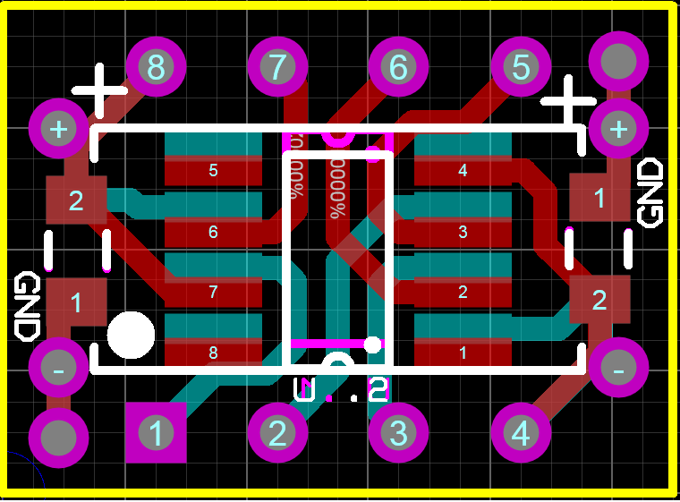

But here is another thing that boring me - all ebay adapters I saw are just bad by design to my eyes. While coupling caps should to be placed so close as possible to an active device, those adapters just taking an IC from the decoupling caps away. And I think that this problem not far less, than film caps. By the way, I successfully dealt with HF issues in SMPS, by using snubbers with film caps.
The "patches" still possible, but I'm not fan of that way. I prefer something more elegant. Below is adapter I developed to use in such situations.
It can to handle 4 x 0805 caps, + 2 tantalum, film, or electrolytic caps with 5 mm lead spacing.
If there is problem with gerbers RS274X, just PM, I'll do it in RS274D format.

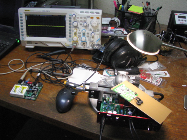

Tolik - I happened to have some test equipment out testing another amp. Here are some photos of an O2 with that Frugalphile dual LME49990 adapter.
* The first photo is the test setup with destroy-able test headphones. That O2 on the left has the dual LME49990 adapter and standard NJM4556A output chips. It also has the 5K pot modification, with the 4.7uF coupling caps. It has one of my power management latch circuit boards in for U2, but that is out of the signal path (just controls the mosfets) and won't have any effect on these tests. I would remove it, but the board pins are hot-glued to the socket. The scope and probes are 200Mhz.
* The next two are just closeups of the board and that Frugalphile dual LME49990 adaptor.
* The next one is the temperature reading on the adaptor topside chip. I get around 114.5F. This is with music going through the board. The O2's "on" LED shows just above the pot.

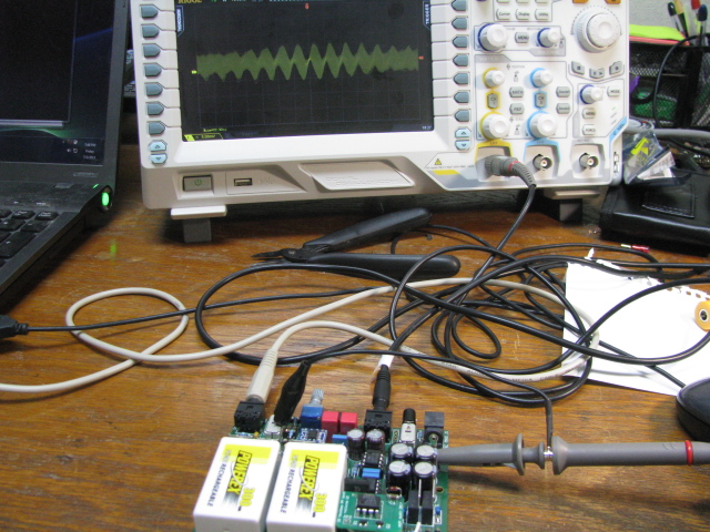

* Next is the base EMI noise level with batteries out of the O2 (no power of any kind applied to the O2), then the next is with the batteries installed and the O2 turned on. About the same. The "fuzz" around the signal is just triggering trouble, not an envelope of some kind.
This is all measured at the output of the NJM4556As, which will be frequency limited by those chips. I've also tried measuring at the pot with some series resistance tack-soldered in series, to keep the scope probe capacitance from causing any chips oscillations, and that measures the same.
