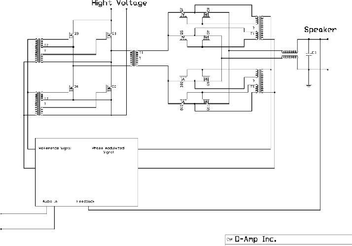

Finaly, their is a pick of my news project...refer to other tread for info about it...And yes Eva, this topologie work with very hight effiency....Try to try other thing that other people do, try to experiment! Dont take it personaly...

That's a funny circuit.
It won't work in class BD because transformer saturation will arise due to duty cycles varying too quickly with music signal. It will only work with phase shifted 50%/50% duty cycle carriers (plain class D).
Also, it's absolutely impractical unclamped as you have drawn it. The switching devices in the secondary side will be subject to strong avalanche on each output inductor polarity inversion event due to transformer leakage inductance and will blow.
It has to be noted that the transformer introduces a current dependent dead time, which seriously degrades the output voltage versus duty cycle transfer characteristic (that must be pretty linear for audio).
Do you have any picture of the working circuit or have you just copied it from some old patent? Your pictures, both here and in your website, only show straight low power circuits. Where are the 12 TO-247 switching devices per channel?
Also, how does the previous circuit matches the amplifier operation description found on your web brochure: "Switch mode resonant PWM power supply at 62.5Khz, 6.5KW capacity on each channel 4 Quadrant ground referenced common mode resonant power stage at 500Khz Delta sigma analogue signal convertion amplifier."
In order to get phase-shifted operation, or even the claimed class BD operation, the transformer and the output stage must switch at the same frequency to start with.
I only see contradictions and pictures not matching at all your claims. Not to mention that at the beggining you were trying to fool us into thinking that the pictures were of the said amplifier (in case it exists).

This sort of phase shifted, differenced switched carrier design was patented by Brian Attwood decades ago. One (or more?) working comercial audio amplifier designs were produced. They were supposed to have performed well enough, but were only moderate power, complex, expensive and prone to blowing up.
One of the supposed advantages of a differential design like this is that it subtracts out many of the power stage non-linearities.
A friend once designed a working, reliable sine wave inverter based on this approach, but he rejected it as not worth the complexity (and ensuing cost).

Eva, dont mix up what I have already made and sell and what I'm designing now! On my web site, all product of serie one was designed 6 years ago and the HVI 4 years ago. I'm now working on neews product to replace that old design. The DLS3000 and lower power will replace the serie one with better performance, and a second generation of HVI with up to 6kW per channel is on production now....
The circuit I show you is only a draft of one of my news design, no clamp elswhere is show and I dont use mosfet but IGBT.
This draft have nothing to do with the DLS in class B-D I have made here. This new DLS is now ready for production, it was just their to show it and give good idea to people about class d! The next project I work with phase modulation is for future project if I can bring it to work as I wish. The only advantage with this amplifier is that drive circuit is very simple, protection circuit too, IGBT is cheap, even if I put 12 on each chanel! Stability for now is pretty good, protection work very well, effiency is incredible because each output in AC switch work about at 25% of total power except the switching one at 50%, the only damn thing is that the sound is a bit harsh for now, but I'm sure to find what's wrong with this.
I know that Brian Attwood have already made this for Peavey decade ago, but he have work on all half bridge, half quadrant switch topology with 250V mosfet. My design is lot different because the reference and phase shift signal can move from booth side of the PWM signal, so I have to use a reference section for each chanel. Second, the use of 4 AC switch will ''naturaly'' kill the overshoot at teh output of the reference transformer, and common mode filtering can be done, better way to recover audio signal.
As I have explained, every time the state of the output bidirectional switches is changed, the current flowing through the leakage inductance of the transformer has to reverse direction. In short, that means AVALANCHE and SPIKES.
You can model leakage inductance as a 5uH to 20uH inductor in series with the primary of an ideal transformer, or this value scaled by N^2 in series with the secondary if you prefer (that's for reference only, actual value depends on size and winding techniques).
Also, you can't claim increased efficiency because that circuit has two IGBTs in series with each inductor leg, other two in series with the primary (dropping 2V each one) and plenty of avalanche losses. The only usual cause of losses that is absent from that circuit is diode recovery spikes, so I assume that you have been suffering really high losses due to them in your previous designs.
Anyway, the classic class D output stage with two transistors and an inductor performs better than that and it's much simpler. Furthermore, the diode recovery problems due to excessive dI/dt that arise with high supply rails are very easy to solve with a magnetic snubber. In my prototype, if I short the little coupled inductor that limits dI/dt, I can measure 5 times taller radiated EMI spikes one meter away from the switching stage, and power losses increase two or three-fold.
