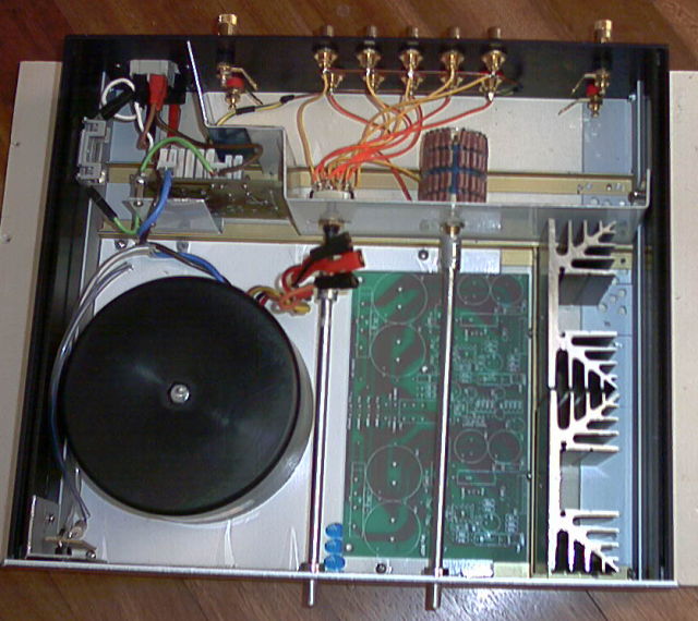

So, I finally (last week) got everything into a case with all the hole drilling etc. I am using the same case that Dario is using. I am totally surprised how (at most!) the sides only get to be lukewarm. Nice. Overall I am reasonably happy with this build (my first attempt at metal building sorts of things... [minor, I know, but I am total amateur at this...; had to buy tons of tools too...]).
I added a 10k Alps pot and this is causing a small amount of hum pickup. It's clearly an impedance problem since the hum is worst in the (roughly) pot middle position. With shorted inputs the unit is dead quiet. I suspect the noise is rectifier noise. I have the chassis on earth ground and otherwise only have signal and power ground connected via the 1Ohm resistor on the boards. No connection between power or signal ground and earth ground. The signal wires from the back are shielded though the shield is connected to the signal ground (I suppose that ultimately makes for no shield at all...). Do I really need a buffer to address this kind of noise injection? I have the signal coming from the back of the case to the front where the pot is and then to the inputs on the boards.
Might it help if I had a dual conductor shielded wire running both signal and signal ground on the inside of the shield? Then where would I connect the shield? Chassis (effectively earth) ground?
I'd like to avoid having to build a buffer. I'd also like to avoid the other obvious(?) possibility: putting the pot into a separate enclosure.
I should emphasize that the hum is very low volume and I have to put my ears right up to the (high efficiency) drivers to hear it. But it's there and it's annoying. I gotta get rid of it.

A buffer is NOT required.
Any chance we can get a picture? My initial thoughts are to use a shaft and push the pot to the back of the enclosure to shorten the leads.
If that is not an option then we diagnose the wire and pot.
More than likely the pot housing is grounding to the chassis, or the wires running to / from the pot are not shielded well.
What type of signal cable are you using from RCA's to pot and then pot to amp?

If you could arrange things with pot in the back of the case it would be better for noise picking.
All the entry points are at the back (of course!) then come the toroids, then come the boards. Doing a long shaft (at least in this version of my build) is not an option.
For the wire I used the Teflon encased shielded wire that Steve (ApexJr.) sells. Its multistrand silvered copper. The shield is woven (and a bitch to open up...). Nice stuff. But it occurred to me that the shielding doesn't really work if the shield itself is ground. If stuff gets injected in the shield it contaminates the signal, no? Only if both are shielded can this work... Or am I missing something?
I'll try to send some pictures (I am slightly embarrassed by some of the workmanship on the inside... but I'll swallow my pride... :)). Will have to wait until tonight.

I know Steve's co-ax cable. I use it to rewire guitars for friends.
For audio I use his shielded Tefl*# insulated, Silver plated twisted pair.
In that case from the RCA's I would use the inner conductor as the hot lead and use the shield as the grd / neg lead to the pot.
From the pot I would use the center as hot, shield as grnd.
On the amp brds I would use ONLY the center conductor for hot and put a jumper to the RCA ground to test and see if the noise goes away.
This way you are using the shielded braid as a "drain" for RF / noise and the pot / amp are star grounded to the RCA's.

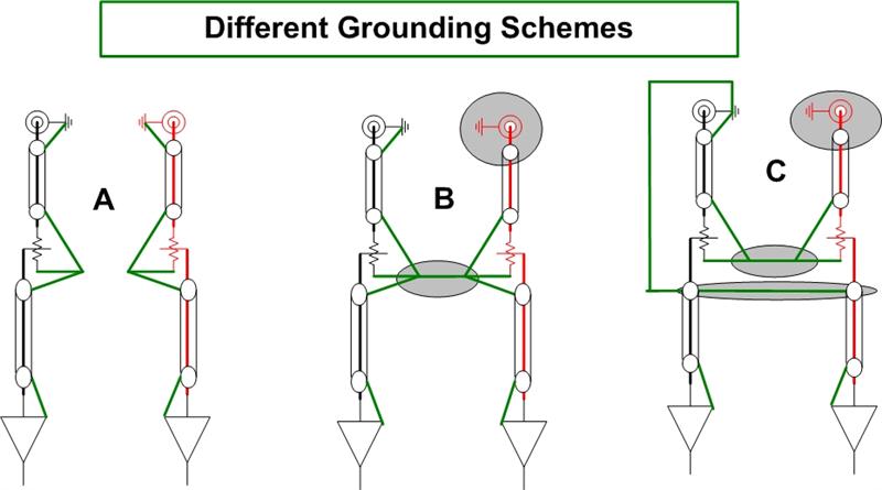

"On the boards the conductor (hot) goes to the input cap and the shield goes to the signal ground input. You are suggesting to experiment with cutting the latter?"
Yep.
And wait, you have only one channel ground connected to the pot? Do you have the pot grnd connected to both amps inputs?
The pot is stereo. It has 2 sets of 3 connectors. I use one for left and one for right. Both have their own ground. Ground in and ground out (so to speak) connect to the same stub on the pot. The wiper is hot to the amp and the other side of the pot is hot from the input. Repeat on a separate set of 3 stubs for the right channel.

Here is a few different ground schemes to try and see which one helps the noise the most.
A = most common, standard connections.
B = first attempt at fixing a source ground loop / noise issue.
C = is slightly more entailed, but is creates a "star" ground for all audio signals back at the SINGLE point of entry.
