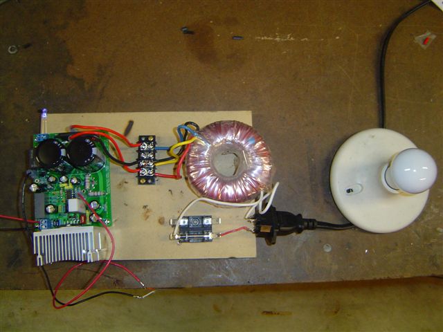

Well, it's still a work in progress and I'm waiting other caps to test.
So far my list of positions suitable for upgraded parts is:
C21:
Swap AVX BQ with Wima MKS2/MKP2 (100 to 220 nF) (perfect fit)
Cleans-up highs, better soundstage and basses
Great reward, low cost (15 Eurocents ea)
C9:
Swap Panasonic FM with Elna Silmic II 220uF 35V (greater voltage rating are OK but more difficult to mount)
Sound has more body, everything is bigger (soundstage, reverb) bass is deeper and more controlled.
Great reward and reasonable cost (94 Eurocents ea)
C17, C18:
Swap with 100 nF X7R ceramics (AVX SkyCap) or better pull them out. (perfect fit)
More reverb, soundstage is bigger, dynamic is slightly increased
low cost, subtle but clearly audible improvement (18 Eurocents ea)
C19, C20:
Dynamic is increased, sound seems more 'free'
low cost, clearly audible improvement (18 Eurocents ea)
C13:
Swap with a better one.
Together with C9/C21 this is the most rewarding swap but the ideal cap is yet to be determined.
Some better caps tried by me and/or others:
Low cost: Evox-Rifa PHE426 (87 Eurocents ea)
Mid cost: AudioCap Theta, Obbligato premium aluminum (ca 12$ ea)
High Cost: Mundorf SIO (ca 31 Euros ea)
High reward and ???? cost
C1, C2:
Yet to try
C30:
Yet to try
I used a Wima FKP2 and I suspect that is a nice improvement.
When I'll mount sockets for C1, C2 I'll try too the one in kit.
C6, C11:
Swap Panasonic FMs with Elna Silmics II 100 uF 35V (perfect fit)
Dynamic is increased, bass is even better, thicker and more articulated, sound is slightly warmer and has more body.
if you do prefer a more analytic sound probably you would keep FMs
Great reward and reasonable cost (74 Eurocents ea)
Silmics require an initial burn-in of 20-40 hours
This list is preliminary and subject to change as others caps are tested
So far the C9/C21 caps choice seems to be final.

Rereading my post I've noticed that it seems that difference swapping C6, C11 is not so big or important.
Actually difference is quite big:
- sound is slightly warmer but fully detailed and open
- there's little or no harshness
- soundstage is bigger and deeper
- bass gains authority, is even deeper, thicker and more articulated
- dynamic is slightly increased
- sound is not 'thin' it has 'flesh', body, texture
These considerations apply after an initial burn-in of 20-40 hours, at first they sound horribly

ClaveFremen said:Just tried PHE426 bypassed with:
MKP1837: soundstage is not as deep than without
MKS2: subtle but clearly audible improvement, soundstage a little better, bass is a bit tighter, cleans-up highs a bit too
BQ: subtle improvement, Wimas are a lot better.

Tom,
I've just finished a listening session swapping C9 with and without C21.
Without C21 (no bypass):
- both Panasonic FMs and Silmics II have quite the same tonal balance
- all differences previously stated between them remain valid but are more subtle
When you insert MKS2 in C21 a slight coloration becomes evident in the midrange, sound is slightly warmer, soundstage seems bigger, bass is tighter and overall cleans-up things.
I've tried also MKP1837 and no coloration is evident, tonal balance is quite identical, bass is tighter and overall cleans-up things.
Last time I've tried MKP1837 I was too severe... probably because I was seducted by the warmer MKS2
So about coloration I think I found the culprit but I can't hear the strange effect on voices you described, just a tonal difference

Tom,
it could be that I've identified what you hear.
In my setup is subtle but clearly audible...
It's like female voices are somewhat more distant, less focused, isn't it?
Well, both Silmics and MKS2 give that same effect!
Swapping MKS2 with an MKP1837 this Silmics' effect is quite well mitigated, IMHO.
I would suggest you to try this first.
I'll keep MKP1837 mounted so they burn-in.
