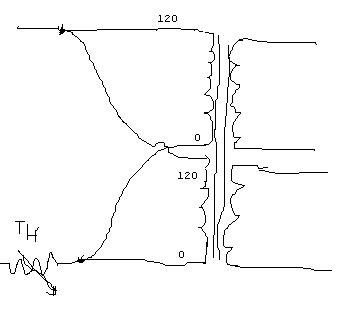

what does the .0033uf line cap do? Is it necessary? Can just one thermistor be used like this? (see attachment [sorry for the ghetto MS Paint schematic])
btw, .0033uf is 3300pf or 3.3nf (not 33pf)
Can't he just put the thermistor in series with one end of the primary?nenne said:but having a single 230V winding, it don't come that easy and handy. RevC is not a class A driven amp so I suppose it can not be implemented.
anyone?
