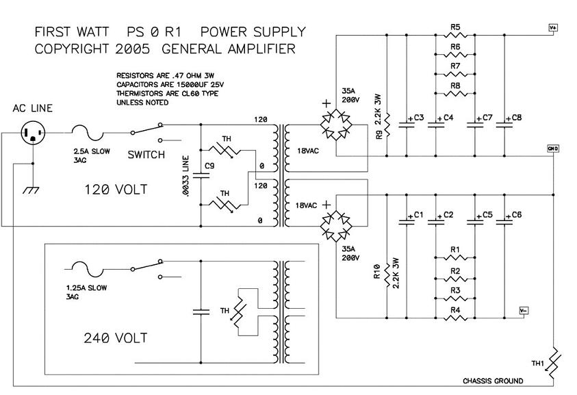

Now I have tried T3.15 A to but they get blown away too, if kits is connected directly to mains. The bigger core has an impact on the inrush current because of the time it takes fore the winding to load the core and this being bigger 120x65 instead of 120x55 maybe a bit of the problem. I' m not 100% on this being a hobbyist, so if some guru could brighten up the area on this question it would be appreciated.
Kits play ok now, and hardly warms the heatsink s, so it's about how much I can spend on fuses This is with a 40watt lightbulb in series with the mains.
I'll by some 4 A and even 5A to for testing, see how that works.

pinkfloyd4ever said:I believe people told me to put a CL60 thermistor in series with the primaries...would that help here with nenne's fuse problem?
Yes in deed...
fuse the primary to stop the transformer/rectifier/smoothing bank setting fire to the house.
fuse the secondary AFTER the smoothing bank to prevent the rest of the downstream circuit setting fire to the house.
If either of these fuses are too big, then the protection they offer is weakened.
Power Resistors and/or Power Thermistors come to our aid.
Here is how to use that CL60 or THOSE CL60 depending how many
This is a Nelson Pass power supply and is really more suitable for Class A so dont go trying to use it on your MyRef, but the way the thermistor and 33pf cap is wired can be beneficial and used in your supply.
