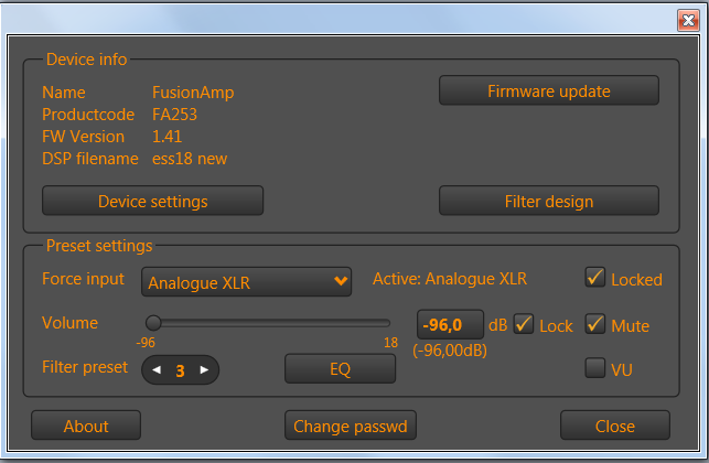

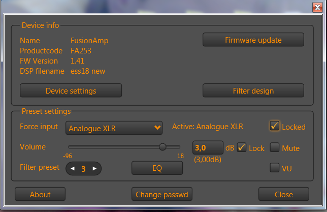

Hi guys
I have some strange problem with Fusion 253. When is in slave mode, after switching off/on, it is going mute (- 96) even if volume is locked at +3 dB.
On first picture is device setting before switch off and on second when switched on again
