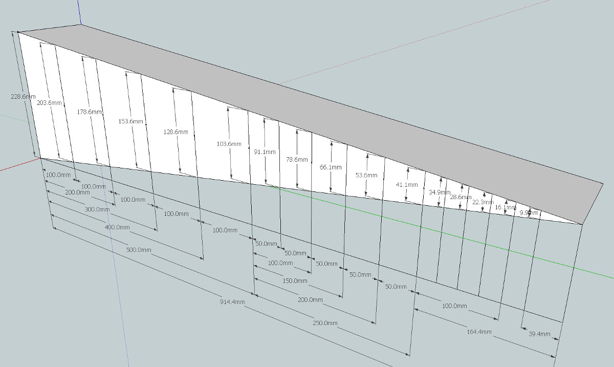

Tonight, I've had the pleasure of sitting down and doing the first drawing of the spiral on paper. Using the 5"x9" baffle and 36" length for the TL, I put together a SketchUp to help with measurements...
Doing a direct translation of these measures to paper makes for a larger enclosure, roughly 12" x 16". X, I'll use your drawings for the FC build, but use these for the MDF build.
Spiral still looks amazing and very close to the SketchUp drawings done so far. It just looses ~45° of spiral at the thin end, and the expansion of the chamber mimics the triangle shape.

You know, the length and exact geometry of that spiral is not all that important - just approximate is good enough because the purpose is for it to gradually taper and absorb that back wave. The overall volume to provide sufficient bass extension or cone excursion control is probably more important. If you want to maintain overall envelope dimensions first then do that and force the spiral to conform. That is what I did. I defined the envelope the hand sketched the spiral and it just all worked out. But my sims confirm that 3 or 5 inches longer or shorter is no big deal. Do what is easy and looks good. Check the volume to match the Vb you want for an equivalent sealed alignment.
The dagger you drew looks good btw. Someone should try it to see how it sounds. Probably just as good.
Think I've got it now... So if I need a Vb of 5L or 6.4L for a specific driver, I just decrease/increase the envelope size and squeeze in the spiral so its volume matches the required Vb... Your 5"x9"x12" gives a Vb of ~5.4L (?) compared to 13.3L for the dagger [(5"x9"x36")/ 2]...

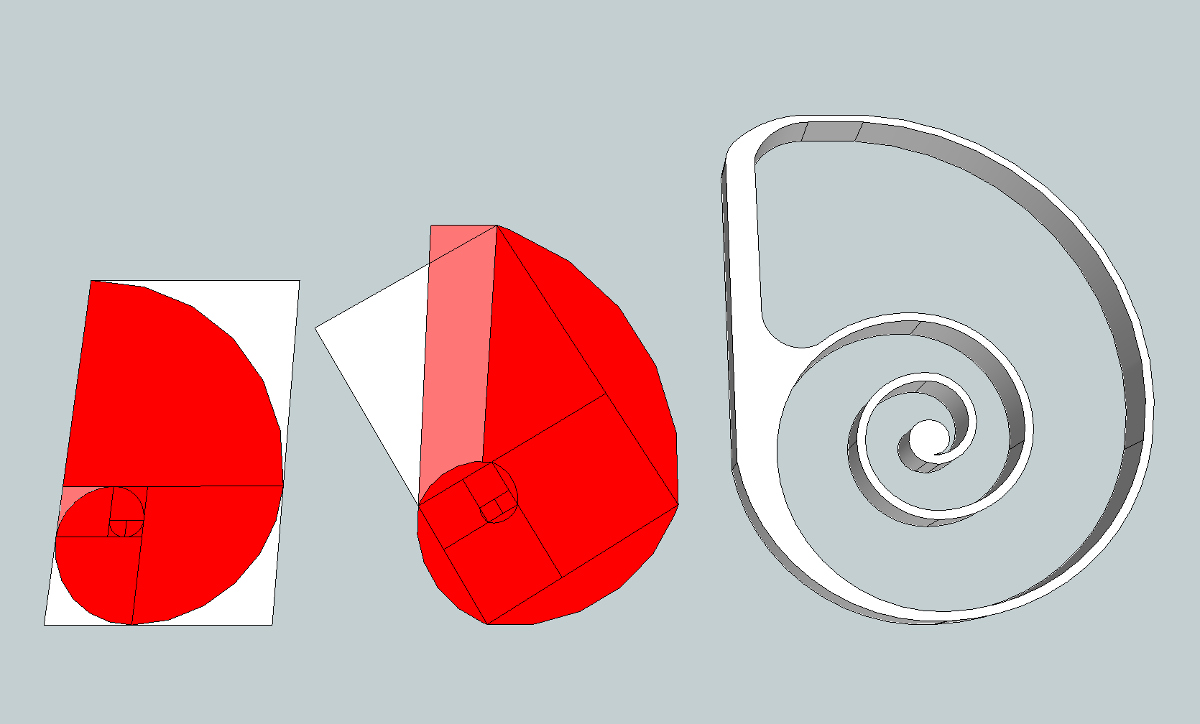

Ouch... sorry X, I meant the path of the spiral resembles a Golden Ratio spiral. The outer wall certainly does, but to get the required length of pathway squeezed into the envelope calls for tighter internal curves than GR spiral gives.
Translating the dagger shape into a spiral hits the GR bang-on. I'll take a few photo's of the curves I've drawn and compare them with the required spiral pathway for the Nautaloss.
Looking ahead, an outer curve generated by utilising the GR would give a real smooth outer line, then free licence on the inner spiral to get the pathway in. My FC and Faital Pro 4FE32's have arrived at my parents and I'll go collect them in the morning :)

Yes, the Fibonacci spiral, I really should try a little harder with my descriptions... Doing a SketchUp comparison is much easier :)
