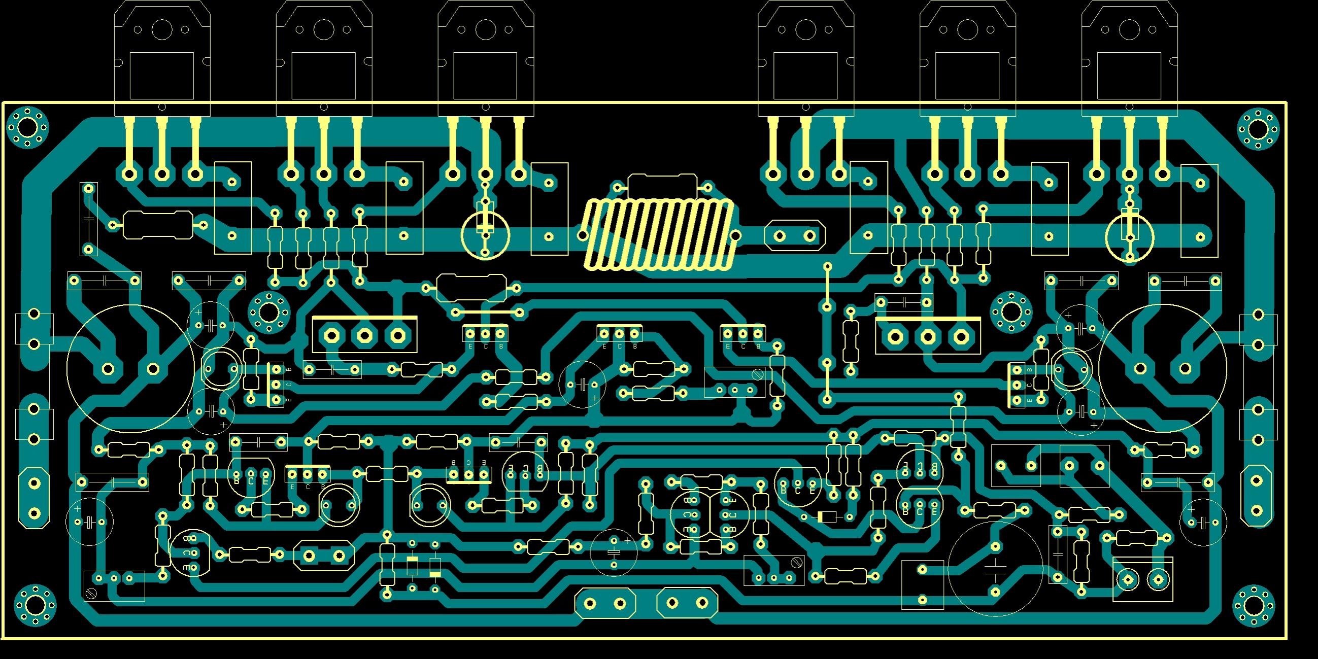

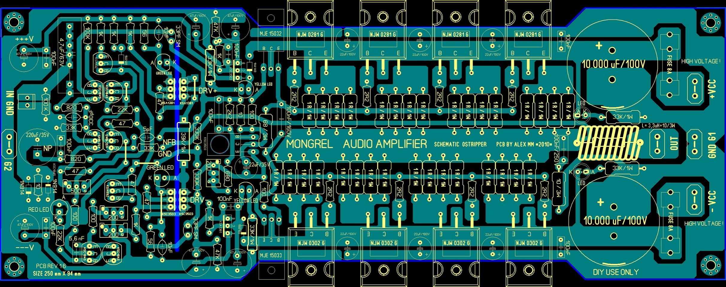

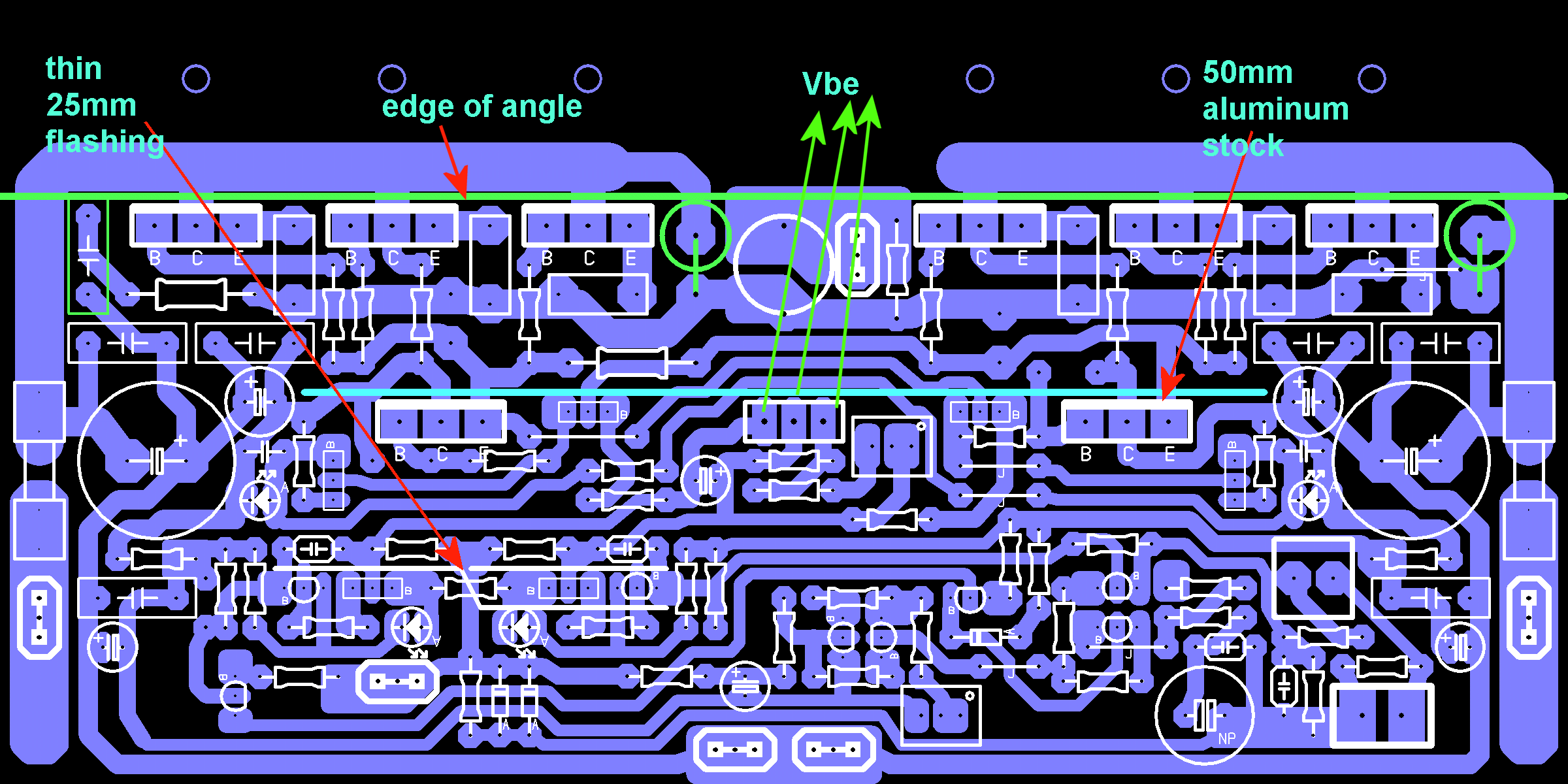

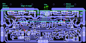

Both those are a sight to see , Alex. I will admit , as I follow Cordell - technically , your layout skills are to be saluted. Really !
My only "issue" is fatter pads. The reason is - not all will go to the board house and may decide to break out the etchant and go to it ourselves. Some board house FR-4 is also more prone to pad separation ,as well.
To comment on the "long board" - you did not use the to-92's on the VAS. This will also work thermally and electrically. BD135/136 low Vceo pair is actually preferred to the KSA/C. Same for the diamond pair in the OP , they also only see a couple Volts C-E , one of the advantages Cordell points out in "the book" .I am confused by exactly what circuit you used on the long board , it looks like a "different triple". keep in mind that Cordell's DBT needs the driver /pre separate and in thermal contact to accomplish the Vbe cancellation.
Go with my above LX to the letter (couple pre/driver - separate PCB HS) and it will excel in real life.
PS - on "my board" the center Vbe is a cable that goes to the MAIN heatsink , not to the "DBT" PCB driver heatsink (notice the different pads).

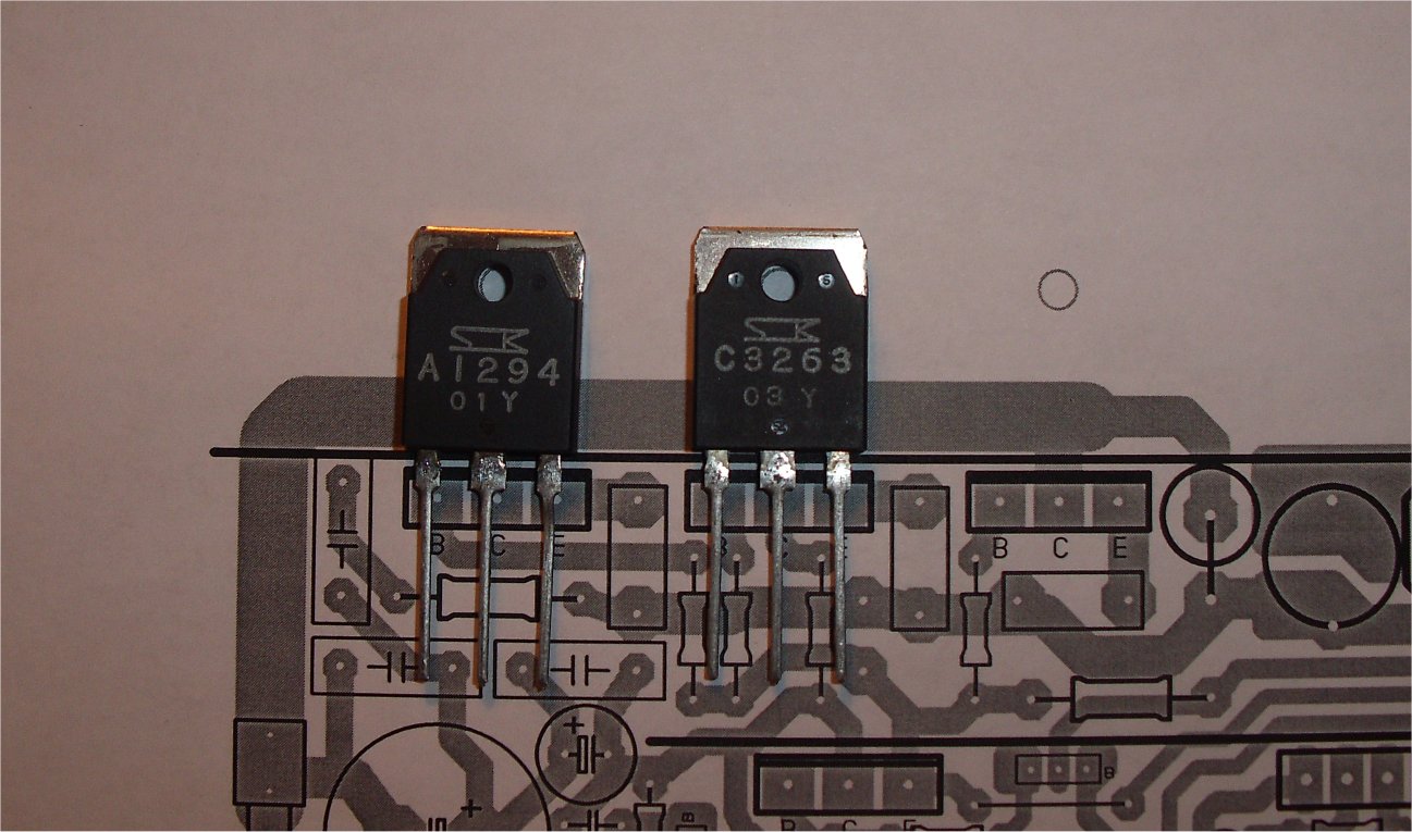

For Alex MM ...
Look at (below 1) , I think it is self- explanatory. (below 2) are the actual TO-3p's over the printed output. The aluminum L will be 35 - 45mm , 25mm of the board goes under the aluminum , devices mount on top. TO-247's might need the OP device mounting holes further away from the line by 3mm.
This board would go on this - Conrad Heatsinks - Products
MF-20 /30 or similar.
For the "long board" , it's only purpose is for a massive power stage (6 pair OP - 300/8R - 500/4R).
Those who would go for a 300W/500w amp would have a 125 X 300mm conrad heatsink Conrad Heatsinks - Products
or similar.
PCB can be 275 X 75 or 100mm in this case. Being flat mounted , with a 100mm high unit, the Op devices would have to be FULLY under the PCB. Your layout would still work with the 150mm heatsink height.
Just keep in mind to leave room for a decent extruded heatsink for the - PCB mounted/separate - driver/ predriver thermal setup. Something like a 85 X 50 X 12mm extruded heatsink
http://www.mmmetals.com/extrusions/drawings/MM34400.JPG.
These are the real world , available , most adequate (C/W wise) solutions for these amps. To offer both PCB's would allow for any case/layout to be used.

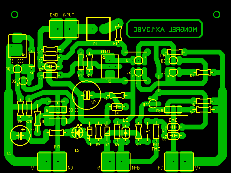

I'll post the boards I'm using now tonight (here). The AX1.3BNC... They have lead compensation , TMC/CMC/TPC options .. simple 4 device input stage (no cascode).
PS - the DIYA "board store" PCB's will be pro + screenprinting and they have a few more stability "tricks" incorporated.

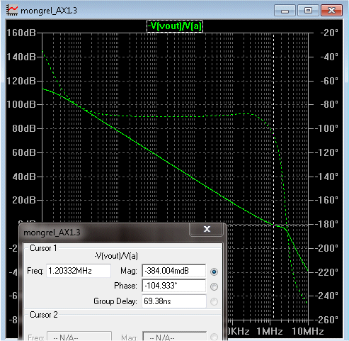

There we go , That's what you DID ! (below 1) is what a gain of 20 will do , unity gain point is 1.2 mhz (should be 570khz) and phase at that point is falling past a safe margin. I would say this amp is "on the edge" (near oscillation).
You could increase the 2 input pair degeneration resistors to 180-220R and up the negative feed back resistor to 22K (gain of @ 25). This will bring you back to 370-400K unity gain crossover with >90 degrees margin. (stable again - below 2)
Wuyit - duhhhh - don't speak before you know , he screwed up the loop gain by changing the design - I re-compensated it for him. This can happen to ANY amp - TMC is less tolerant of insufficient phase margin than CMC (standard miller).
PS - A better way to reduce gain would of been to attenuate at the input and keep the design unchanged.
FIXED!!

Here is the closest approximation of the AX (with cascode) , which is the same as the new DIYA amp. Just DL LT - Linear Technology - Design Simulation and Device Models
Make sure the 2 files in the attached .zip are in the same folder ,click simulate.
OS

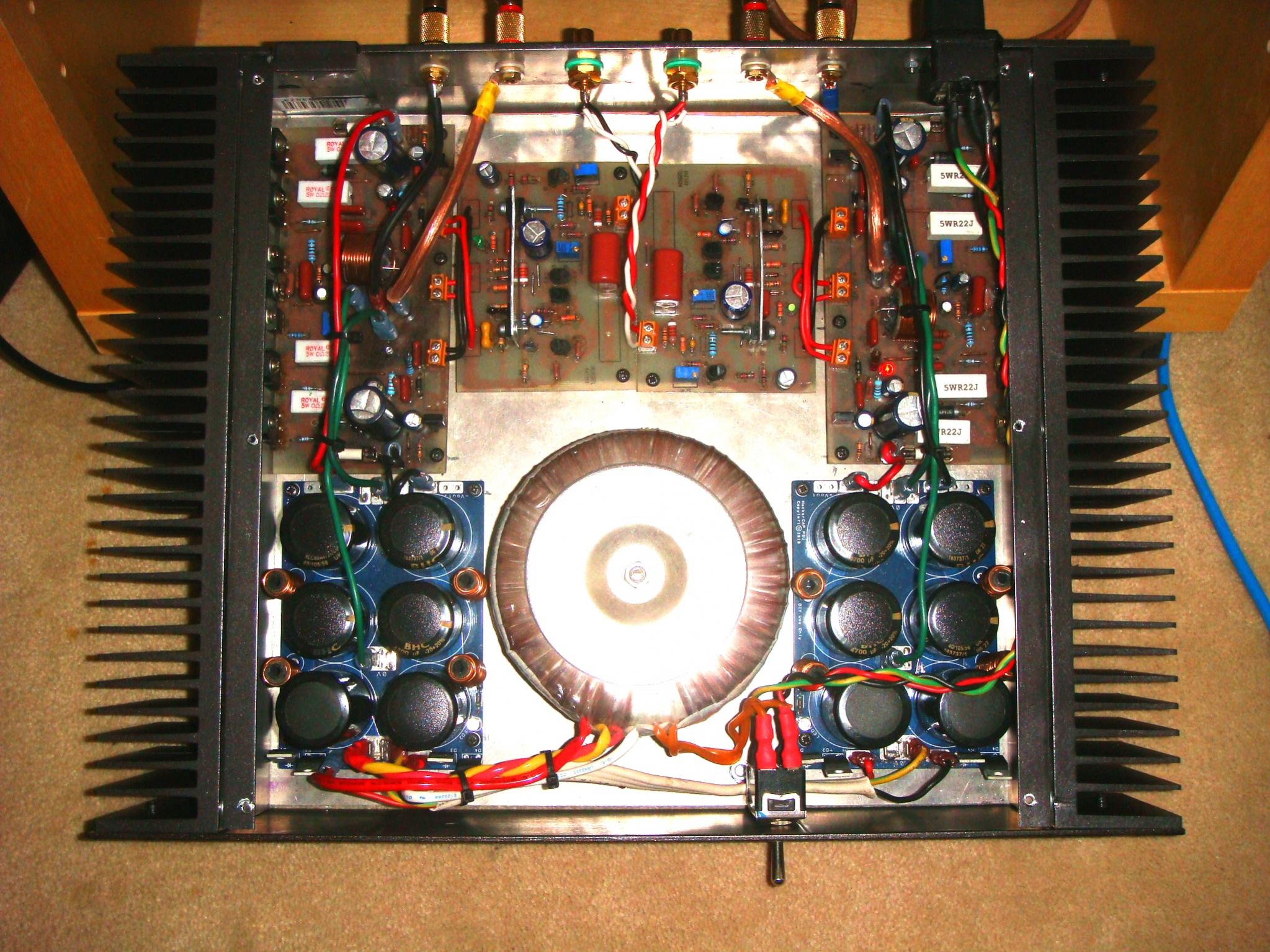

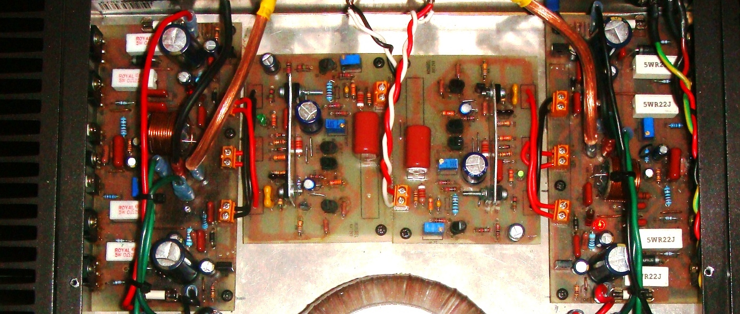

Put the lid on, I'm done
I can finally put the lid on my Mongrel.
It is now complete with all parts as per BOM.
I managed to get trustworthy transistors from Mouser with free postage courtesy of a generous member on stereo.net.au who did a large order down under.
The difference after rebuilding the AX boards is not small, I now know why people say not to trust eBay for semi's.
I have used Panasonic polyprops throughout and FC's for the lytics.
I am running a single 300VA traffo with 60v rails and 6 x 4700uF caps per channel.
Thanks OS for such a nicely designed amp, the sound is brilliant.
Pete.
