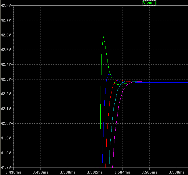

I was messing with square waves this morning and had left in a .step comand with stepped values of the front end degeneration resistors. The .step starts at 20 and goes to 100. Note the effect on speed and overshoot. Also note the lack of ringing. Just thought it was interesting enough to share.
Ken
Ken
Front end degen. resistor changes will lower or raise the unity gain point of the amp , therefore also affecting phase margin. Similar .step results would also be seen from .step CDOM 20 100 20 ,where the main miller cap was replaced by {CDOM} . This is useful when you just have a 47pF cap , for instance .. but have designed for a 68pF. Then you just increase LTP emitter degen. to compensate , resulting in the exact same UG/phase margin. :)
A direct result of lowering/raising UG is varying degrees of overshoot on the leading edge of a square wave.

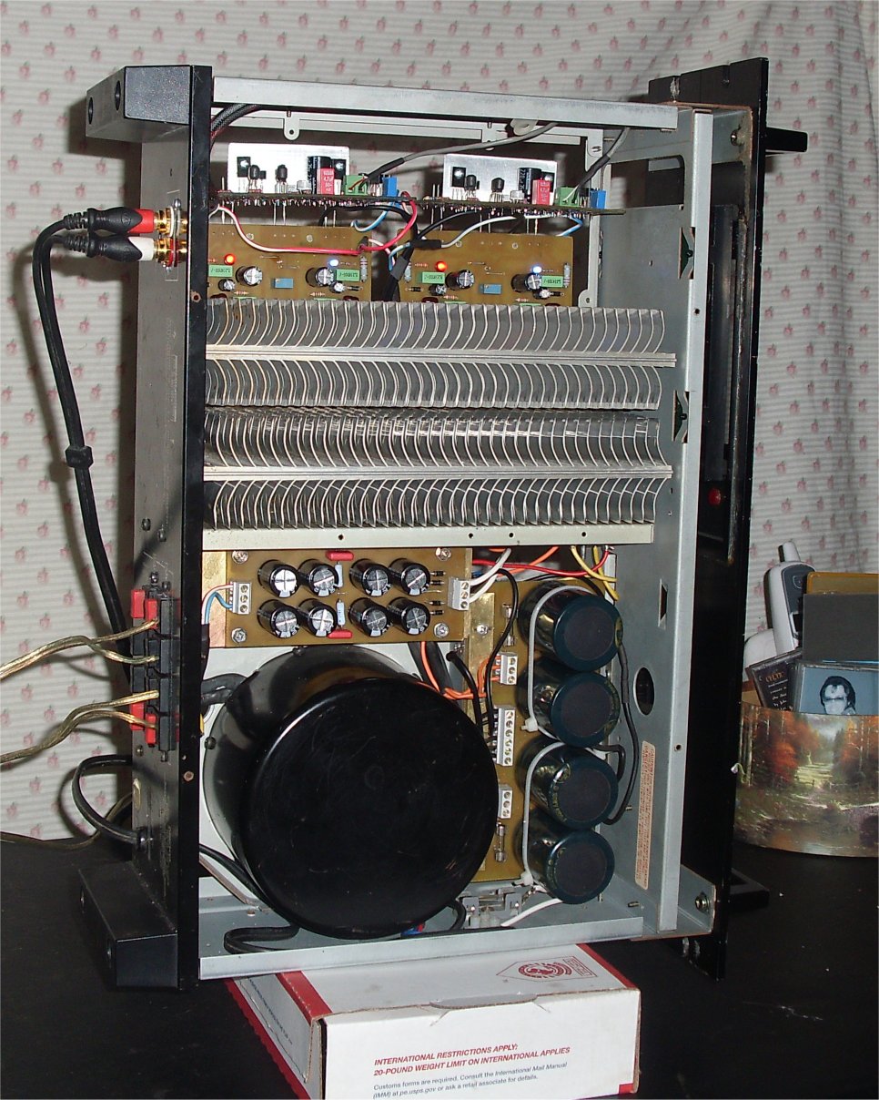

I'm listening !!
( below 1)... means "you know watt" :D (REAL NICE "firstwatt" )
Jumping up to the 68-60-0-60-68V supplies made my offset go to 5mV

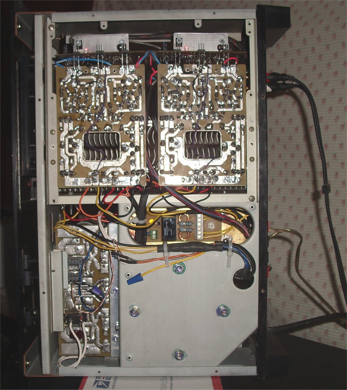

(Boo-Hoo :eek: ) . The wiring (below 2 ) is a "cobjob" by my standards , need a mouser order. Looks nice on top (below 3).
Listening , NO thump , dead silent (even with 330R/headphones). Boston,Floyd and SAGA FLAC's are being used for critical listening. high end detail is flawless , bass is better than the last AX. Vocals are "right in your face". Sonically , it is about what I expected (totally transparent).
I'll let my daughter listen to her " Classical Thunder" tomorrow. Too late to go "nuclear".

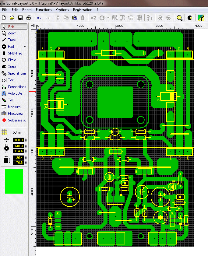

ONE FATAL FLAW :eek: :(:( having the drivers on just one of the heatsinks makes the front heatsink bias harder than the back one (the one without the drivers). I will etch 2 more boards with the drivers on a brass plate in front of the outputs.
Amp will thermally stabilize , but with the front OP's biased twice the rears :eek: . Drivers are adding to the Vbe.
The boards are almost redesigned (below 1) same circuit (IT'S PERFECT) ,just an anal "thermal issue". Another chapter in R/D. :eek:
