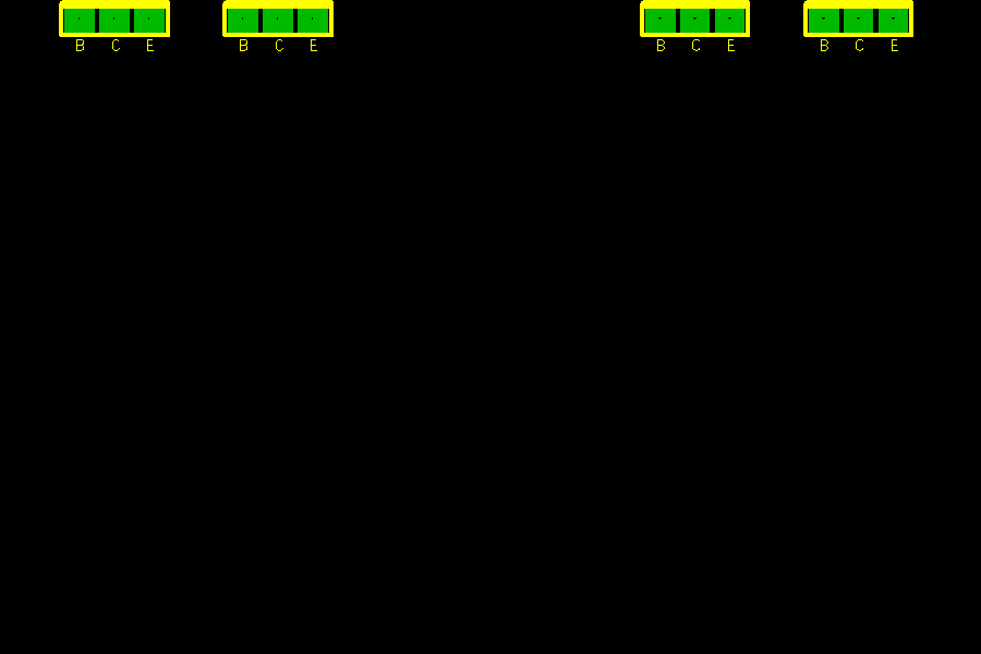

(Picture 1) The flat opposed layout. It does work quite well on my PB250 , allows direct thermal contact , lends itself well to a good NFB takeoff and general circuit symmetry. The rails can be run close together to cancel current pulses and is the nicest looking (subjective opinion). I have seen this on the genesis and many other esoteric amps , it's only drawback is that you need a tall heatsink 125mm (5") this style would be hard to implement on a 2U setup.
(picture 2 ) Flat aluminum angle mounting. Very common here at DIYA. The oblivious drawback is the additional thermal interface of the aluminum angle. It also requires that you source said angle. It does look nice and is easy to layout and service. With my proposed 100 X 150mm boards you would lose 200mm of interior chassis space which just might leave you with 200+ mm in the center to mount your power supply components.
PS ... you ALSO could mount the angle/amp ABOVE the power supply components , freeing up space in the chassis center ! I personally do not like this method because of the thermal issue , but this would be minimal. some heatsinks have the Extrusion for this layout method , but are expensive.
(picture 3) Edge mounted layout. This is nice for low profile cases , it still takes up that 200mm of chassis space but a 4-600VA http://www.antekinc.com/pdf/AN-6440.pdf or this :
Antek - AS-4440 will work out well.
This layout also allows direct thermal OPS contact and can be laid out impeccably.

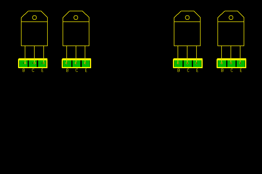

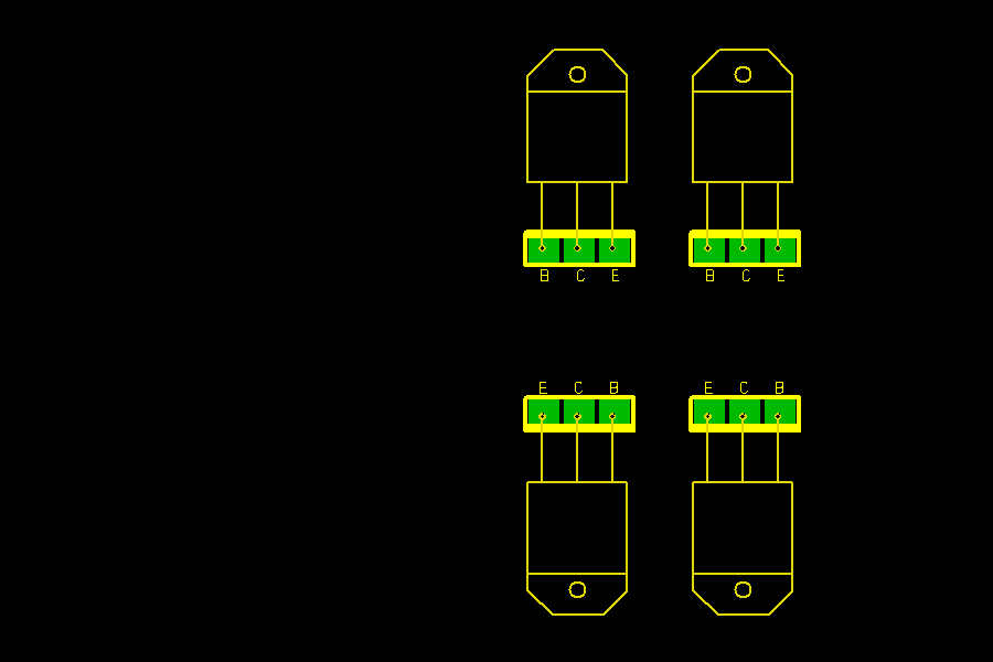

Something like this, of course directly to heatsink, no bracket.
Littlefish ... good amp. That is design 2 (pix2- above , my last post) , flatly mounted without the L bracket would be better . In that case , design 1 (flat opposed) would be preferable. You could layout the rails and star ground better with "opposed" as well. Of course , one could implement any of the 3 layouts into any case with a little imagination. Thanks for feedback.
OS
half way downSomething like this, of course directly to heatsink, no bracket.
Don't do it like the diagram.The PCB is designed with all the power transistors mounted underneath. Bolts pass through the PCB, then the transistors, then into a heatsink, as shown in the diagram:
The FETs are mounted too far away from the heatsink.
The angle should be turned the other way with the leg pointing to the opposite side of the FETs.
The PCB does not need to overhang the FETs.
The Fets can be moved until they almost touch the heatsink.
The angle mounting face can be machined/ground/filed/polished for good/best heat transfer.
When the FETs are mounted on the same side as the angle leg, you lose all these advantages.

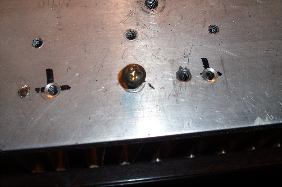

One very convenient advantage of the angle bracket is the ability to use through bolts and nuts to mount the outputs, as opposed to drilling and tapping. Most here seem to ignore this though and still run the risk of breaking off taps doing it the 'right' way.
I use course sheet metal screws that cut their own thread in the right size hole.
The opposed layout can be more compact if the board overhangs the devices and has the majority of the trace routing (that would normally be in the middle). Potentially have a board 2" tall.

someone recently posted a compact, opposed layout that did exactly that.The opposed layout can be more compact if the board overhangs the devices and has the majority of the trace routing (that would normally be in the middle). Potentially have a board 2" tall.
Anybody got a better memory than me and could provide a link?
100*150 is too big for me. That's almost as wide as the Leach clones which are enormous @ 107 wide.

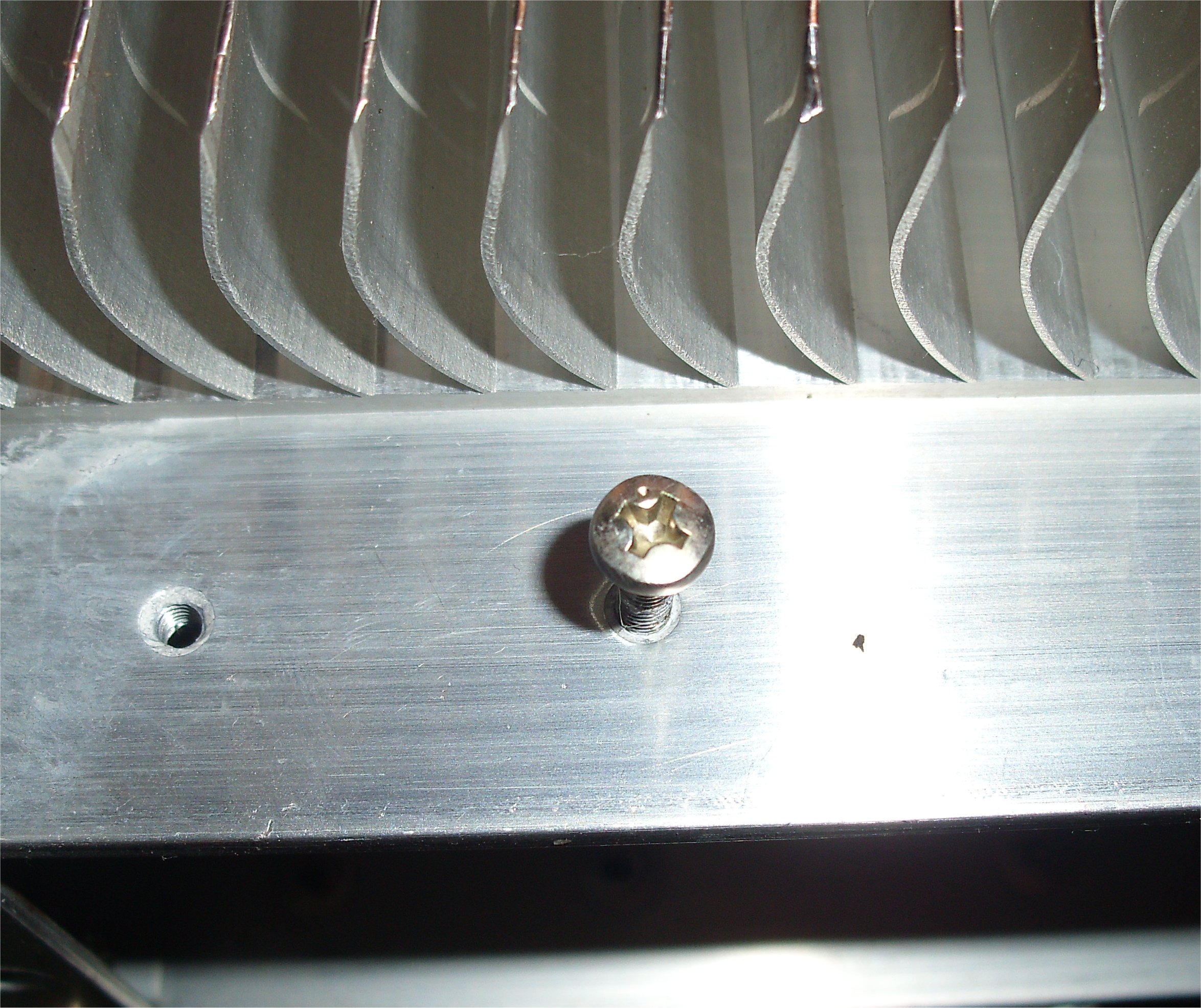

or is it the gaps between the fins that are to be used for through bolting?I allways design my pcb to align with the fins of the heatsink,
This only works if you can machine a spotface large enough to accommodate the bolt head and/or nut between or into the flanks of the fins.
OK, my mistake: aligned with the gaps between the fins. I use M3 imbus screw, which are small enough for most of the heatsink. You can se one of my amplifier in the "Post your solid state picture" topic.

Mounting devides directly to the heatsink is the way to go. Tapping is no problem at all and like you I have never broken a tap.

With your heatsinks, "fishing" the screws through the fins would be no problem , but not everybody has YOUR heatsinks. What if the fins were spaced different ?? A "tappin'" you would have to do !

You have some space to move the output devices, say 8-10mm is possible, due the lenght of the legs. So this design can adopt for another heatsink.
I like this arrangement, because it takes less space from the box.

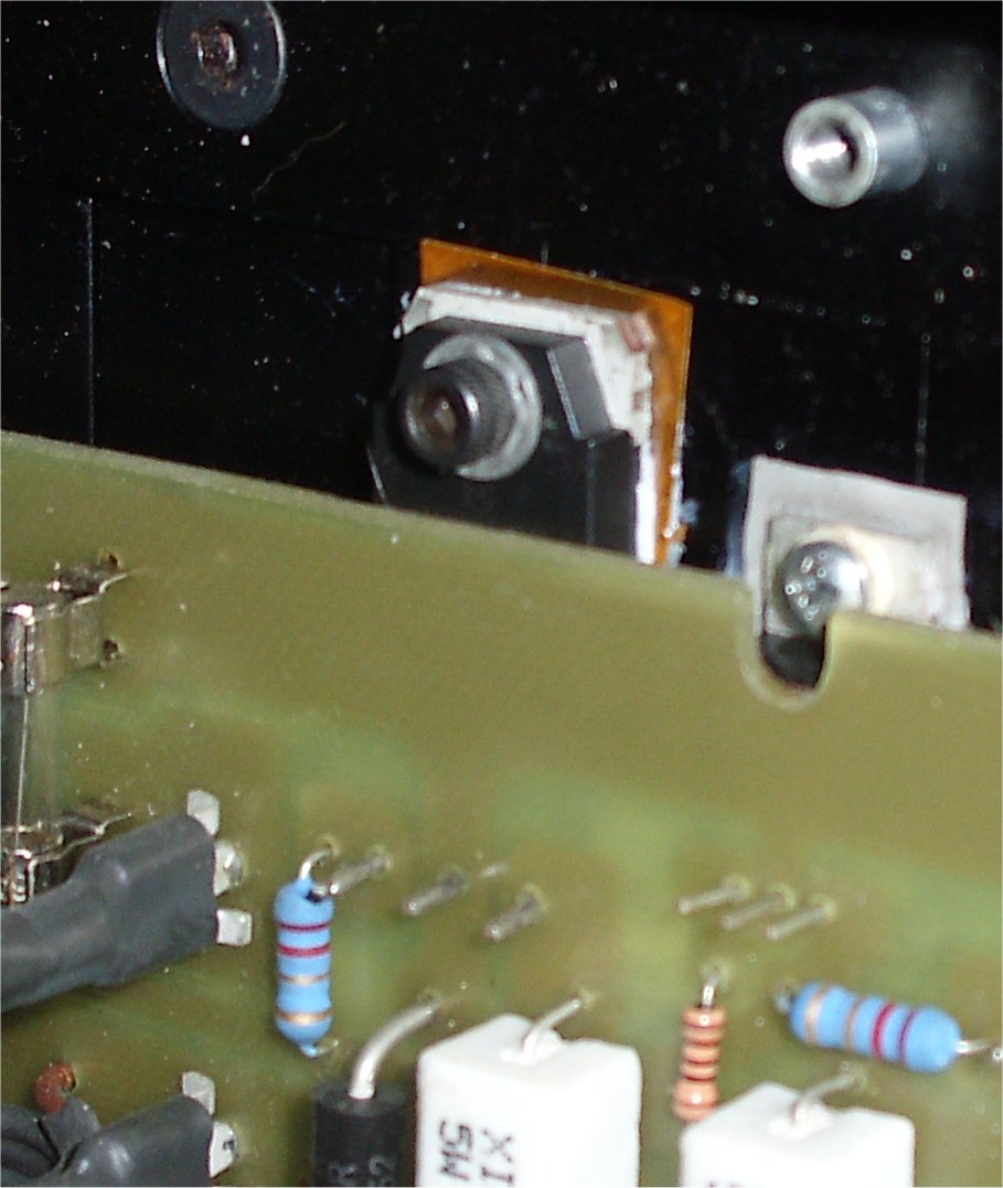

I'm not particularly attached to anything (just ask my ex's ). I would only use the most practical or convenient way. In my 6 channel, it made the most sense to use the angles, as the heatsinks were made up of pieces.
Taps should have no place in our world, not when you can buy thread cutting screws from places like McMaster Carr. 100 stainless steel tapping screws for the cost of one tap? A no-brainer.
TAP HATERS UNITE !! I guess idiots don't either ( I am not referring to you).
Self- tapping , nuts/bolts through angle , or "anal" 4-40/6-32 tap action , whatever gets it done !
PS ..to-220's with their insulated thin-walled "shoulder" washers might have a issue with self tapping screws.
