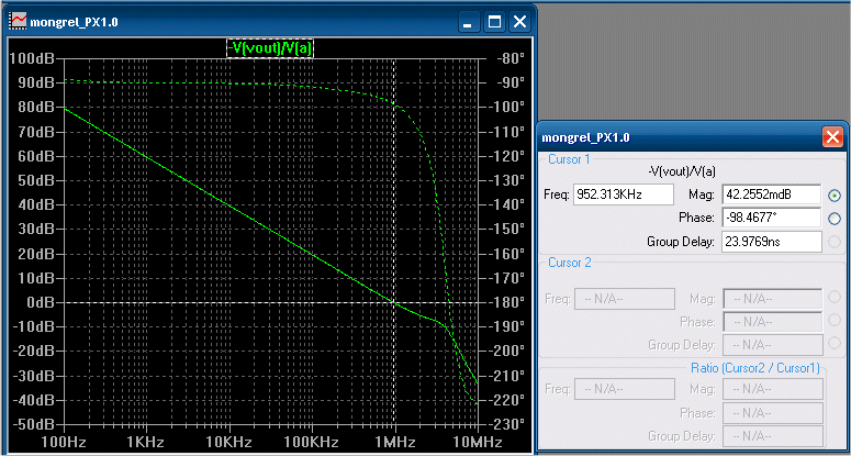

I might ditch those diodes ... with them I had to use lead compensation to pull the phase up at unity gain. Without them I had a big bump at my UG point. remove the lead comp... perfect phase at 950khz without 4 more components. I like that!! (pix1 - no diodes-820R / pix 2 - remove C5)

I have done lots of simulations with this type of compensation. Here is my approach:
1: Make phase lead 5pF default (or whatever you prefer)
2: Make C103 10uF.
3: Adjust R115 for best phase margin/stability.
4: Decrease C103 until phase margin begins to worsen, back off until satisifed.
5: Change phase lead cap if the results do not satisfy.
6: If desired, repeat 3 and 4 to tweak OL BW, until OLUG is under the "phase hump". However, this may have negative effects on stability into capacitive loads.
This way, I don't believe it is necessary to change the phase lead comp, and I like to keep it low (say 5pF) to avoid excessive phase shift at 100KHz (but that's just me).

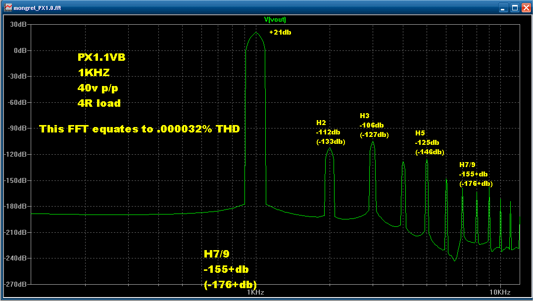

I used KT's tricks to get my -180DB noise floor and I'm glad I did.
Below plots are so far beyond the blameless or it's UDL clone that Wahib MUST simulate this one. .000032% and -150 H5/7/9 (or better at 1K) ...what the heck!! The only bad thing is that H3 is dominant as compared to H2.
Gonna build this one.. HAVE to!!
OS
OS
OS, many popular amps have the dominant H3 characteristic. In LTP amps anyways, the dominant H2 criteria can be difficult because H2 will dodge around depending sheerly on the Hfe variance of the outputs, matching of dual VAS (singleton VAS eliminates this mechanism, albeit at some expense), etc. For consistently dominant H2 there needs to be a non-symmetrical stage somewhere.

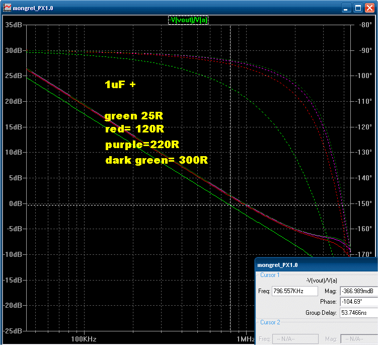

WHAT is that you said... steps are nice ..see cause and effect. Did what you said... used a grossly big 1uF for the cap and stepped from 22 to 500R .The "effect" diminished after 330R. "the effect" is a increase of the UGP along with increasing phase margin as the resistor value is increased with diminishing returns after 300R , at least with a 1uF cap. (Below)That's fine, I'm used to the babylonian method.
- keantoken
OS
Something else is compensating the amp so that the RC comp network plays minimal role.
If it were not, I believe you would see the best specs at 5-10R.
Try removing C9 in your previous schematic (attached for convenience). This may seem counter-intuitive, but I believe you will get higher OLUG point this way, along with increased OL BW. Plus, you will be using compensation updated to your actual design.

It will do a bode plot without C9 , but will oscillate or give "timestep too small" errors without it in a standard signal test.

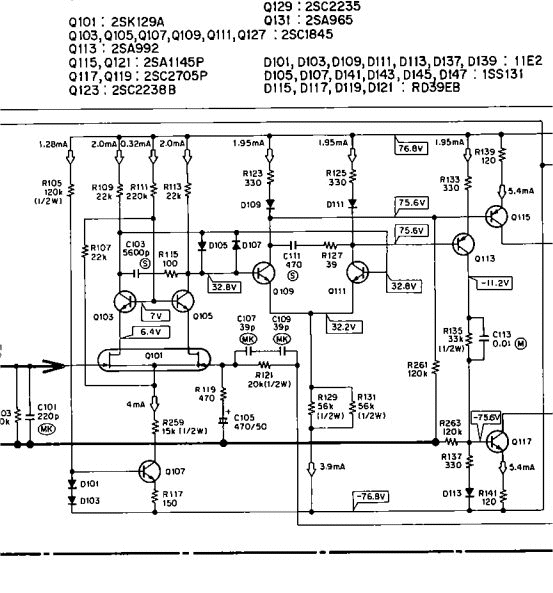

Pioneer uses 2 39pF caps in series in a obscene lead comp arrangement. i might also try to lower the amount of GNFB by using the 22k/470 ratio to set the overall gain.

I tried the shunt compensation , both symmetrical and one sided - to ground (like roenders folded cascode amp) no go.. I DID get your 1 or 10 uf + 10-100R R/C combo to take over the com.p to make the amp stable. what that did was increase the distortion to .01% versus .000008% for the values in the PX schema , even after adjusting for optimal Vbias and voltage amp current.
It still "befuddles" me what is really happening here.
pioneer must of had a "guru" on hand for this one.
